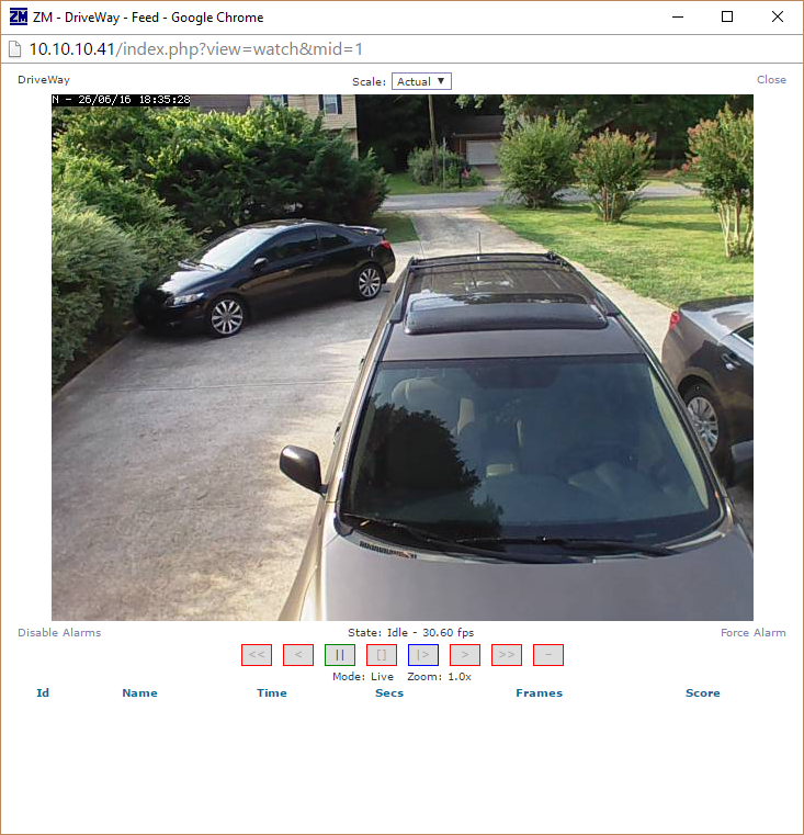

@Joshua Parker Ruehlig @Cesaric
Just went through the steps installing with
pkg install zoneminder nginx mysql56-server php70-pdo_mysql php70-gd fcgiwrap php70-
session
and didn't have to make any changes on any config file name or location. Zoneminder started and runs fine:
Thoughts?
  • Zoneminder FreeBSD installation 1.02.pdf
