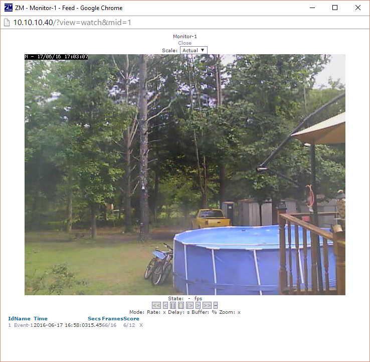

ZM running and CSS problem fixed. Thank you Abi!
Cameras are still not working, but are next on the list. Any volunteers?

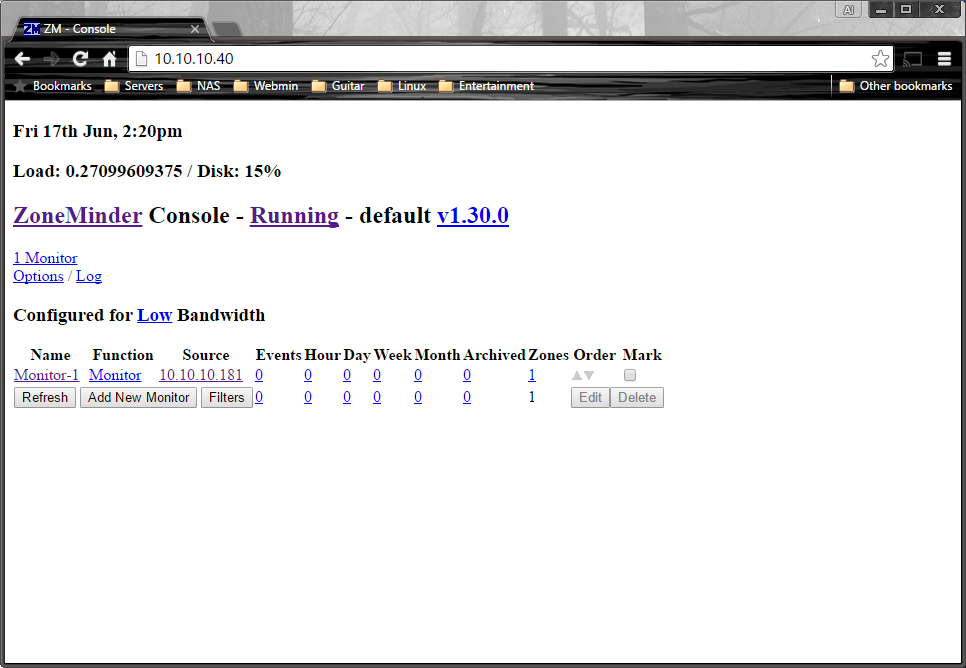

I've got it working in a vanilla FreeNAS 9.10 jail. I started from scratch, but encountered lots of issues.
Next step: start again (from another brand new jail). To be sure that the guide works.

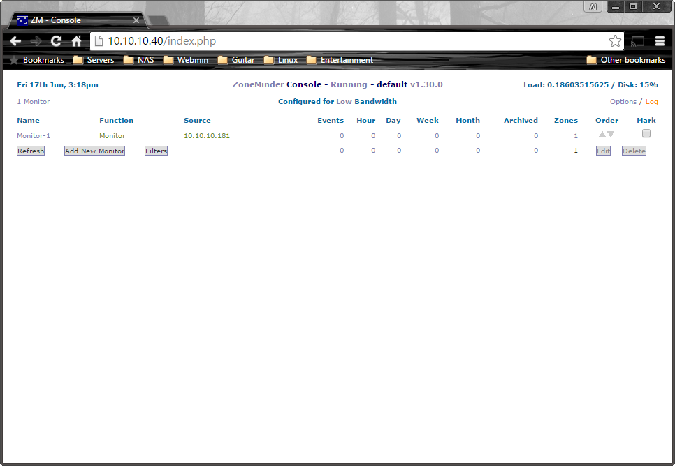

PHP 7.0 is overall a good iteration of PHP, with all the retro-compatability you could expect. So, if nothing breaks (I have no complaint so far), you can go with it.
I also installed ZM 1.30: I will test it out for a few days to see if there are issues with it. But it's strange: I pulled the 1.30 version from pkg, whereas you got the 1.25...
