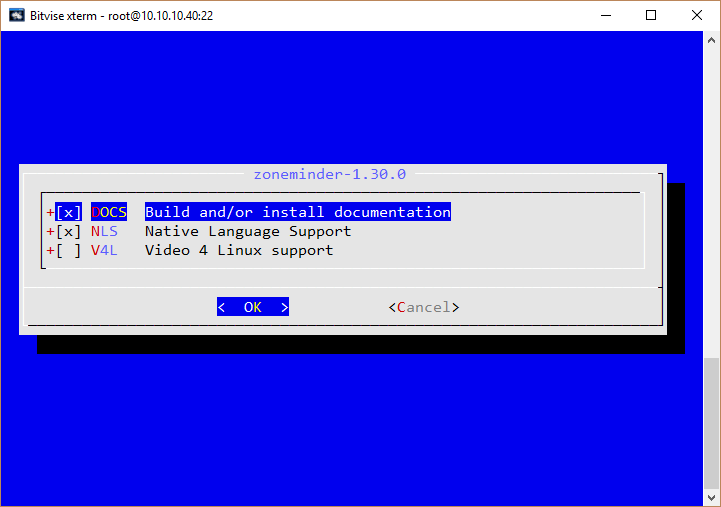

Joshua Parker Ruehlig
Dec 5, 2011
5,949
That's is going beyond what I know who to do at this point, so if someone want's to continue the write-up I can send the doc, instead of the pdf. I do have it running on my ubuntu and was only trying to get it working for the FN folks to use.
compiling from ports, is about as simple as installing from pkg. you update your ports tree 'portsnap fetch install/update'
enter the directory you want to install compile/install it
'cd /usr/ports/multimedia/zoneminder
make install clean'
melloa
May 22, 2016
1,749
Will try ... do I need to install the dependencies as won't be with pkg?
Dec 5, 2011
5,949
no, ports will install them all. though things could take a while depending on your system, you could manually grab dependencies from pkg first, another trick is to 'make config-recursive' first, so you can leave the install process alone after you go through the options.

With make from zm port it does install 1.30
