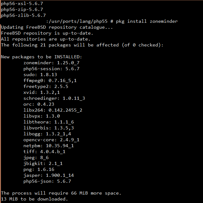

In regards to missing modules and packages. Here's a link on how to install a FAMP Stack. (FreeBSD, Apache, Mysql, Php). It's 10.1 FreeBSD, but for the most part all the commands seem to work.
I'm going through the process now of trying to use pkg instead of ports. (I got hung up trying to install the php module for apache.
My jail just wouldn't accept it. Something about 5.5 lang not accepting.
root@webserver:/usr/ports/lang/php55-extensions # cd /usr/ports/www/mod_php5
root@webserver:/usr/ports/www/mod_php5 # make install clean
Wish me luck!
Edit: https://www.digitalocean.com/commun...ache-mysql-and-php-famp-stack-on-freebsd-10-1

Well would you look at that!

Ah thanks! Fixed the link. I should note, I think this port is considerably old. Once you install it you get a list of instructions on how to set it up. Still working my way through it.

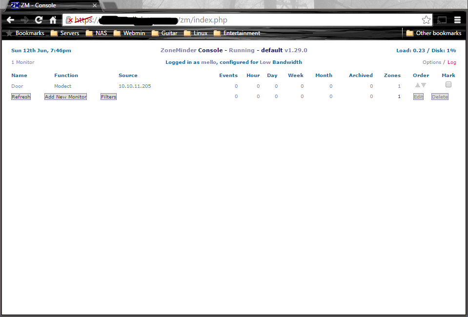

For you guys that are still interested, running on a virtualbox jail. Only one camera, as this is a test site. Planning to wait for FN 10 stable to test it in my main box:
Note the load with one camera: 0.23, on a:
Build FreeNAS-9.10-STABLE-201606072003 (696eba7)
Platform Intel(R) Core(TM)2 Duo CPU E8400 @ 3.00GHz
Memory 3962MB
2 TB pool
and only running ZM and urbackup.
