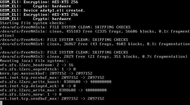

I get the console up while it's rebooting. It reports the file system is clean but gets stuck at the following (see attachment).
It looks like it's hanging at a tunable added using Autotune? Should I unset all tunables as described in the manual? Autotune has never caused a problem before, I'm wondering why it is now.

So you managed to have both your main machine and FreeNAS box lock up? Something seems wrong/unlikely/bad there. Does the APC Smart-UPS indicate any power events overnite?
As for FreeNAS rebooting, what you're seeing there is just console spillover. It doesn't really indicate what it is doing, which is something that annoys me a bit. You can try hitting ^T (control-T) to see what exactly it thinks it is doing, and probably you shouldn't do anything to it until we are really convinced that it is Stuck(tm) or Broken(tm).
If Broken(tm), a new flash disk and copying over the configuration will be the likely fix.
If Stuck(tm), need more info.

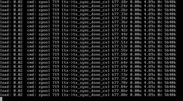

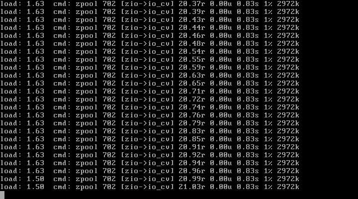

I've changed the title because it happened again and I can boot after a long wait.
I was stressing the drives this time using iozone. This is the most intensive test I could find, it passed all the others perfectly. However this time the web interface became unresponsive, then I could no longer login by SSH. I reset again, but this time I captured the following.
It's about 15 minutes worth of zio->io_cv messages, followed by a few minutes of tx->tx_sync_done_cv messages. It then boots and runs fine.
I looked these up online and didn't find much. It sort of looks like the system is writing failed writes, that the writes were not completed on reset and it's writing the remainder and syncing up the drives. If so, this is a good thing.
But what is a bad thing is that my system goes unresponsive by the web interface and over SSH on moderate load. I did get a console over IPMI, it was indicating the interface was unset. I tried a few commands and eventually it locked up as well.

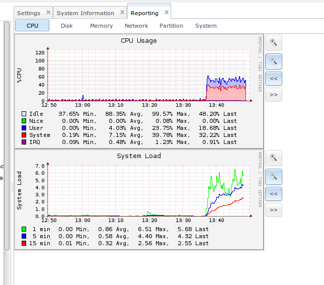

The CPU is loaded during these tests but there should still be capacity to run the web interface and other services. It's 40-50% idle as you see, it should still have lots of resources. (I restarted the test, it's still responding so far.)
This is strange, I don't know what component is failing or if it's a failure at all. I've tested all components individually.
