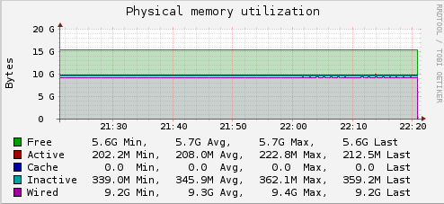

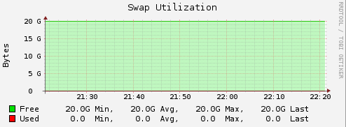

as cyberjock was saying zfs does love ram. i am using an older consumer desktop motherboard so i'm limited to 16GB of RAM so i maxed it out. my pool performs well with this configuration and autotune but when it had less it was a dog and slow with zfs but not ufs. since you need a backup of the data on the server you may want to use that file system instead. since i'm at the ram limit of the board i may use ssd's since today they're inexpensive to improve write performance since read is already sufficient for my needs.
