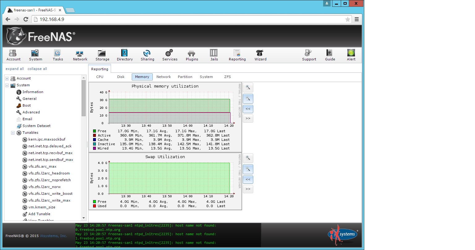

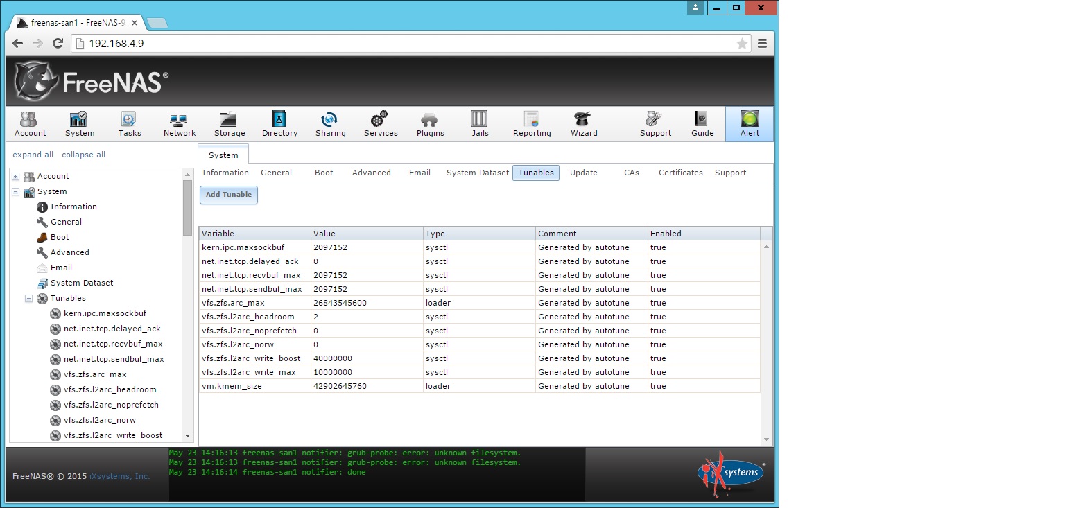

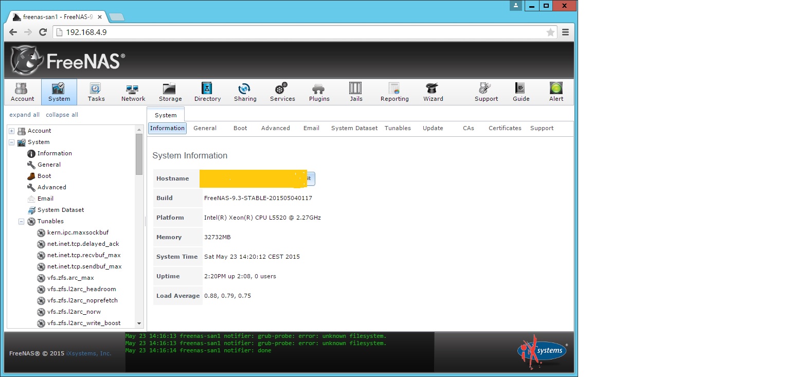

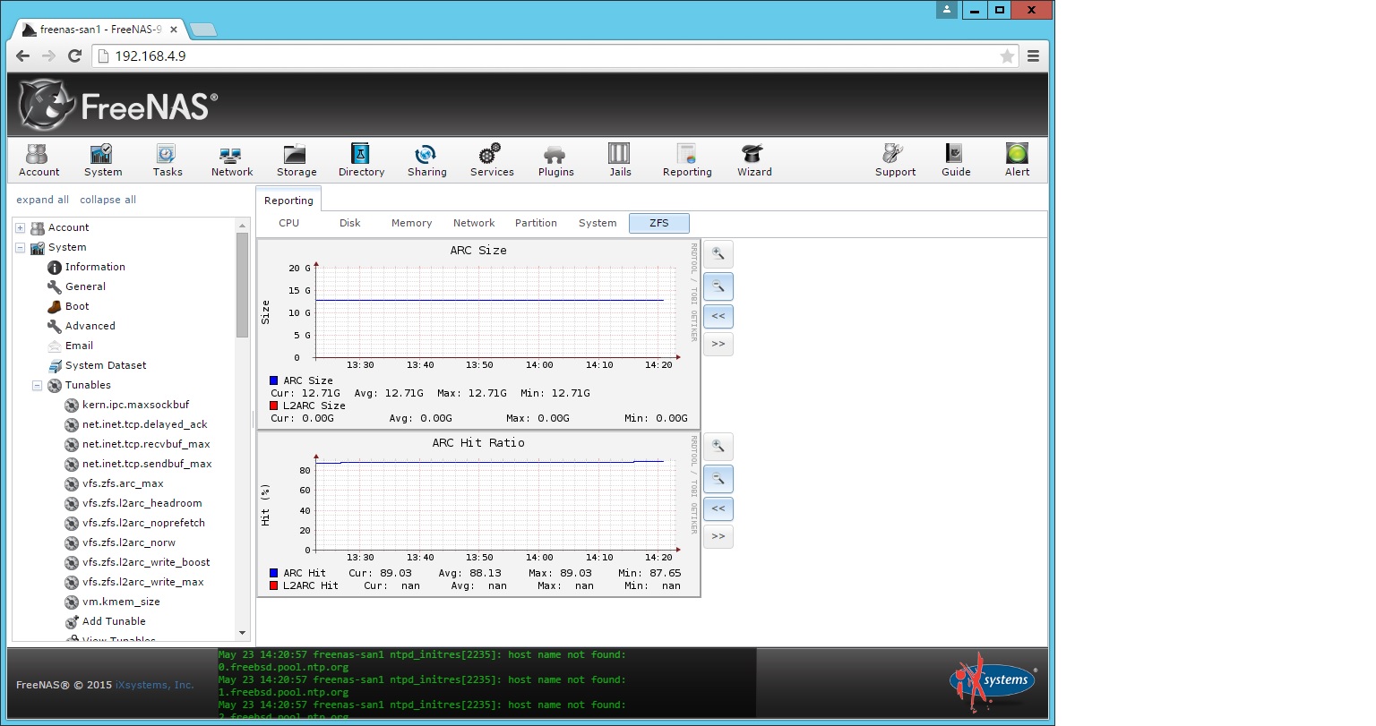

Hi everyone,
not sure if this is the right place to post but since I am really rather new to FreeNAS this might be a good fit. I set up new box, HP SE316M1 with 16GB, using FreeNAS 9.3 Stable, ISCSI and everything works nicely. However, my ARC hit rates could be better and following advise here on the forums I added another 16GB of RAM. The RAM is recognized by the server and also shows up on FreeNAS, but is ignored. The system continues to behave as if it would still have 16GB only.
Here is what I did so far, following advice I found here on some threads:
- reboot with autotune on, did nothing
- reboot with autotune off, did nothing
- changed values on tunables, namely vfs.zfs.arc_max and vm.kmem_size, reboot, did nothing
- turned autotune off, deleted all tunables, reboot, turned autotune on, reboot -> changes were made:
vfs.zfs.arc_max was set to 26843545600 (~ 25GB) and vm.kmem_size to 42902645760 (~39GB?) and the ARC was reset. But after some use, it still peaks out at 12.7GB and leaves about 17GB unused, just like before with only 16GB total RAM.
So what should I do to make FreeNAS use this additional memory? I attached a few more screenshots with actual data.

Fair enough. The FreeNAS system provides only iSCSI, there is a total of 6 (Hyper-V) VMs stored on FreeNAS, as well as an Alfresco repository with ~ 25,000 docs and images. There are two 1Gb NICs on the iSCSCI Portal, on a separate network with separate switches and MPIO access from the Hypervisors. This is all working nicely and transfer rates are fine, no problems there. I have constant traffic of ~ 15 Mbyte on each of the NICs with occasional burst and some peaks of up to 120 Mbyte combined when doing backups thanks to MPIO. You don't see any of this on the screenshots because I made them after a session of autotune changes and reboots which had the box do nothing else.
ARC fills up to those 12.7 GB within minutes after firing up the VMs and peaks there. Total data volume on FreeNAS is 750 GB, with the VMs taking up 150GB. So I am pretty sure my total work set > 12.7 Gb. Once ARC fills up those 12.7 Gb, hit rate is "down" to 80-81%. I am sure that the additional 16 GB could help.
Yes, I rebooted after enabling autotune. Considering the values, it actually changed something but those values are ignored. Also the vm.kmem_size looks kind of weird for 32 Gb. Don't have access to the box from here, will check the output tomorrow.

sysctl vfs.zfs.arc_max
13651230848
which translates to the 12.7 GB the GUI shows as well.
While looking at it, both the vfs.zfs.arc_max and vm.kmem_size tunables are of type "loader" on my system, while the rest is "sysctl". Is this ok or should they be sysctl as well?
Alex
jgreco
Resident Grinch
May 29, 2011
18,680
I believe arc_max and kmem_size are loader. Loader is something that is set before the kernel loads (configured in the kernel loader). Many things are tunable AFTER the kernel boots, but some key system parameters (like how much memory to consume) are determined (or overridden) at boot time.
So either you didn't reboot or your loader config isn't loading or something's being rejected when the loader config is loaded. I suggest rebooting the machine and carefully watching the boot messages. Unfortunately the interesting stuff will probably whip by and be hard to catch.
