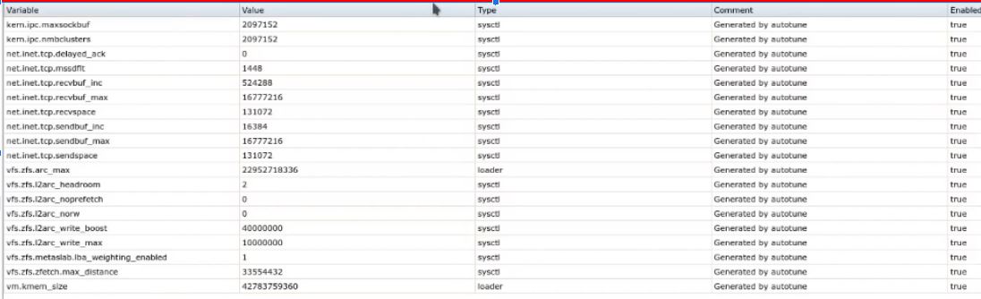

I was watching an excellent YT video review from Nov. 2017 (https://www.youtube.com/watch?v=TgyYU6wuIgk) of a Truenas X10 system (wow, really nice HW/system, dual MB Xeon-D 1531 (dual node) 2u system running HA), and the reviewer showed the page with the systems Tunables.

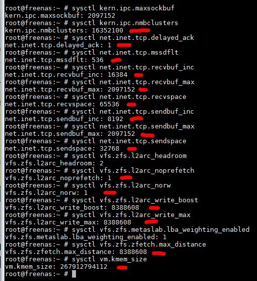

I have marked the stock FreeNAS-11.2-U3 tunables that differ with a red mark (ie this is what a fresh/default FreeNAS-11.2-U3 settings look like vs the tuanbles on the reviewer's system which was running TRUENAS 11.0 u2.2)
*i did notice the screenshot shows "generated by autotune"
Im running high-end + forums suggested hardware, and the only slight disappointment i have had is in terms of performance over 10g (even with all ssd "test" stripes), so if i do test out any of these tunables i will report back here with before/after results. Im mainly looking for any input on these from those more knowledgeable in FN, than I. thanks!

Its a great question so thanks for raising it. I'd be interested to see what other people have to say but very much like you, I've always got the feeling from within the forums that you should keep away from tunables as much as possible and especially autotune.
However, saying that I did recently purchase a TrueNAS and by default it came with autotune enabled and therefore had quite a lot of tunables set by autotune.
My general thought is perhaps autotune is a good idea if your hardware/config very closely resembles that of iX's TrueNAS or even perhaps their certified FreeNAS systems. However if not then perhaps things can end bad as autotune might make some assumptions on hardware/config.
Having said that I don't have autotune enabled on any of my production servers and don't plan on doing anytime soon as they are working just fine.
