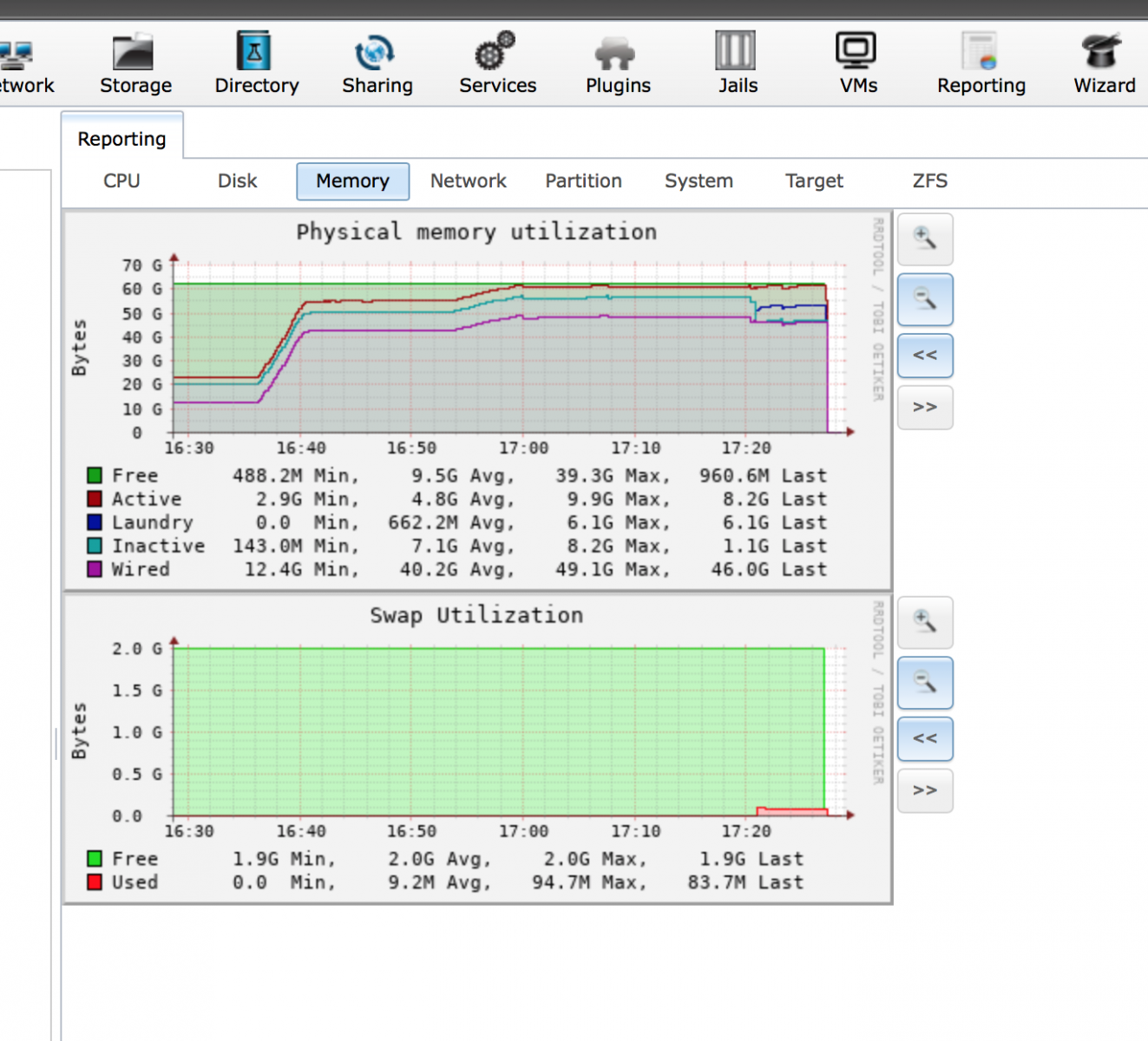

I just looked at the original pic you posted. Looks like you are running along with 600+MB of free memory, and still getting swap. I can't see what's to the left of the graph when things started, but assuming the 600+MB of free memory is constant, you may need to start by setting those free_target values to 262,144 (which would be 1GB).
While I have not personally debugged to root cause, what appears to happen in these systems is the evacuation of the arc doesn't happen fast enough when memory is requested. So the OS swaps some stuff out. The free_target controls keep more available memory around, which basically acts like a larger buffer for memory. So if 600+MB of free memory isn't enough you probably need to go higher. Hence the suggestion of 262,144. You can check what the values are before you start, it would be interesting to see what the system thinks it needs.
I noticed you are also running 11.1. Not sure what version. But there was a memory leak, I think related to SMB (not sure if you are running that service). I saw where it was supposed to be fixed in 11.1-U1. However I'm on 11.1-U2 on my backup server and I'm still getting a lot of inactive memory growth. You don't appear to have this issue, at least based on the original pic of the memory reporting. But something to keep in mind if you continue to have issues.

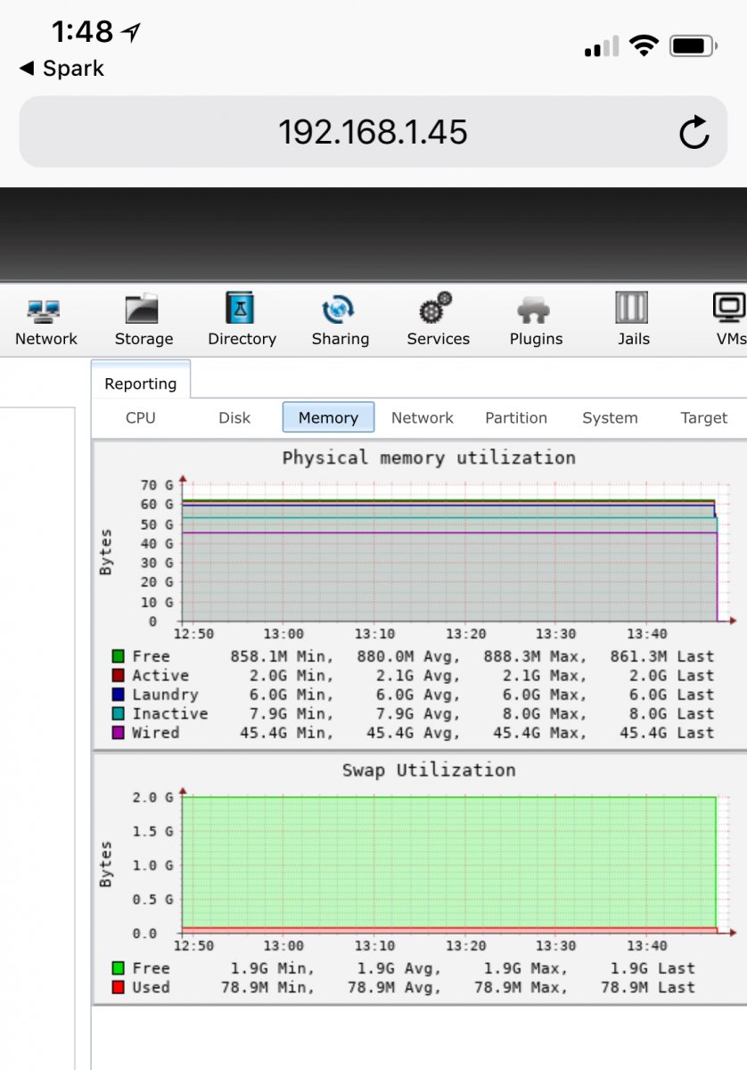

An update:
So far wired is still at 45gb (it dropped a little, then recovered a little which it has never done before). Swap has gone done a little as well to 79 mb.
Laundry went down slightly to 6gb, but seems to be staying there. However, the VMs started to get use again leading to more inactive memory.
I’m not sure what ratio between inactive and laundry the system looks for before it starts cleaning up the laundry basket, but I guess time will tell.
Anyhow, I’ve never had the wired bucket or ARC pool stay so large over time & the inactive stay under 8gb so I think this might be a little bit of a win.
Depending on how things go (and the effectiveness of the patches that are to be released) a solution may have been found or close to that with hopefully just some tweaks to the way the laundry basket is handled.
If the active bucket doesn’t go up soon I will probably get a little worried. The VMs don’t need much memory to work, but at the moment the media server seems to be a bit choppier, especially when seeking, which I think is attributed to the amount of ram available to it (im guessing that since FreeNAS has the video file in its own ram the file doesnt necessarily have to be stored in the ram allocated to the VM as well, but is prolly why I’m getting only slight performance issues).
Then again, I’m a totalll noob so I could just be talking out of my a** and just gotten lucky by listening to the suggestions of those wiser than I...

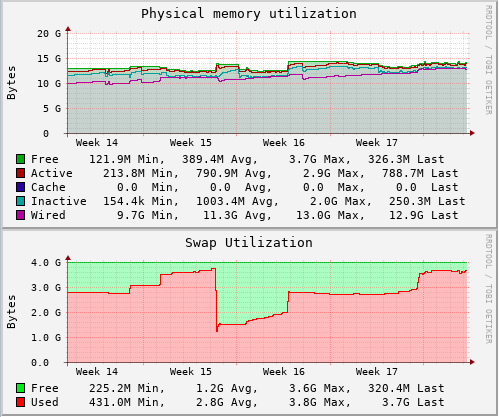

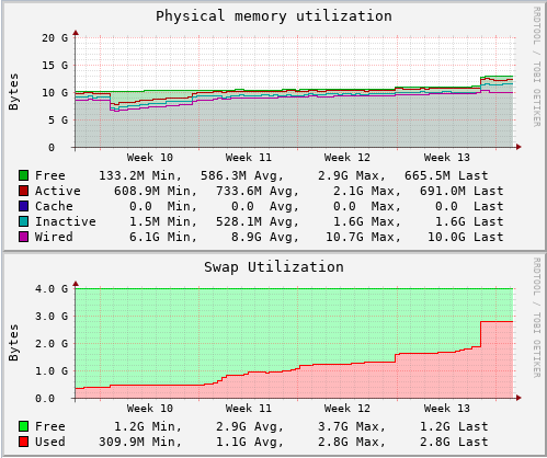

I already reported this in another thread when I thought it was an SMB-related issue, but might post it here as well as it seems more like it is related to OP's and appoli's problem. I have 16Gb memory on a device with one 120Gb SSD, one 1Tb external drive and a 3-mirror 3Tb RAID. Only basic services with Samba and NFS for VM use. I run a Docker VM, which first had 6Gb memory allocated to it, but after a month or so of uptime I started getting error messages about swap failure. Turned out my swap utilization had slowly crept up until it was full. This started even when I had quite a bit of free memory available. I lowered the Docker VM memory to 4Gb, but the problem persisted and soon my swap was full again with hundreds of error messages a day. I checked SMB and it was not showing a memory leak.
End of week 13 and 17 are scheduled scrubs and week 15 is when I restarted the VM with 4Gb memory.
I finally restarted my system with 3Gb memory allocated to the VM (had to disable some containers) and now my memory use has remained stable for several days after the restart, with no swap use. I am waiting to see what happens during the first scrub though...
So, to back others with this problem up and provide more data, there seems to be a problem with the Docker VM and memory use that is not connected to SMB. Hopefully this gets fixed in the next release and I get to allocate some more memory to my VM again. Otherwise I might try the above mentioned tweaks to tunables, thanks for everyone's input and help on those.
