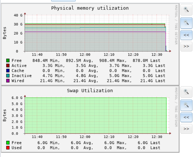

So its been like 14 hours and so far no swap usage after I turned off autotune.
But you will see to try and make the ram usage go up I played a 4K Planet Earth II for couple of hours on plex (80% CPU usage).
The "active" ram went up to like 8GB and "wired" ram has since stuck to 21-22GB. The inactive ram is just difference between max active ram of like ~8GB and current active ram.
I played 4k video again (this time it was not smooth playback) and noticed inactive ram usage kept going up and active usage kept going down (very odd) but never used swap.
I will report back if swap ever gets used
My NAS has been up for 15 days and I have only 10MB of swap usage and it isn't changing. Is the swap utilization causing some sort of malfunction?

Is the swap that your system is using causing some kind of malfunction?
It is just that I didn't see swap usage before 11.1 and now I am seeing the usage spike. From what I know zfs relies on RAM to do lots of things and that is why ECC ram is recommended but if swap that is spread across my 6 drives and some of the drives start to malfunction, there is a slight chance of loosing my data or having it in unrecoverable state as swap might get corrupted too.
