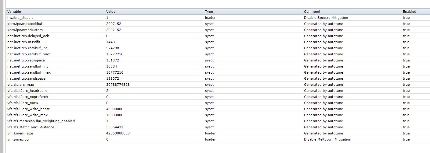

It looks like it still sets memory headroom (which is why I was using previously) and then sets additional network buffer sizes and settings depending on available system memory. I suspect that unless you have a network performance issue using normal system determined values, I suspect you will be fine without autotune.
For example, it sets net.inet.tcp.delayed_ack to 0. Unless you know your network performs better with that setting, it's probably not needed. If there are performance issues one may want to tune with net.inet.tcp.delacktime (default =100). For example with low latency 10g links a setting of 20 might be better.
With the point being it looks to me (not an expert) from the code that autotune is trying to get you "unstuck" or "out of noticeable performance issues" vs necessarily "optimized."

If AutoTune is actually limiting the ARC to prevent crashing the system, it's actually maybe a good thing. And when it's tweaking some network buffer values and stuff, it also sounds good to me. And it might be quite interesting, if AutoTune is actually boosting the network values in some kind (with having performance in mind), or actually reducing them to prevent memory issues. So I'm actually absolutely not sure, if it's now a good thing to enable AutoTune, or if it's actually the most evil function to turn on.
However - you asked for set tuneabls, and here are the current set ones:
I was researching on a few values in the past, but unfortunately I'm not really that experienced what EXACTLY each of the tunable is actually doing and what the positive or negative side effects may be. I'm not working neither in the network or storage IT branche - but of course I'm interested to learn more, that's why I'm asking here :)
Just in case: I'm also using Jumbo frames on my FreeNAS, VMware ESXi hosts and on the dedicated storage switches I have.

pkernstock
Nov 10, 2017
8
@toadman
Thanks a lot for your suggestions! I see. That makes sense!
I do have AutoTune enabled since from the beginning of my new setup - so about 6-8 months I'd say. Never experienced any (serious) issues in the past, RAM usage is also always about 95% - so ARC seems to be used quite well. Unfortunely I don't have any performance values I might be able to compare with.
