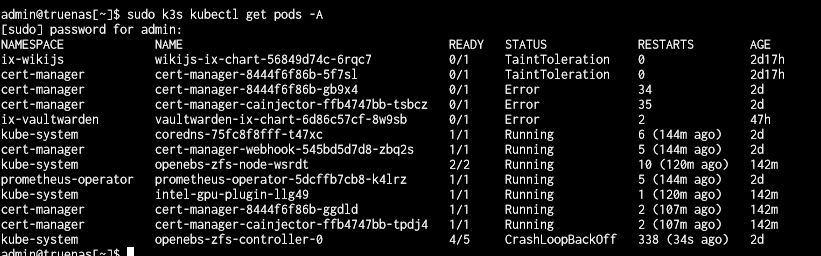

But, if I'm transferring a file from my Desktop to my NAS, then after a couple of seconds, I've got a big iowait usage and it looks like when I do k3s kubectl get pods -A, my zfs-controller pod restart count is increasing.

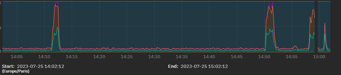

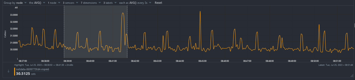

This is my CPU temperature (from the CPU sensors) :
The highlighted part shows the interval where my CPU usage is at 100% due to the io wait.
These results concord with the TrueNAS reporting.

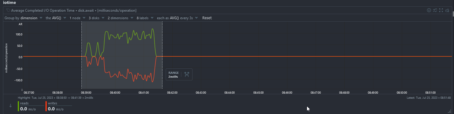

Something I noticed this morning is that when I'm writing, it's also reading and we can see a symmetry. Can it be the cause of iowait?

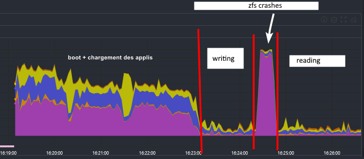

Back to RAM then... you have 8GB (you say it's using 4)... does that remain true during the operation?

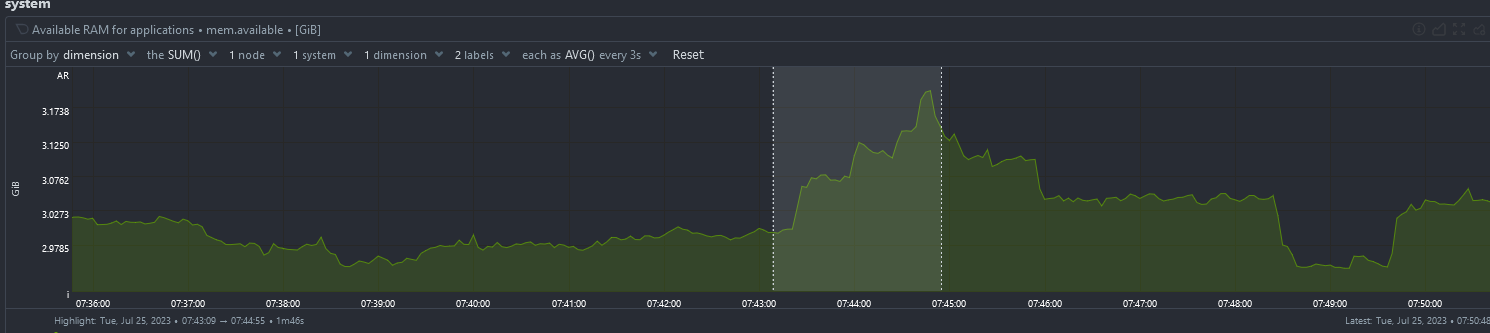

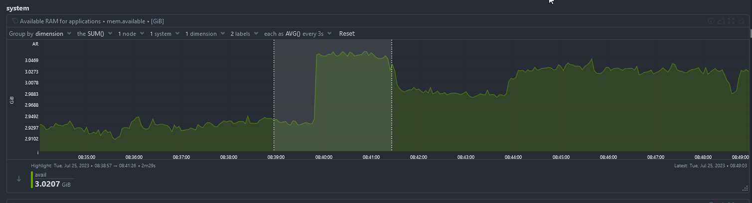

No totally, but not enough to have less than 1GB remaining, here are 2 screenshots:

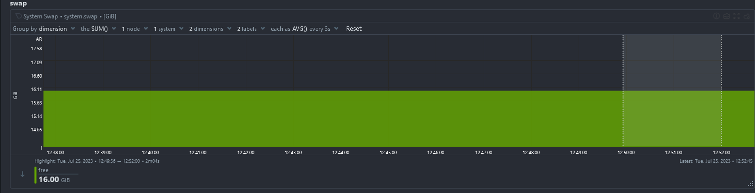

Are you using swap space anytime during the process?
8GB of RAM feels tight, especially on SCALE.
Not a single change.

ZFS crashes again + the reporting graph stopped monitoring for a few seconds
I just want to notice this is the first time I got the status CrashLoopBackOff, I remember to have read one post talking about CrashLoopBackOff, and I'm trying to find it.
