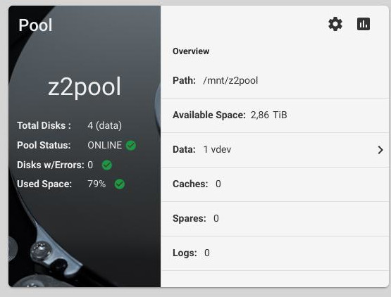

Hello people: Please don't put this in SMR or drive/controller issues when it clearly is not.
The resilver had run through to 100% for at least 20 times now, with not a single error! Everything hardware related is running perfectly fine! Also the resilver has always worked flawlessly the years before.
There's no reason at all for thinking there was an issue with the hard drives, because then it would need to throw lots of errors but there are zero.
The drives not all shown with their GPTID in the pool and the disk edit window not opening for da1 has nothing to do with the drives being SMR.
And the resilver starting over after successfully running through to 100% hasn't, too.
This clearly is some configuration/administrative/meta problem, with the GPT table being wrong from all my experiments or such.
I tried swapping the port now and it didn't make a difference, as expected.
I just need help reconfiguring and re-adding the drives in a way that repairs/organizes their names correctly again.

The pool is fully functional. All data is accessible and there are no errors reported. I did all the tinkering from the Web-GUI AFAIR.
Yes, I think I did some thing(s) wring and now the storage organization is somewhat confused.
But as it's fully operational I think it should be possible to fix this with some commands.

Here are the details as much as I can remember:
What I did before:
It has been some weeks, since.
It was a very hot period in the old computer case (Poweredge T20, which sadly is reknown for being terribly ventilated).
I was copying some 250GByte from my Notebook to the z2pool and at about 150GByte the transfer stalled.
I had a check at the Web-UI and it told me there was some degradation. Checking the drives showed me, that one drive supposedly failed.
I wanted to make the drive running again, for at least finishing this one transfer I was it. So I think I first tried the replace feature and noticed it wouldn't let me replace the failed drive by itself. So I offline the drive and onlined it again. I think then something didn't work as expected, like the WebUI not reacting to my commands or so.. not sure anymore.. anyways something lead me to try the replace feature again, and this time it actually did allow me to chose the drive that had failed before. After this I waited for some minutes and nothing seemed to have happened again. I then did an offline/online again and it ran again.
After this (the weather had cooled down somewhat) I restarted the data transfer from my Notebook for the remaining 100 Gbyte. And of course at some point two of the drives overheated again .. I was stupid enough for trying it more and more and committed very many offline/online and replace actions in a row, until the pool accepted the drives again, each time there was an overheating event.
In the end I gave up and moved all the hardware to an much better case which had gotten in between, where the temperatures overall are about I 20 C lower.
I then had the idea, I could try enabling acoustic management and power management for the four drives, as this might have an effect on the drives running even cooler.
After doing so I first noticed, that I could not access the 'Edit Disk' options for da1 anymore as well I was wondering why this one drive was shown as da1, while the other drives where shown by their GPTID .. I am not even sure if it possibly was like this before all the hustle.
And that basically is where we are at now.
