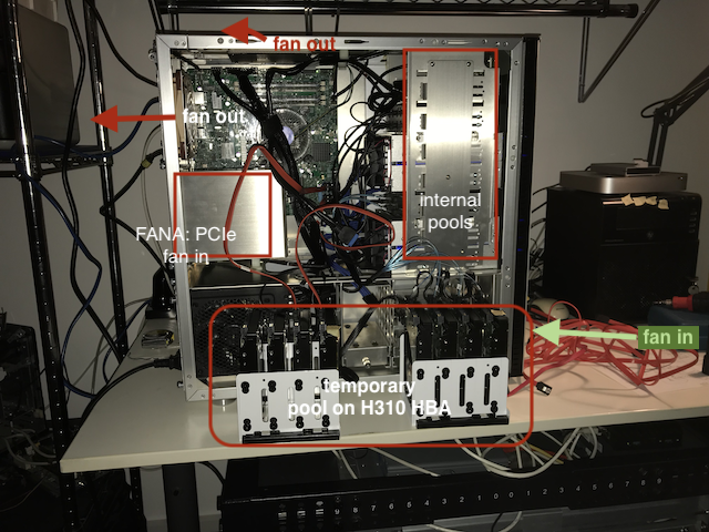

Here is my failing HW build:
This is an old Lian-Li pc-a10... It was a good case, but I suspect I have a broken airflow :smile:

There is no universe, to my thinking, where this configuration should go to 98C, even under maximum load. You MUST have a problem with either the CPU fan, *or* the heatsink mounting/heatsink compound. It's literally impossible.
