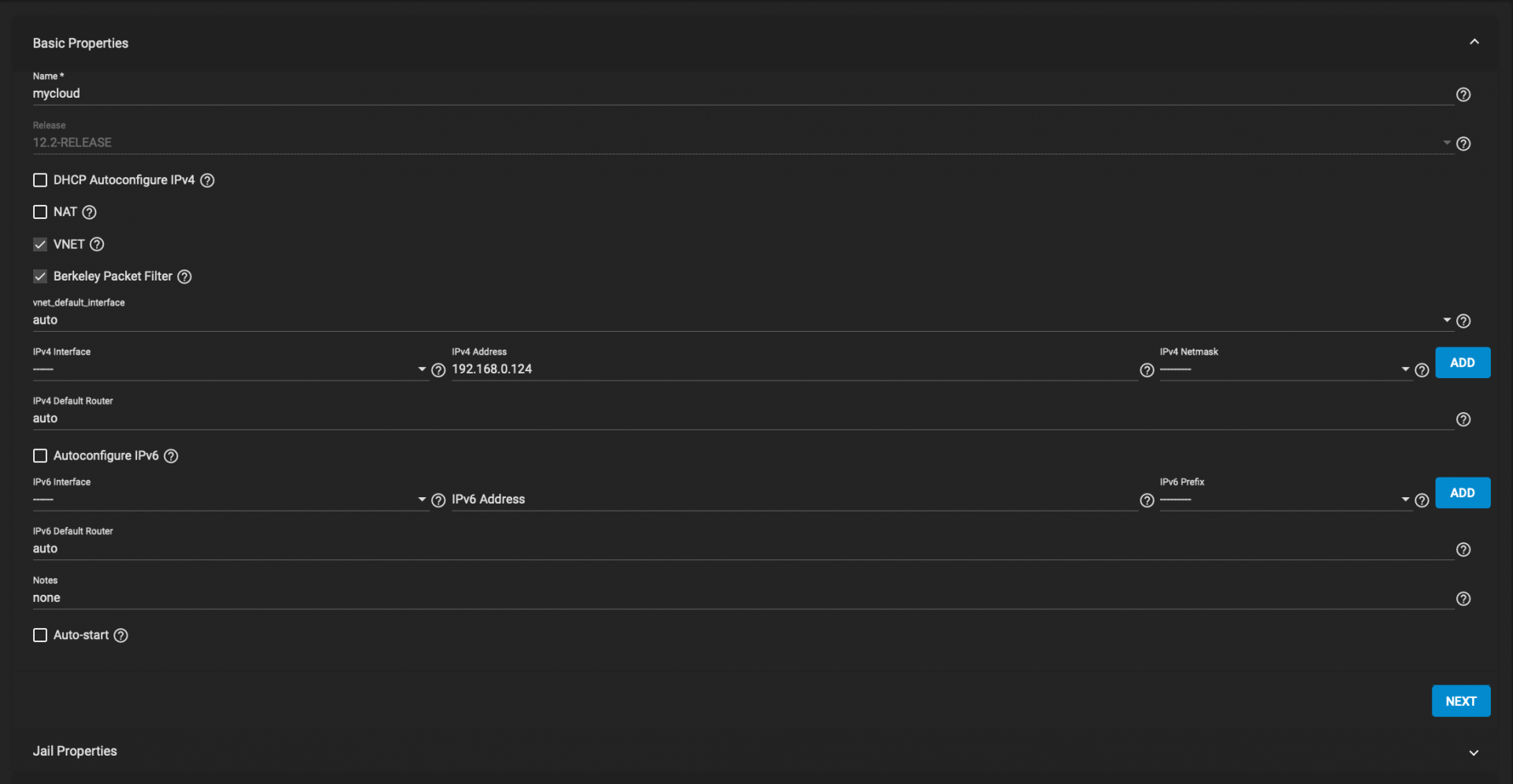

I created a new clone jail from the UI -12.2 release. No DHCP, no NAT, VNET ON IPv4 default router: auto, vnet_default_interface: auto and I put a static address in IPv4 address. I have attached a screen shot. At first I had vnet_default_interface at r0 and I was getting the exact same error message as I was getting this afternoon with your commands.?? SSH is enabled on the jail, but I can't edit the config file to give me access to the root without a password. Im getting access denied. Good evening

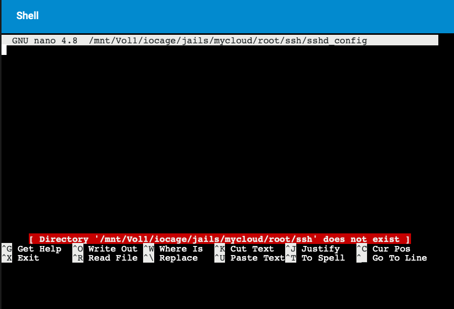

Patrick - very sorry to bother you again, but the Directory does not exist?? -- Look at the 2 pictures attached
Patrick M. Hausen
Nov 25, 2013
7,776
You ommitted an "etc/" in that path. You can use the TAB key to have directory names auto expand on the shell, e.g.
vi /mn TAB V TAB ioc TAB j TAB my TAB r TAB et TAB ssh TAB sshd TAB Enter.
If nothing happens at pressing TAB, then what you typed so far is not yet unambiguous.

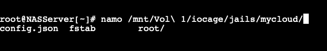

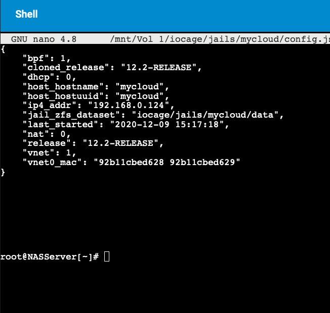

Patrick---here is what is available after /mycloud/ ?? using the TAB - I got into the Config.json file with nano editor. Did not change nothing
