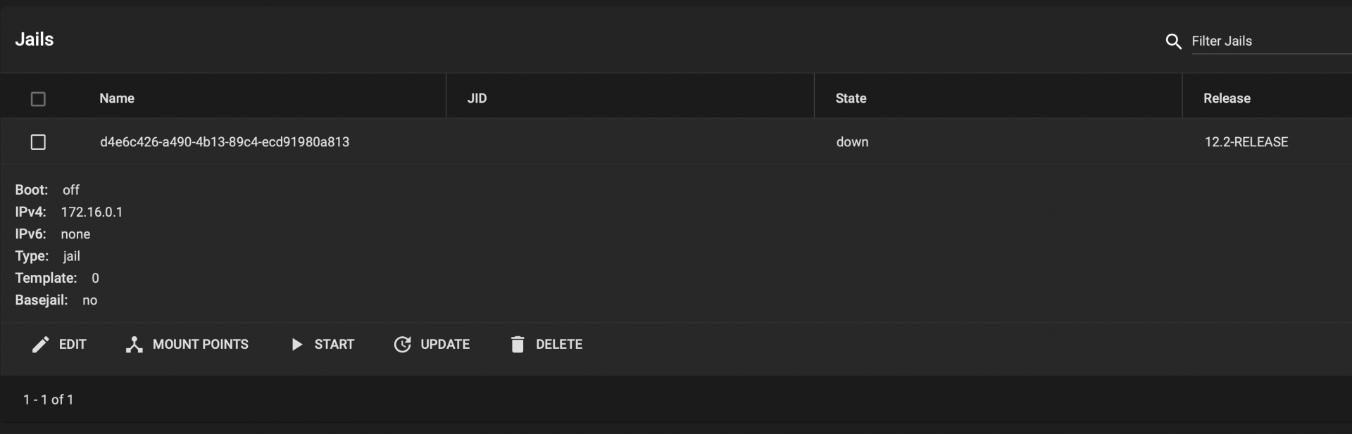

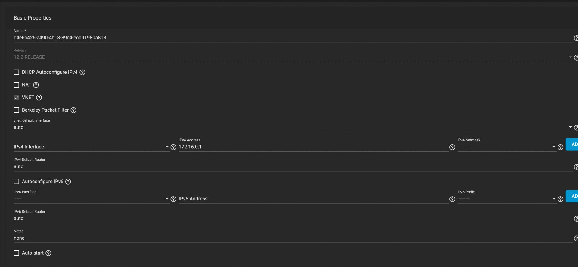

ok I have got an IP. I will go to the second step. My server is connect to my home router with DHCP enabled. However, the IP address Im getting for my jail is not a sub set of my router IP?? my server is at 192.168.0.154/24 and my jail is at 172.16.0.1??

Disable NAT for your jail. UI - all fine.
Patrick M. Hausen
Nov 25, 2013
7,776
Please post screenshots of your network settings for the jail.
Bureaua
Nov 28, 2020
75
Here it is
