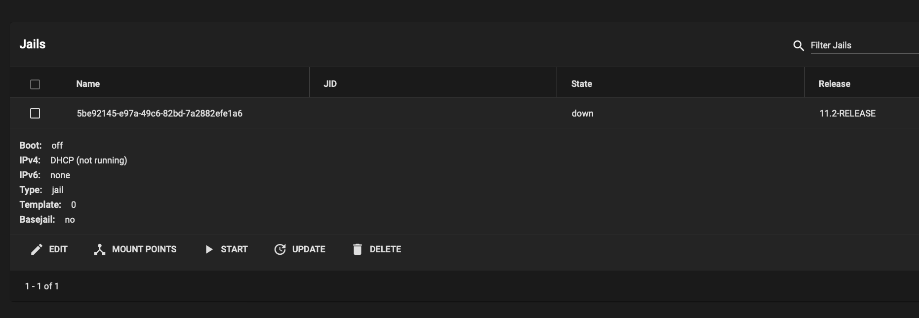

Here is what the shell indicated when I created the jail through command line

remove the static IPv4 address
enable DHCP
change default vnet interface from "auto" to the one your NAS uses to connect to the LAN or "bridge0" if that exists
select "vnet0:..." in the IPv4 interface setting
That should do it. If not we need to do some bridge magic to make the jail and the Windows VM play nicely together.

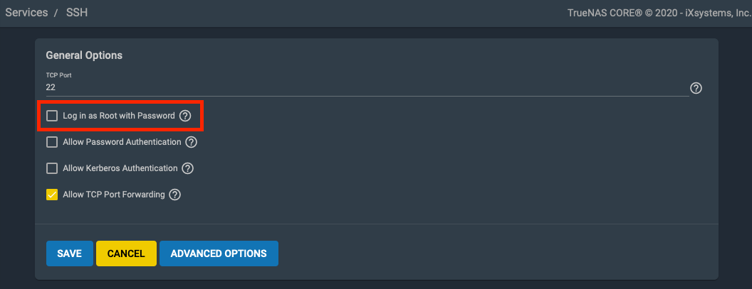

P.S. Use your Mac's terminal and connect to your NAS via SSH. The "shell" inside the UI is broken. And we need the terminal later, anyway.

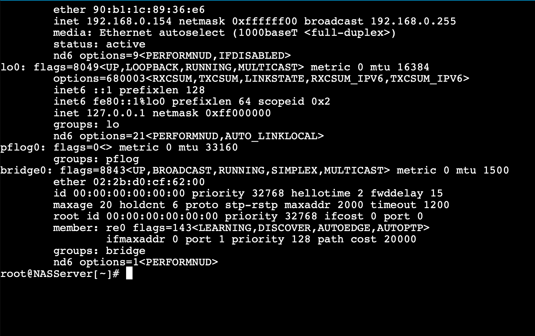

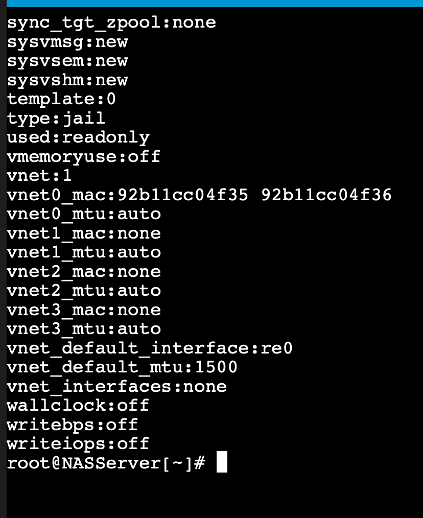

Patrick-- attached is the output

Patrick M. Hausen
Nov 25, 2013
7,776
That is only fractions. You must open the Mac Terminal.app, type ssh root@<your NAS IP>, confirm with "yes" once, the give your password. And then use that command line instead of the one in the UI.
Then you can copy&paste text instead of pictures.

Patrick-I managed to SSH using my Mac terminal by using my user name. I could not do it at the root.
ssh root@192.168.0.154 ask for the password but would not accept it?? Therefore I did the following
ssh bureaua@192.168.0.154 and it accepted the password. I can guarantee the password at the root is in place and I entered all right, but would not accept it ?? I really don't know why.

The 2 files attached were obtained from my Mac terminal by running the commands you gave me ifconfig -a and iocage get all
I ran those commands when I was logged as my user name bureaua

See you tomorrow then :wink: Meanwhile you could enable and configure the SSH service for the NAS itself (permit root login with password) - it's under "Services".

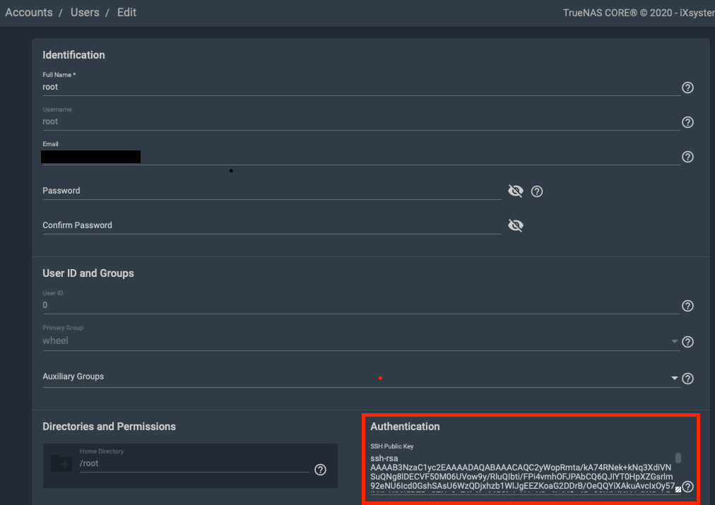

But now that you have another user to logon, you don't need to change that setting. We can go the next step with the private/public key pair and set up a more secure way of logging in as root.
You can find instructions on how to generate a key pair here:
Then in the section Importing your SSH key simply ignore all the stuff about the Joyent portal. Instead open up the menu "Accounts -> Users" on your NAS and edit the "root" user. Then paste the public key that you copied to the clipboard with that pbcopy command in the instructions into the corresponding field of the root account. Save - done.
You should now be able to ssh root@192.168.0.154 without a password but still reasonably secure for a system on an isolated private network. Never hand out that private key!

Private/Public key pair done and working ! :)

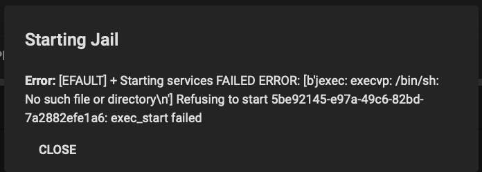

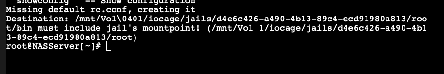

Patrick,
I deleted the iocage dataset and re-created a new base jail. I re-booted the server and tried to run the jail using DHCP configuration. Im getting the same error. DHCP not running. Attached are 5 files
Jail creation from the shell
ifconfig -a from Mac terminal to the root
iocage get all from Mac Terminal to the root
Error message when I start the Jail
Jail configuration
Thank You very much for your time

Patrick M. Hausen
Nov 25, 2013
7,776
Hi!
How did you produce these text files? They contain a lot of unecessary gibberish that is hard to read. Simply select a piece of text in the terminal, type Cmd-C, then paste it into a "code" container here in the forum like this:
$ echo "this is something I did in the terminal"
$ ls
Applications            Hacking                Nextcloud Privat        VirtualBox VMs
Desktop                Library                Pictures            bin
Documents            Movies                Privat
Downloads            Music                Public
Favorite            Nextcloud Firma            Virtual Machines.localized
Your jail still looks somewhat odd. First, 11.2 is a release way too old to use productively. You will not even be able to install packages in 11.2, anymore. Plus it doesn't have a name which is rather inconvenient.
So I suggest to start over.
Then:
iocage fetch
# pick 12.2-RELEASE
iocage create -b -r 12.2-RELEASE -n mycloud
Then let's configure this DHCP thingy correctly:
iocage set dhcp=on mycloud
iocage set bpf=on mycloud
iocage set vnet=on mycloud
iocage set nat=off mycloud
iocage set interfaces=vnet0:bridge0 mycloud
And fire up:
iocage start mycloud
iocage list
| JID |  NAME   | STATE |   RELEASE    |      IP4      |
| 1   | mycloud | up    | 12.2-RELEASE | DHCP          |
Good luck!

Patrick everything worked up to
it says: Refusing to start mycloud: exec_start failed
