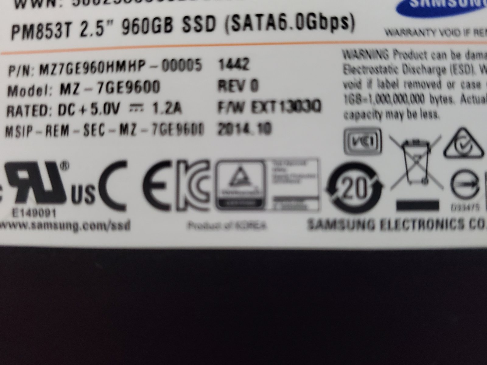

After doing some research, I had decided on not using the LSI, VMware is reporting it as deprecated. It still works but may not in future. So I took the card out. The SSD are Samsung branded, Included a picture.
I plan on running a domain controller but VM's will be on the MegaRAID-backed VMFS datastore. I will be running only APPS on TrueNas, no vm's. I think I am good then, thank you all for the help!!!
