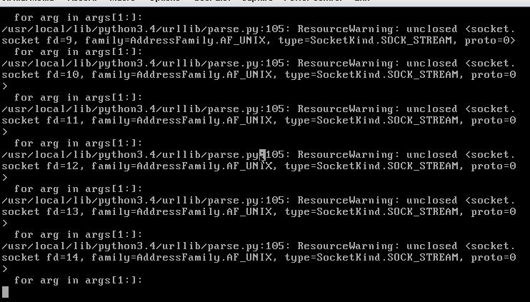

Hi - I'm trying to install freeNAS (9.3, 9.10, 10, any version really), on a SuperMicro 4U system that is a duplicate of another SM 4U system that I am successfully running 9.10 on (~90TB storage) and have used for over a year. On this particular hardware, I ran Nexenta 4 for several months and have decided that freeNAS is where we need to be. Here is the system description:
4U Supermicro 847A, X9DRH-iF, 2x Xeon E5-2603, 64GB RAM, FW 3.36, BIOS 3.0b, IPMI config'd
2x 8GB Patriot USB Boot drives (mirrored) for FreeNAS OS
1x Quad mSATA PCIe card with 2x Crucial 250 GB Internal SSD (for cache)
5x LSI 9207-8i HBAs (running firmware 16.00.00.00-IT - I will update this after install)
various SATA drives (on HCL list), ranging from 6TB/8TB to 1TB SSD
1x Chelsio PCIe Dual 10gig Intel X520 (SPF+)

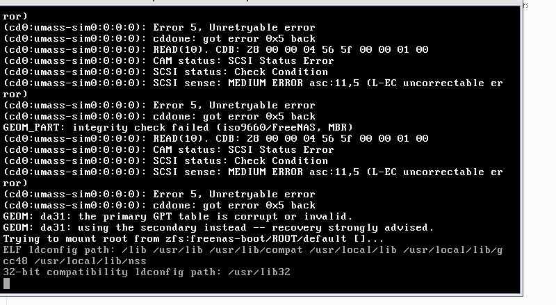

I cannot for the life of me get freeNAS successfully installed. When using a USB cd or IPMI iso, I get umass errors as in the first screen cap. And the install eventually runs, but then when booting to the mirror'd (NEW!) usb drives, I get the errors in the second screen cap. I have also tried 2 mirrored SSDs connected to the SATA on the MB with no joy, i.e., I get the "grub rescue" error.
Can someone suggest how I might proceed with a good install? I think the MB is OK, and have tried all combinations of the 4x USB 2.0 ports. Tried removing all HDD/SDD and just install to usb. Just running out of ideas... I've search and read as much as I can handle at this point!

The first screen dump looks like a bad CD, perhaps a corrupted installation image? Might be worthwhile to download another copy.
Did you try creating a FreeNAS installation USB stick and installing from that? With 4 x USB 2.0 ports, you should be able to boot from one of them and install to a pair of mirrored USB sticks (if that's where you want FreeNAS to live).

I've done all of these things. I've burned CDs (on different burners) of 9.3, 9.10 and 10, installed same to USB sticks and run into various errors... remember, I have another one of these systems that is an exact duplicate that is already running 9.10 - but the initial install was over 16 months ago. I don't remember any of these issues on that box.

@Stephen Hayne , would you please post as much detailed error information as possible?

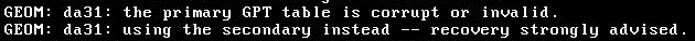

All hashes are fine. Tried 3 new/different USB drives and all failed. I wonder if we are having difficulties with this partition problem and the SuperMicro X9DRH:
https://forums.freenas.org/index.php?threads/freenas-stable-9-3-unable-to-boot-usb.28103/
Our other identical box boots from mirror'd SanDisk USB drives, but we started with 9.1 on that system... so maybe we still have the proper partitioning for boot for this particular MB. 9.3, 9.10, and 10.x will NOT install and boot onto USB...
