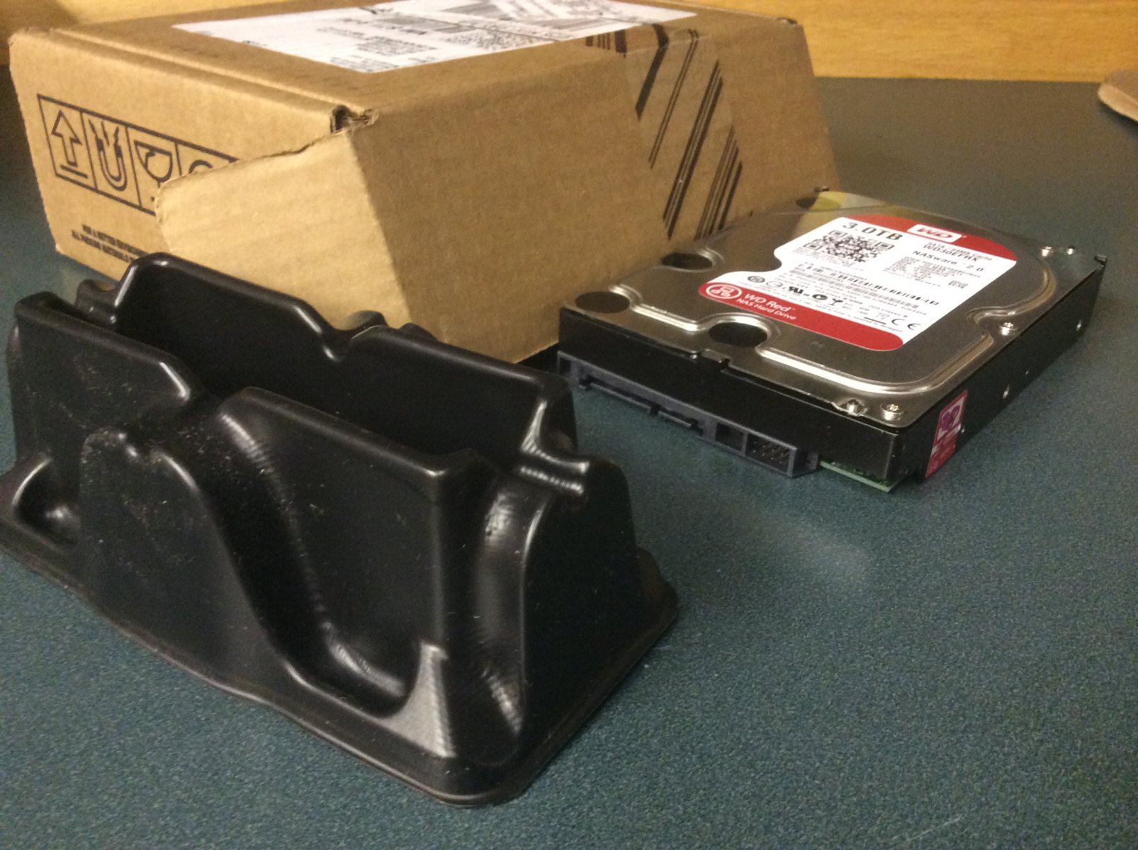

Sure thing. I've ordered literally hundreds of drives over the years and have only received a couple shipped this way- and most of the time they were DOA.
cyberjock
Inactive Account
Mar 25, 2012
19,525
Actually, that looks like the same box I've seen from WD, and Seagate, and HGST.
I'd say you got exactly what we all get.
You probably remember those foam boxes from long ago? They replaced them with the plastic that helps absorb force and "floats" the hard drive in the middle. I prefer the old foam boxes, but that's basically the industry standard now. :(
