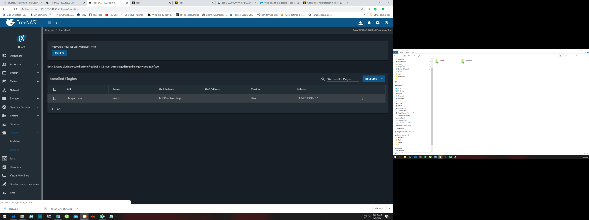

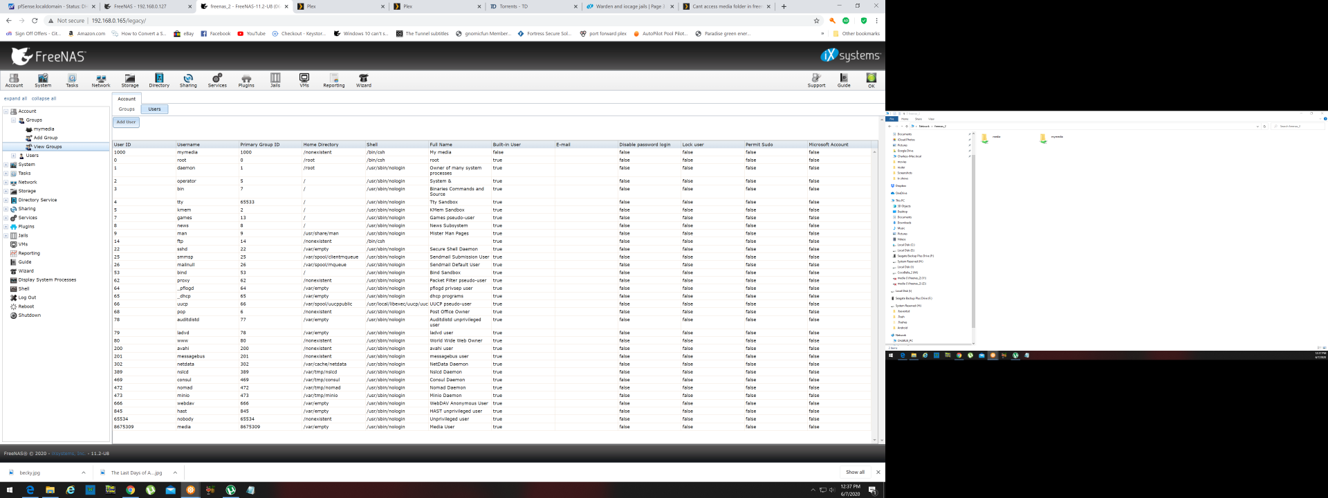

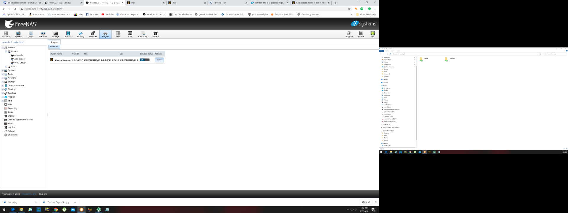

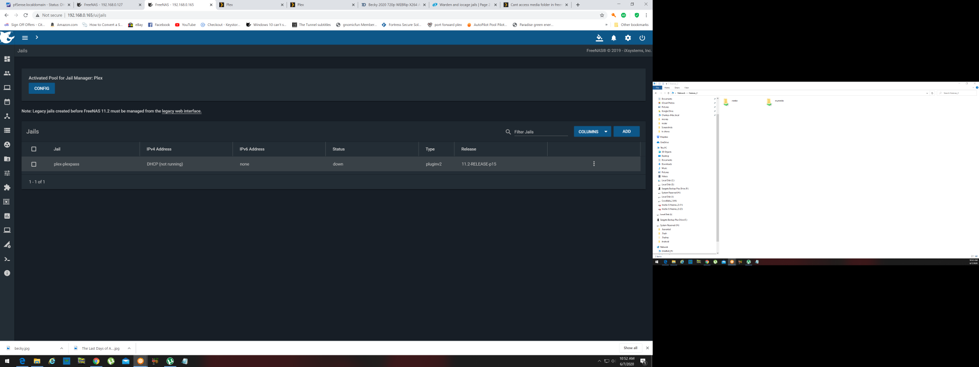

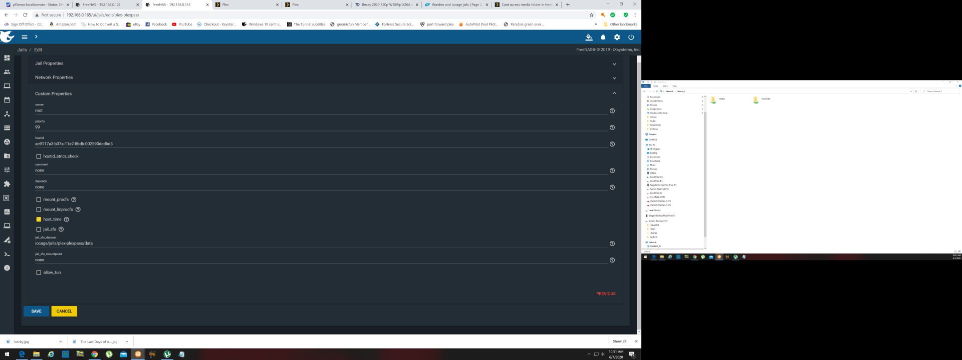

This is what I have done

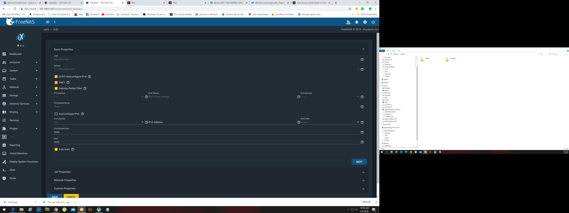

sakn54
Jan 19, 2014
48
same plex in warden jail
sakn54
Jan 19, 2014
48
does jail have to be running in order to access shares. It's running right now out of a warden jail.
Samuel Tai
Apr 24, 2020
5,399
No, the jail doesn't have to be running.

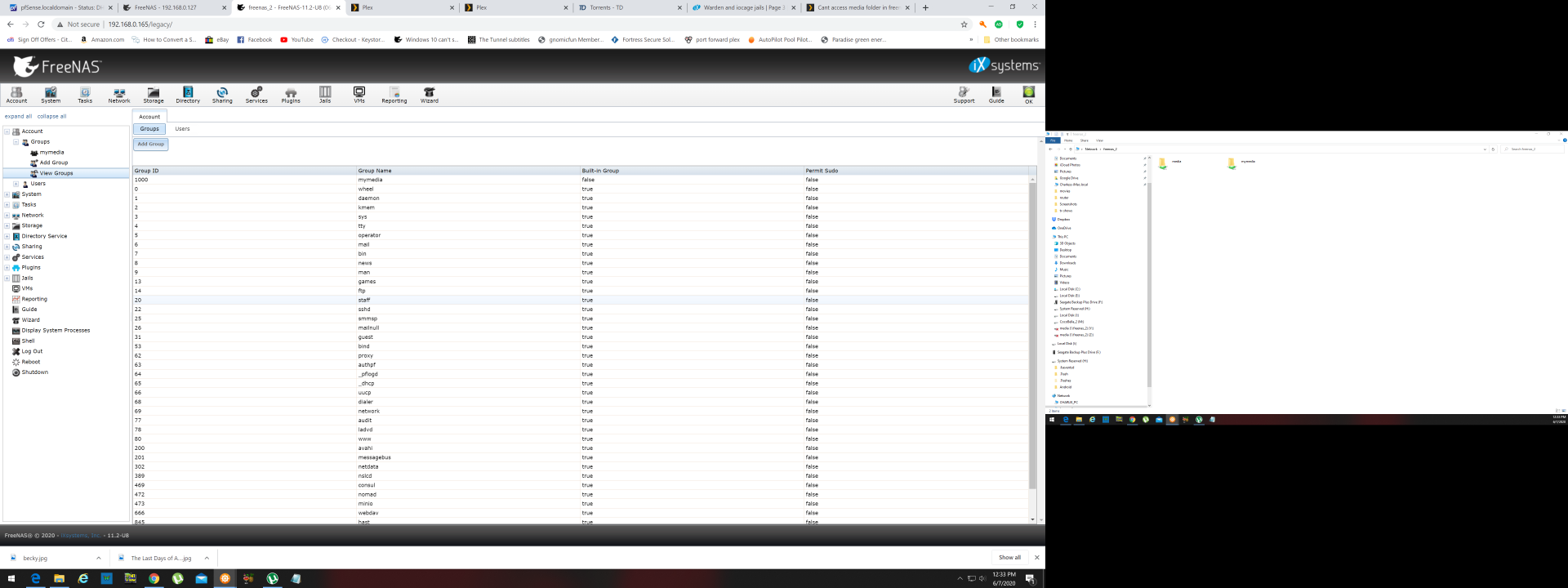

another pic of groups in plex
sakn54
Jan 19, 2014
48
i noticed that group and user have false in built in user and group. Could this be the problem?

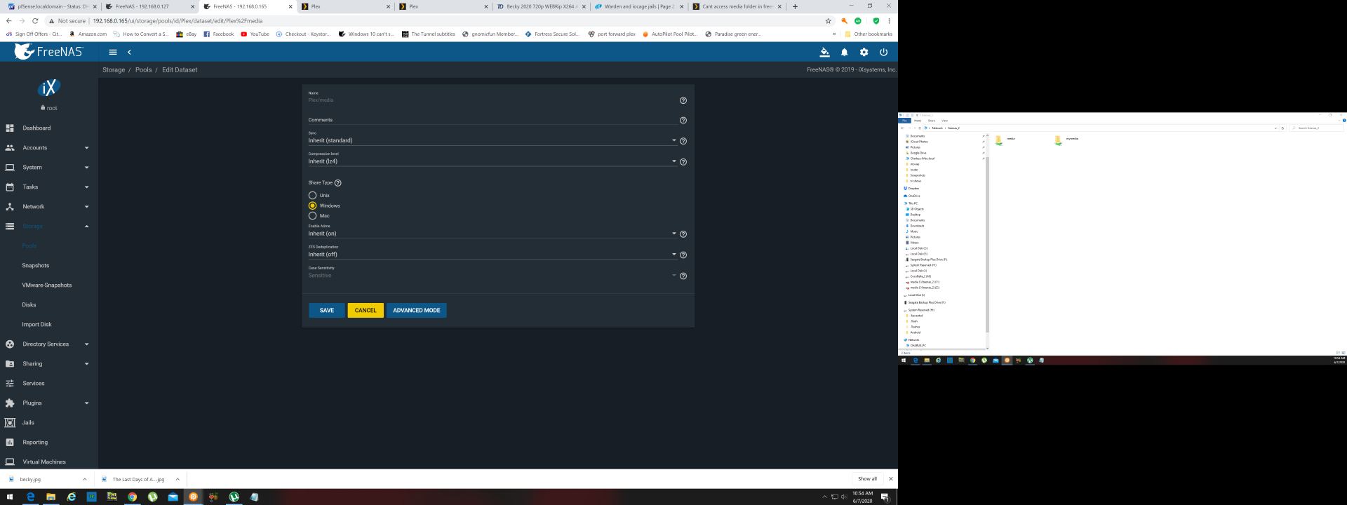

sakn54
Jan 19, 2014
48

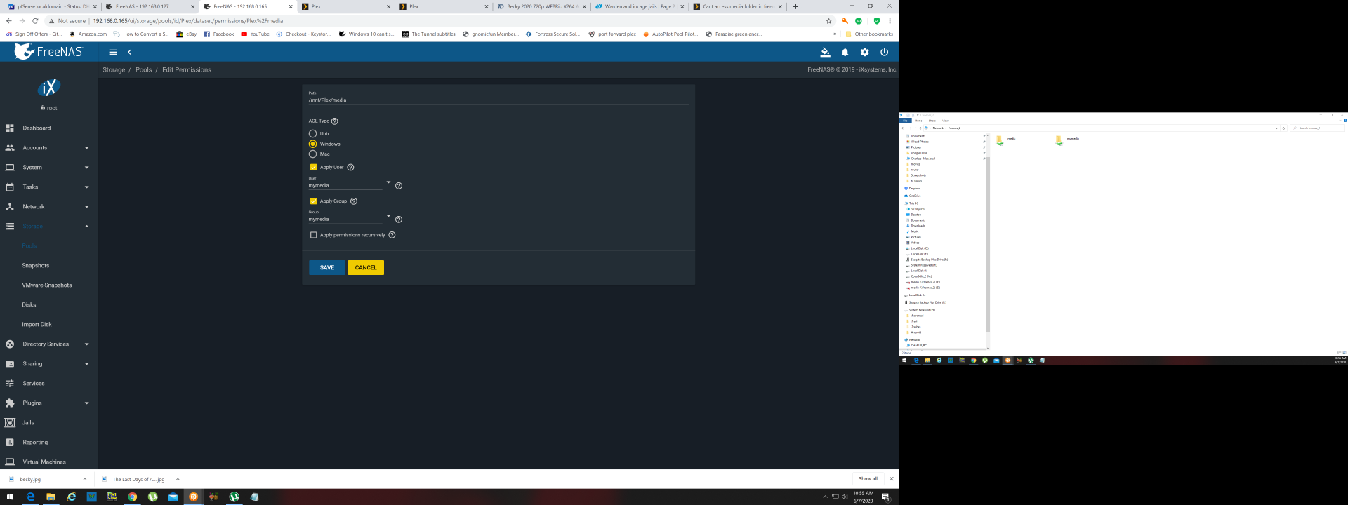

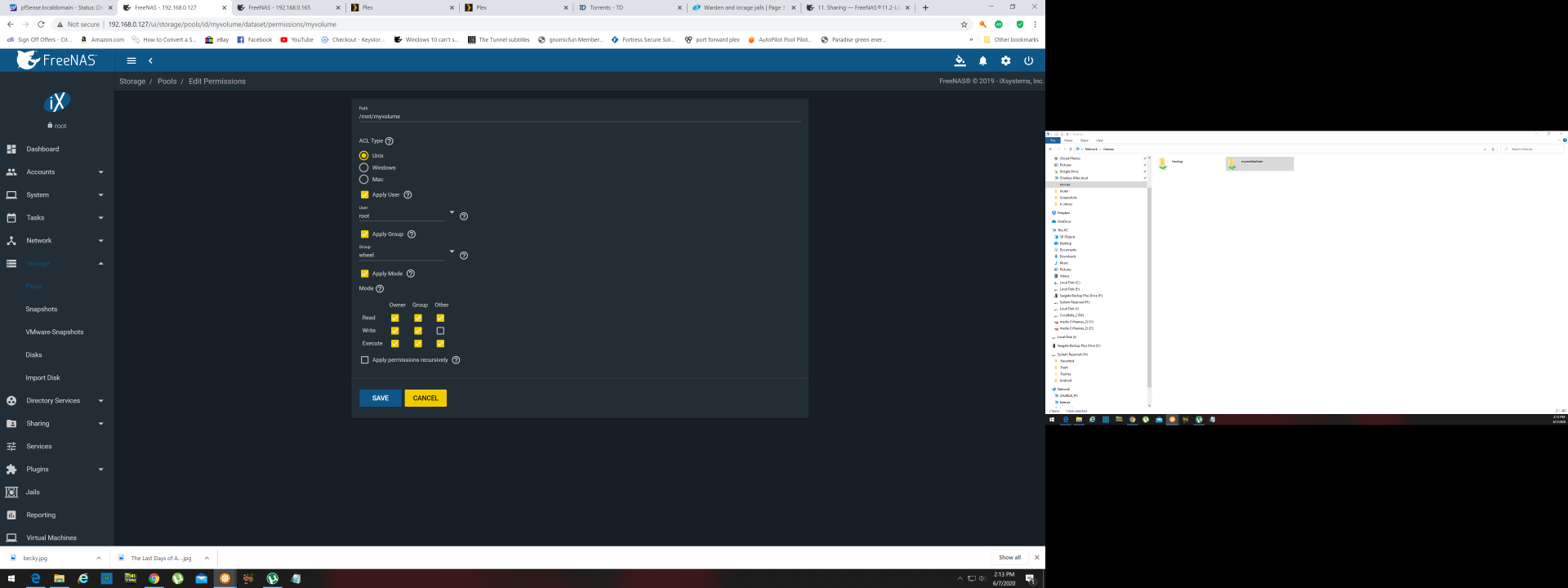

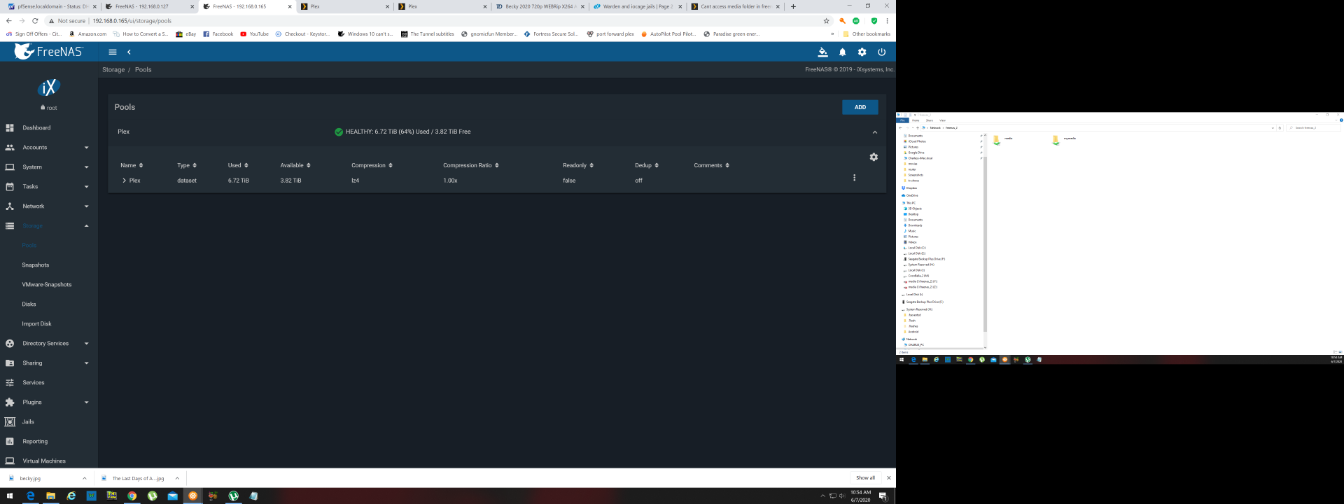

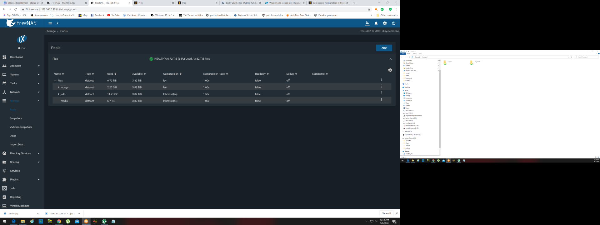

i was following the guide for freenas and i accidently changed something on my pool in permissions in my movie server, and now ican't access my movie folder, I thought I was in my TV server
Samuel Tai
Apr 24, 2020
5,399
Built-in accounts are those that were installed with the OS. Leave that check box alone.

ok, but I still need to figure out what I did to movie server. As I said I accidentally edited myvolume folder thinking I was in my tv server. I am trying to change back what I messed up, but still not working. When I originnaly set up my pool I followed FreeNAS 9 1 1 Plex Media Server Pluggin video. The only thing that I did to permissions to Myvolume pool was to check write box under other and set permissions recursively and hit save.

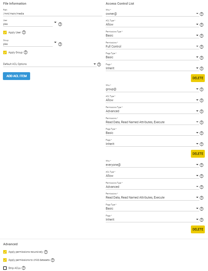

Here's a quick & dirty guide to creating a guest share.
  1. Assuming your media folder is owned by user plex, group plex (change as necessary for your own system), set the following Auxiliary parameters in the SMB service:
  2. Create a share pointing to your media folder. Make sure the Allow Guest Access and Only Allow Guest Access boxes are checked.
  3. For the media folder, set these ACLs recursively:
  4. Restart the SMB service.
Samuel Tai
Apr 24, 2020
5,399
Given your difficulties, FreeNAS may be too much for you. You may want to look at Synology, which can also run Plex.

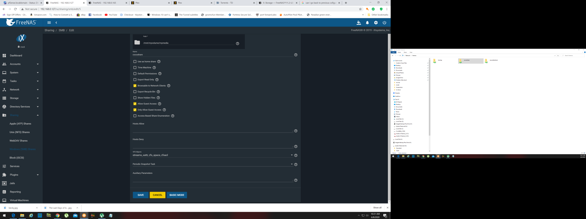

I tried your suggestion, Created share, showed up in explorer. Still no access. my frrenas computers have a lot invested. I should have stayed with warden, never had a problem. I have had this setup for about 7 years
Samuel Tai
Apr 24, 2020
5,399

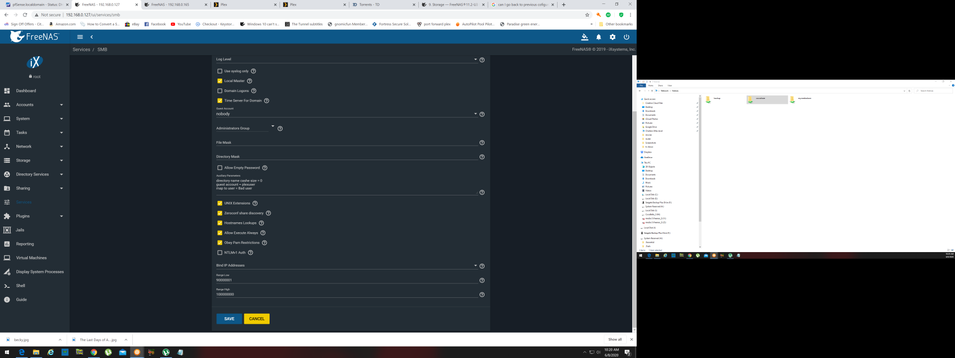

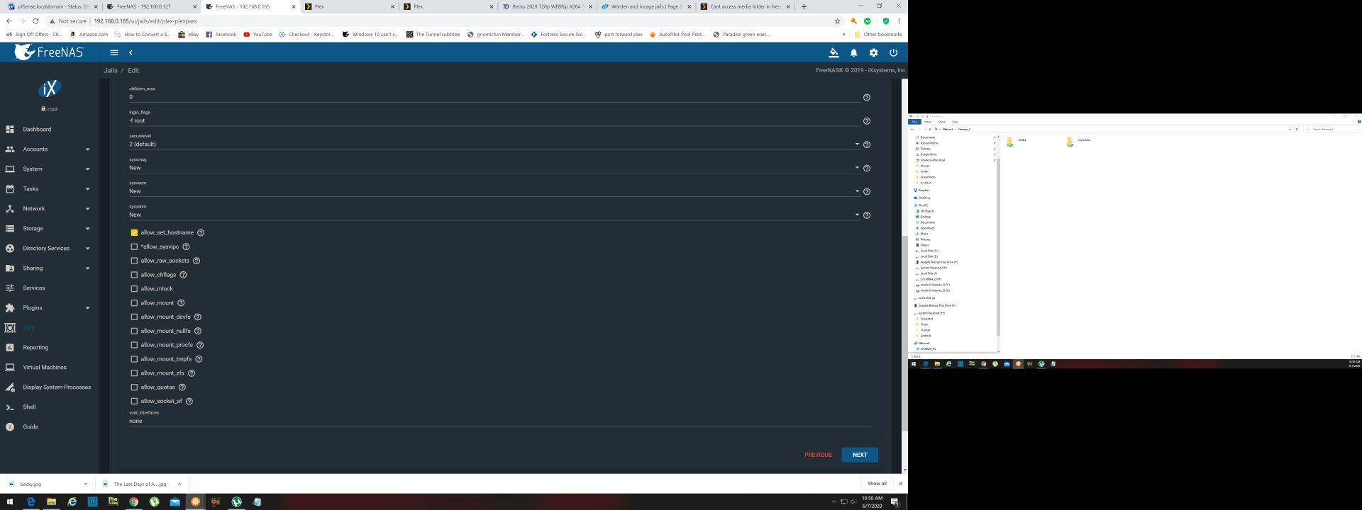

That recipe works on my FreeNAS system. Can you screen shot the configuration of your SMB service and your share?
sakn54
Jan 19, 2014
48
here it is
