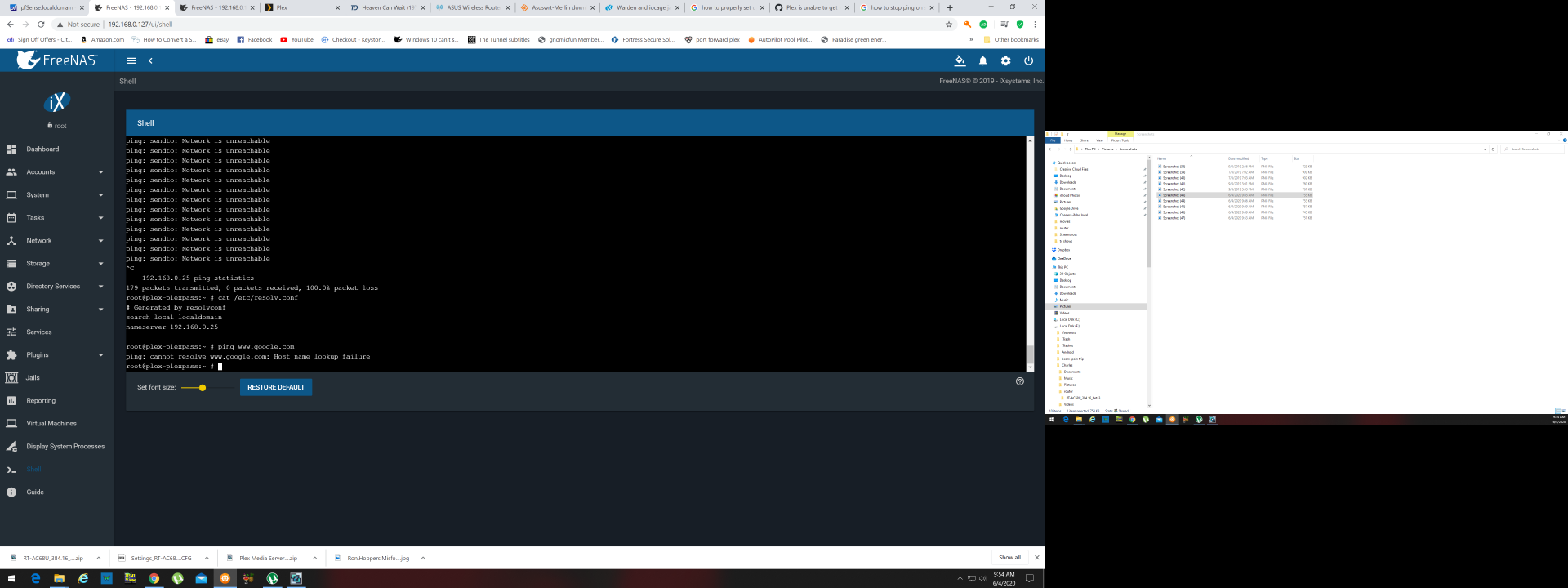

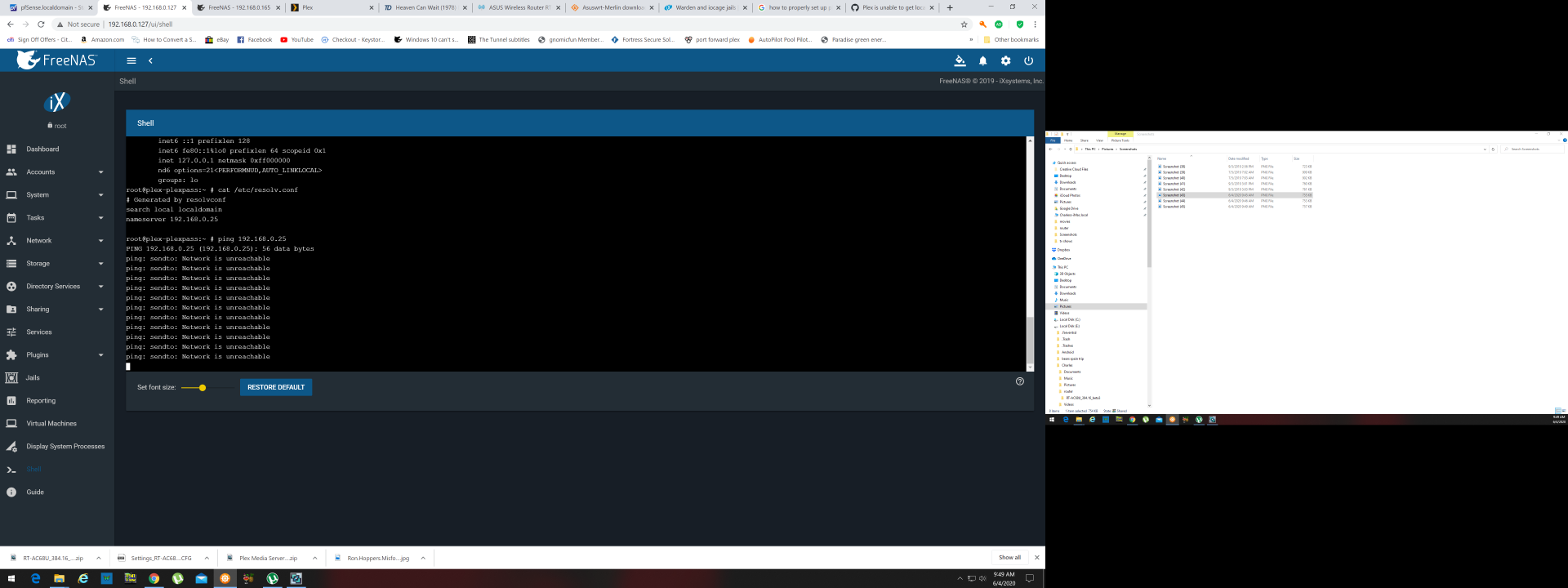

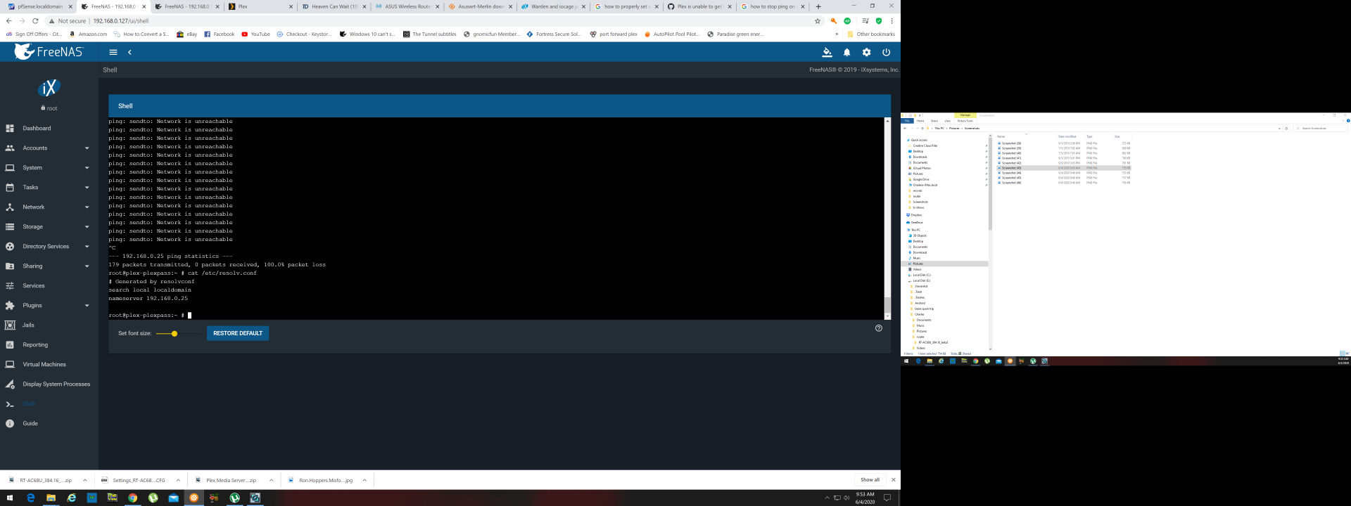

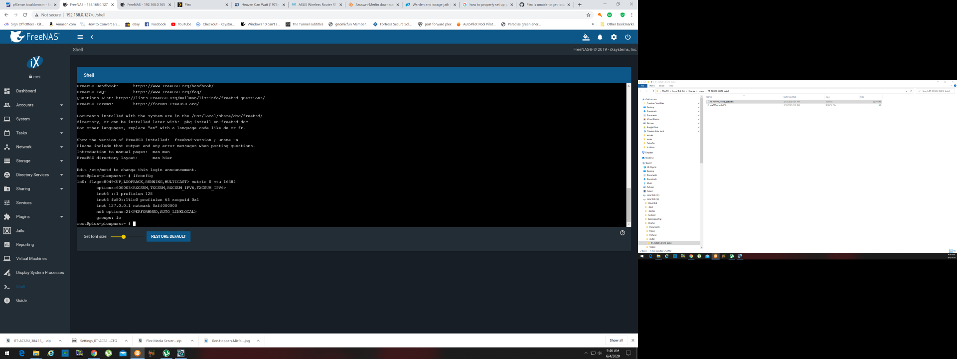

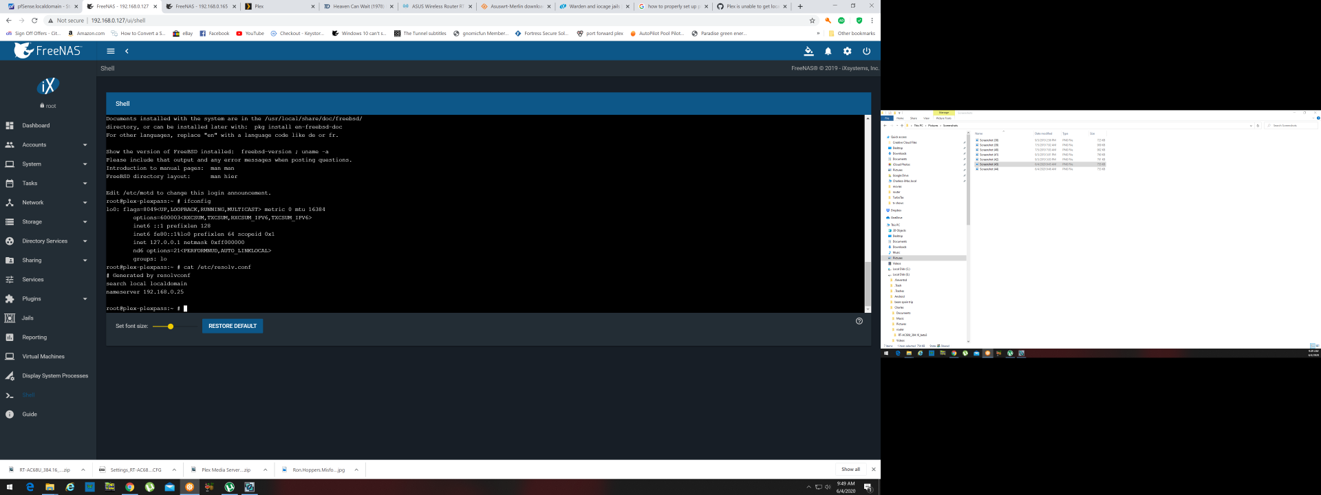

sakn54
Jan 19, 2014
48
i am attaching screen shots. I hope this helps.

Patrick M. Hausen
Nov 25, 2013
7,776
Ssh into your box, copy and paste text, please. Screenshots are useless ...
That was point 2. of my list.
I don't get what is so hard about this. You complained and sought help that your jail was not working with VNET. I am trying to help. For that I need very specific information about your system when the jail is active with VNET. Please just follow the steps I outlined in (as I see it) great detail and post the results.
sakn54
Jan 19, 2014
48
I appologize, I am just a dabbler ruuning my server for plex so my family can watch from anywhere. I decided to edit my jail for dhcp instead of static ip with vnet and berkly checked. Plex sees my server and is now downlading all metadata. Thank you for your help.
