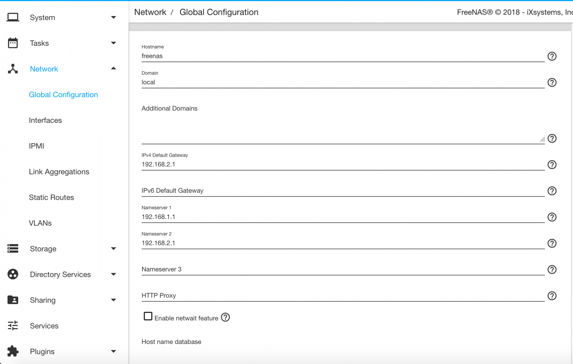

Oh yes i remember having this problem all too well. Even if your FreeNas is using DHCP, i had to manually set gateway and dns settings in Network-->Global configuration and then reboot my FreeNas host. I remember i found that being necessary because the VNET virtual adapter uses the global values.
Do you have more than one interface connected/configured on FreeNas?
***EDIT: I have two subnets on my local network. Your gateway and namesever1 should most likely be identical
