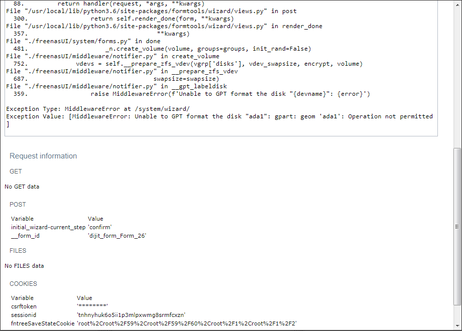

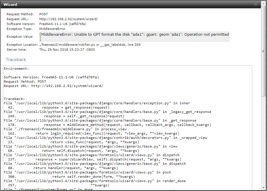

I've been fighting this issue for a few days now, I've gone through a few things here on the site, reinstalled different versions and re-downloaded isos to insure integrity and compatibility and stableness. the one thing I can't get through on all installation in making a volume, I've wiped the drive with a third party linux program, and at this point am at a loss. any help would be appreciated, hopefully I'm just missing something simple.

You could try setting:
sysctl -w kern.geom.debugflags=0x10
Then after trying the wipe in the GUI again, set it back to 0

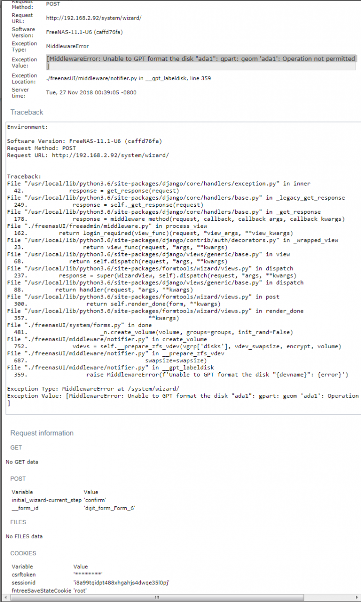

DocOkt
Nov 23, 2018
6
no dice... retried all listed steps :S
wasn't getting the error everytime i load a page
