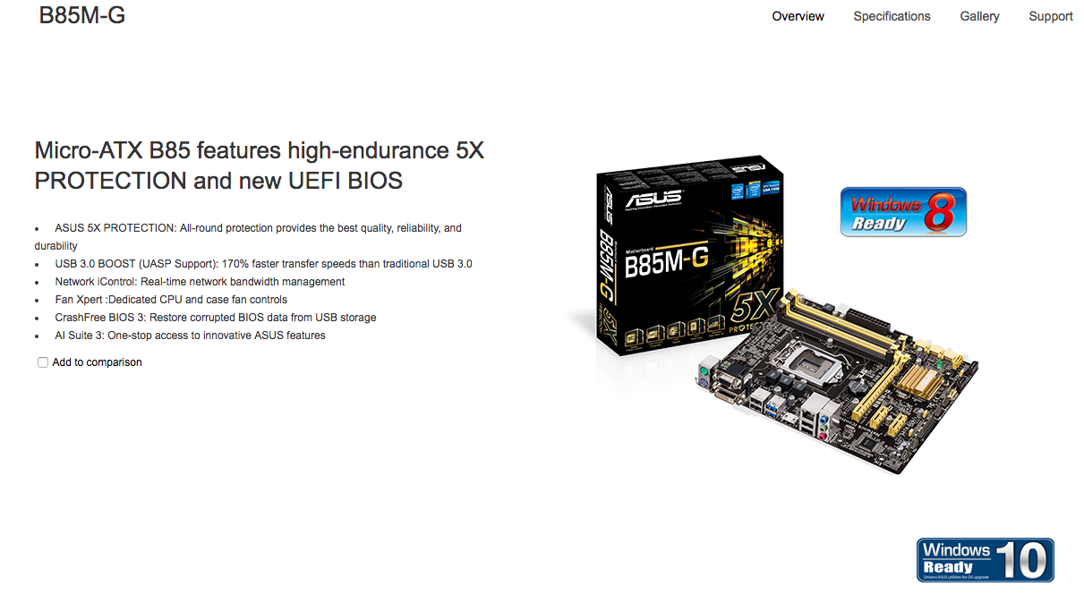

Yeahhhhh.. I said after the install, the freenas system booted fine. How could it do that over EFI if the board didn't support EFI? After a successful boot after the initial install, THEN I ran the updater from within freenas. THAT broke my booting.
Also, here's the linked motherboard product page, which seems to indicate that EFI is.. like.. a thing.
