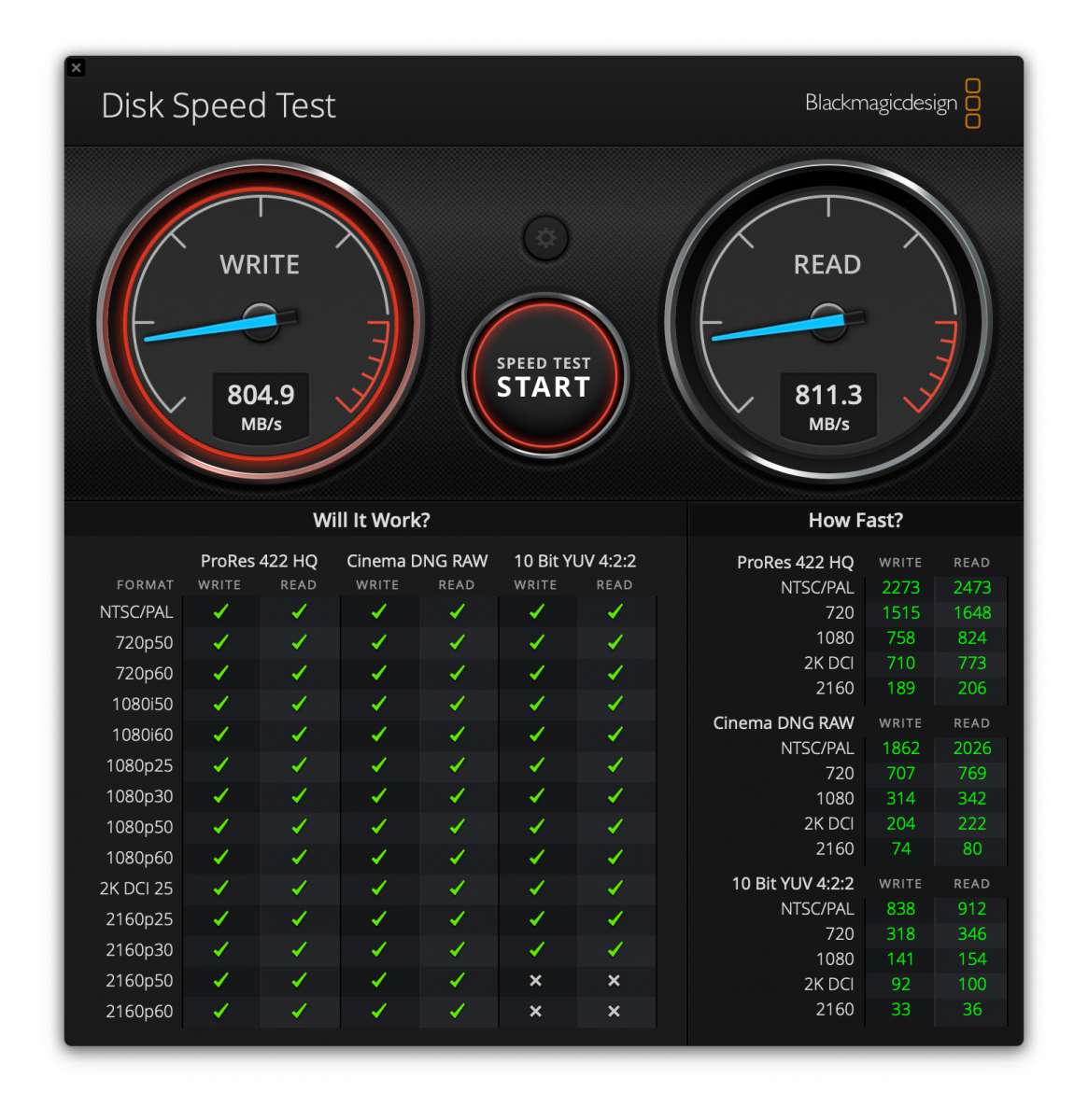

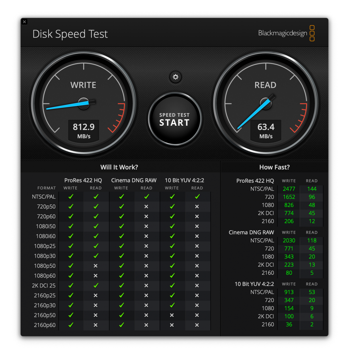

SMB read performance over 10G has taken a huge dive after updating from 11.3-U5 to 12. Write performance remains the same. Anyone else experiencing this, know how to fix? Using MTU 9000 on both server and client.
UPDATE: You can read all the testing I did below, but have since had to roll back to 11.3-U5 to resolve this issue.

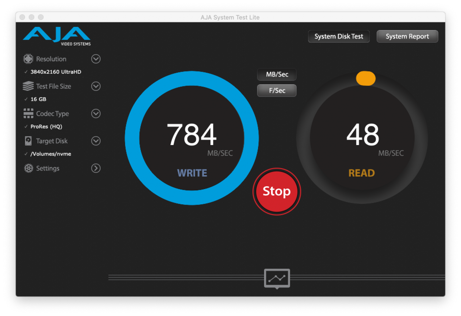

Even my USB 1G NIC is faster for reads. I tested another TB3 10G NIC I have, based on the Aquantia AQC107(not-B0) chipset, and it has the same problem reading from SMB on TrueNAS 12.
Using the same computer for all of these benchmarks in the screenshots. The SMB share is stored on a Samsung EVO 970 NVMe drive capable of speeds over 3,000MB/s

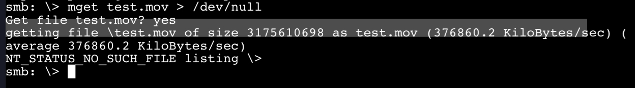

How is performance over SMB if read is over loopback?
smbclient //127.0.0.1/<SHARE> -U <your user>
Once you have the SMB prompt, run "get large_file /dev/null"

Seems normal there, but like I said, it's the SMB connection on our clients that is slow
getting file \centos8.iso of size 7554990080 as /dev/null (1741307.5 KiloBytes/sec) (average 1741307.5 KiloBytes/sec)

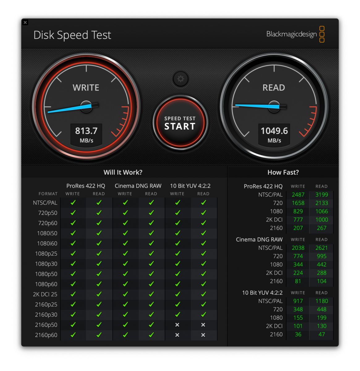

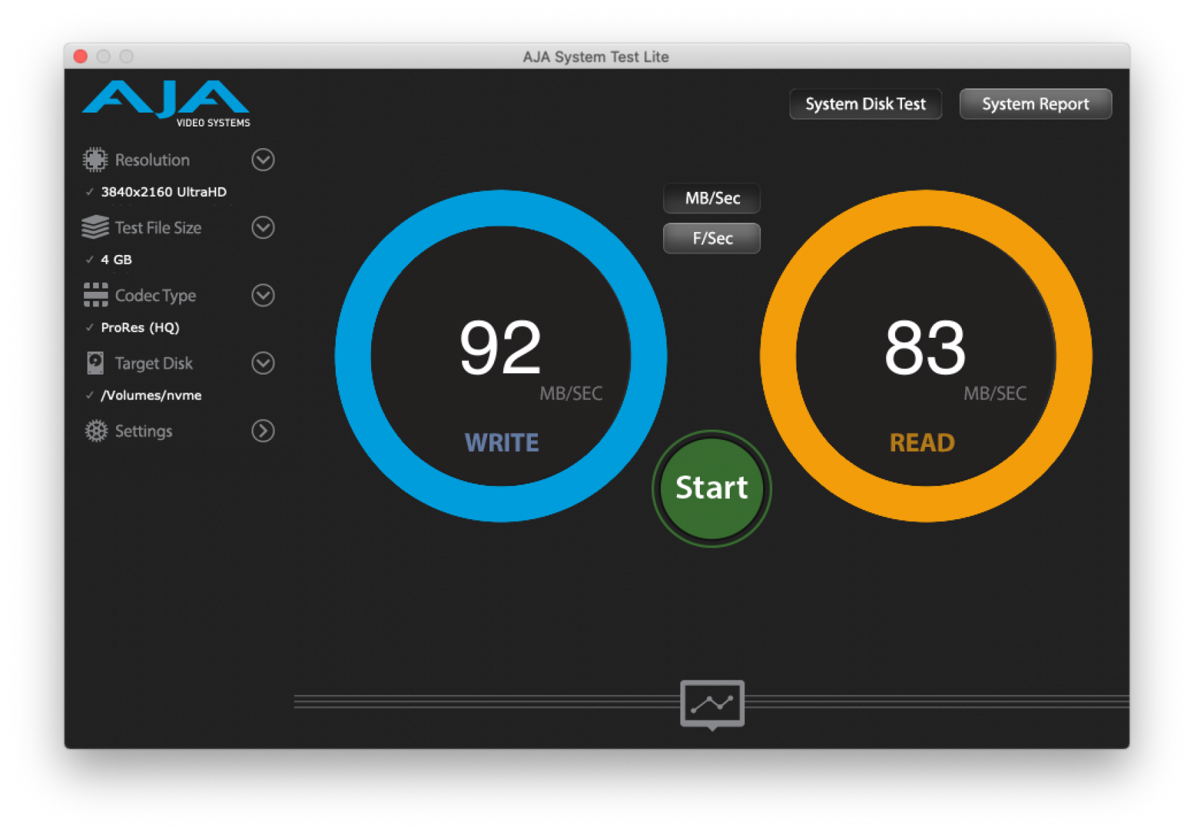

Appears to be related to using Jumbo frames at MTU 9000
If I have MTU 9000 configured on the server/client , the write speeds are around 800MB/s, reads about 29MB/s. If I configure them both to MTU 1500, then I get about 430MB/s write and 330MB/s read.
Are Jumbo Frames broken on TrueNAS 12? I'm not a networking expert, but my tests seem to indicate that. I had previously tuned the frame size for performance on FreeNAS 11.3-U5 and earlier, but those settings are not working well any longer.
lonelyzinc
Aug 8, 2019
35
After thoroughly testing speeds using MTU 9000/1500 and 5 different models of TB2/TB3 10G NICs over 4 different Macs -- have decided to go back to FreeNAS 11.3-U5. Fortunately, for my own sanity, it performs the same way I remember it -- very fast read/write over SMB using MTU 9000.
Hopefully others will flag this TrueNAS 12.0 problem down too. Not sure what it is about my setup that deserves this on the initial release. Just a basic SMB share and 10G NICs using MTU 9000.

Anecdotally, since it's not my ticket, affected users have reported speed issues with multiple services (iSCSI, SMB, NFS, AFP). So likely not in the SMB service itself. You can try local transfers over loopback `smbclient //127.0.0.1/<SHARE> -U <smbuser>%<password>` then 'mget <large_file> > /dev/null' to isolate somewhat from your local network / NICs.
edit: sorry, noticed I already posted something like that here
robinmorgan
Jan 8, 2020
36
I’ve tried this! Thank you... this is what I got but not sure if its good or bad news?

lonelyzinc
Aug 8, 2019
35
lonelyzinc
Aug 8, 2019
35
Actually, it's the fastest I've ever seen!! Never went above 800s for read on 11.3
