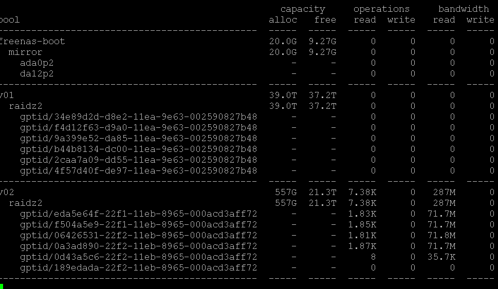

Thought I would do another copy from v02 to my PC and see how it does, as you can see, its only reading from 4 disks like v01.. but its reading at the full 280MB/s in total..

I'm just throwing this out there for now, when reading a RAIDZ2 vdev, two of the drives are parity in essence. Maybe you are seeing the parity as the slow drives? I haven't dealt with it before but it's possible that is your cause but I don't want to commit to it. I'd just be surprised parity would be pulled form the same two drives that often where you could obviously see it.
Your hard drives speeds are respectable so I don't see this being an issue.
As for your transfer speeds, well I'm not sure why your copy speed is so different between the V01 and V02 to your PC. All I can think about is the 4TB drives have a slower access rate to data. I think you have already isolated this issue to your 4TB drives having a slower access speed. You did not provide the drive models which would be helpful to provide some intelligent feedback.
Also you did not provide all the results of your "fio" test, part of those results also indicate IOPS which is where I feel you might be slowing down at. How about changing your test to this, see how it works out and then report all the output once the test has completed, it's quite a bit of data.

I don't think the 14TB drives are physically the issue, they should be more then performant enough and they can clearly read and write very fast internally on the server between pools. That said, I installed them one by one by doing a replace on the older 8TB drives I had in the pool. So it rebuilt the volume 1 by 1 and then expanded to the new volume size at the end... maybe that had something.. although the slow speeds occur even with new files copied or created there, its not like its just old files...
It just seems so strange internal read/writes are fine, yet as soon as you bring the nic into the mix and try to copy out of the server, v01 is slow.. yet v02 is just fine doing the same. Its like v01 and the nic fight for resources yet v02 and the nic don't, and they are all connected by the same HBA and SAS expander... drives me nuts trying to wrap my head around this one...
I am trying to do your test on v01 on my main server, getting very slow results, not to mention it saying it will take 2 days to run.. is this what you saw on your server?
I halted the tests as obviously it would take day's to finish but here are the results...

Out of curiousity now, I rebuilt the pool just as a simple stripe array, no parity. here are the results,
seqread: (g=0): rw=read, bs=(R) 128KiB-128KiB, (W) 128KiB-128KiB, (T) 128KiB-128KiB, ioengine=psync, iodepth=32
fio-3.19
Starting 1 process
seqread: Laying out IO file (1 file / 131072MiB)
Jobs: 1 (f=1): [R(1)][99.6%][r=472MiB/s][r=3774 IOPS][eta 00m:01s]
seqread: (groupid=0, jobs=1): err= 0: pid=49364: Tue Nov 10 18:27:58 2020
  read: IOPS=3694, BW=462MiB/s (484MB/s)(128GiB/283806msec)

The strangest part.. even like this my copy speeds from the server to my PC are still slow, averaging 150MB/s!!! What the hell is going on here...

Here is some iostat data from just 1 drive in a pool,
read
v01                                              128G  12.6T    282      0   253M      0
  gptid/1708f1f7-23b0-11eb-8965-000acd3aff72     128G  12.6T    282      0   253M      0
write
v01                                              114G  12.6T      0    250      0   250M
  gptid/1708f1f7-23b0-11eb-8965-000acd3aff72     114G  12.6T      0    250      0   250M

So looks like each drive should be capable for roughly 250MB/s R/W which seems right.
but
Again when copying to my PC speeds bounced all over the place and struggled to get to 200MB/s
Last thing I can try is moving these drives to my Backup NAS, ill remove the drives from that one and try these drives in there and see what happens. Then I can rule out the server hardware 100%, if the drives are slow in there then I know its these drives and they just don't work well....

Well tried to put the 6 14TB drives in my backup NAS... the server wouldn’t even detect the drives. The board has an integrated LSI 2308 controller which has worked fine obviously with my 8TB drives. But this aren’t even being detected, tried the built in SATA ports too, nothing... I am beginning to think these WD Ultrastar 14 TB disk drives are CRAP! I might try ordering another couple off Amazon to see if they work any better, as of right now I am just out of things to try :(

Also you are using sequential testing which is not real world, you should be testing using random patterns. Your last fio test results looked great but they are not reality when you are transferring files. The only think I can think of is that I agree with you, those 14TB drives are the issue.
Kuro Houou
Jun 17, 2014
193
Try configuring the pool to use mirrors instead of raidz-2 as a test
Mirror volume shows the same performance..
Kuro Houou
Jun 17, 2014
193
I think the fio tests are fairly accurate actually. The single drive test showed R/W at around 250MB/s, which is close to manufacturer specs. The read speed from just V01 during the v01 test was pretty close to the read speed when copying from v01 to v02. It's just that when I read from v01 to an external device (in this case over ethernet) speeds drop. Doing the same copy with v02 over ethernet works fine oddly enough though. I have no idea whey these 14TB drives don't like copying over ethernet.. maybe something to do with the way the disk is read and then encapsulated for transit over IP.. who knows... but the fact that they have that issue and my backup nas can't even detect the drives leads me to believe they are not working as they should. I'll have 3 new different brand 14TB drives to test hopefully Friday. If those work then its really the final nail in the coffin that its the disks once and for all.

Well I finally figured out why these WD HC530 drives couldn't be detected in my backup NAS... apparently they have what's called a power disable "feature" that prevents them from booting on some hardware (http://web.archive.org/web/20161121...files/resources/HGST-Power-Disable-Pin-TB.pdf)
Should have read the reviews more carefully on Amazon (https://www.amazon.com/gp/customer-...f=cm_cr_arp_d_rvw_ttl?ie=UTF8&ASIN=B07KPL474H)
Once I solved that issue I got to testing the drives in my backup server. I built a 3x14TB stripe array for max performance, again writes easily hit 2.5Gbps (280MB/s)... but reads came crashing down again. I tried the drives on both the built in LSI 2308 and built in SATA ports. the LSI was better then the built in SATA ports, but still showed very similar results as in the Main Server. It could not maintain 280MB/s reads at all, constantly dipping down below 100 only to pop back up again.
At this point its 1 of 2 things.
1. The WD HC530 drives just suck
or
2. When reading data and sending over the X550 nic there is some sort of bottleneck/conflict and speeds tank.
The only thing that I could possibly try would be to get a more modern server with newer hardware that maybe better supports larger drives? Half tempted to order one just so I find out for sure. The fact that the seagate drives do seem to perform better though makes me think this won't matter though.
Wow, I recall when this came out, it was a pain in the rear and I had to use a power adapter to make my drives work. If forget the drive model I had, it seamed like forever ago. I eventually replaced the power supply (gave me an excuse to upgrade). So it's not a terribly expensive fix and then I retained the power supply for other projects and I'm sure it's in the garage just waiting to be used as a test subject.
What versions of FreeNAS/TrueNAS have you tried? Someone else I was working with has a significant difference between FreeNAS 11.3-U5 and TrueNAS 12.0-Release. They should have submitted a bug report by now and rolled back to FreeNAS 11.3-U5 to restore performance. Mind you that they also had high speed ethernet so they were able to see the problem. I could not verify the problem as I only have 1Gbps Ethernet. Unfortunately this person had updated their pools to the new ZFS so they had to backup all the data and destroy the pool and recreate it under FreeNAS 11.3-U5, then restore the data. I cautioned them to never update the ZFS pool unless you absolutely need to.
Good luck.

SOLVED:
Thanks joeschmuck for making me think about going back to 11.3 u5, I should have done this first but I didn't and what a rabbit hole I went down!! .. I installed FreeNAS 11.3 u5. Ran the same tests and low and behold all performance restored...
Starting 1 process
Jobs: 1 (f=1): [R(1)][100.0%][r=639MiB/s][r=5111 IOPS][eta 00m:00s]
seqread: (groupid=0, jobs=1): err= 0: pid=3330: Tue Nov 17 05:56:45 2020
  read: IOPS=5034, BW=629MiB/s (660MB/s)(128GiB/208285msec)
    clat (usec): min=41, max=428836, avg=197.01, stdev=1857.81
     lat (usec): min=42, max=428837, avg=197.19, stdev=1857.81
    clat percentiles (usec):
     |  1.00th=[   59],  5.00th=[   61], 10.00th=[   63], 20.00th=[   66],
     | 30.00th=[   73], 40.00th=[   76], 50.00th=[   79], 60.00th=[   82],
     | 70.00th=[   87], 80.00th=[   92], 90.00th=[   98], 95.00th=[  120],
     | 99.00th=[ 1975], 99.50th=[ 3261], 99.90th=[25560], 99.95th=[43779],
     | 99.99th=[65274]
   bw (  KiB/s): min=82011, max=1043672, per=99.49%, avg=641078.63, stdev=269007.58, samples=416
   iops        : min=  640, max= 8153, avg=5008.00, stdev=2101.60, samples=416
  lat (usec)   : 50=0.01%, 100=91.35%, 250=5.20%, 500=0.49%, 750=0.27%
  lat (usec)   : 1000=0.32%
  lat (msec)   : 2=1.38%, 4=0.55%, 10=0.21%, 20=0.09%, 50=0.09%
  lat (msec)   : 100=0.03%, 250=0.01%, 500=0.01%
  cpu          : usr=1.11%, sys=39.82%, ctx=33691, majf=0, minf=32
  IO depths    : 1=100.0%, 2=0.0%, 4=0.0%, 8=0.0%, 16=0.0%, 32=0.0%, >=64=0.0%
     submit    : 0=0.0%, 4=100.0%, 8=0.0%, 16=0.0%, 32=0.0%, 64=0.0%, >=64=0.0%
     complete  : 0=0.0%, 4=100.0%, 8=0.0%, 16=0.0%, 32=0.0%, 64=0.0%, >=64=0.0%
     issued rwts: total=1048576,0,0,0 short=0,0,0,0 dropped=0,0,0,0
     latency   : target=0, window=0, percentile=100.00%, depth=32
Run status group 0 (all jobs):
   READ: bw=629MiB/s (660MB/s), 629MiB/s-629MiB/s (660MB/s-660MB/s), io=128GiB (137GB), run=208285-208285msec
Much faster read speeds on the system itself and A LOT more IOPS. So it looks like FreeNAS 12 is just broken. Searching on this topic of "FreeNAS 12 slow read speeds" has also confirmed many others with the same issues. Oddly enough it still only reads from 4 disks at a time, but I am not complaining too much right now, just kicking myself for not thinking it could have been the software update.
I am still going to do a server upgrade with 10Gbe nics for two reasons.
1. Aggregating the two ports on my 2.5Gbe nic doesn't work (x550 chip limitation it seems), I need link aggregation or when multiple computers on the network are reading they would have a max total read speed of only 2.5Gbps which is not good. With the 10Gbe nic in the new server I should be able to have at least 2 PC's hitting 2.5Gbps plus a little extra head room I think.
2. Since I had to blow away my Main servers disk pool during this process and I have to do a complete rebuild, might as well use this down time to do a hardware upgrade that will last me the next 4-5 years at least (fingers crossed).
Again, thanks joeschmuck for sticking through all this with me and finally making me realize to try 11.3 again.. the fact that I did an upgrade to 12 the week before putting in the 2.5Gbps nic and didn't see any issues PLUS My backup NAS had no issues at 2.5Gbps really made me think it couldn't be the OS version. Something about TrueNas 12 AND my Main server hardware must be the issue. I may continue to play around until my new hardware comes to see if I can help the community out in tracking down the specific issue while I have some time.. but we can consider this problem solved and fully resolved hopefully in a future TrueNAS 12 release.
