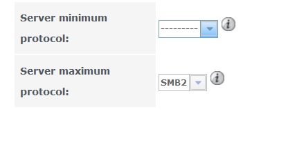

Default protocol for Samba (ver. 9.3)
I guess the Minimum Protocol could be the cause, is that true?
For CIFS, you shouldn't stray from default IIRC
