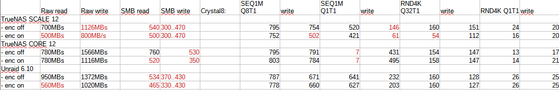

for me SCALE is slower than CORE on barebone in every metric
------------------------ SCALE ----------------------- CORE -------------
encryption=off [R W]: 700MBs 1126MBs 780MBs 1566MBs
encryption=on [R W]: 500MBs 800MB/s 780MBs 1116MBs
* worse raw ZFS speeds, both both don't achieve normal NVME read speeds
* big penalty for native encryption
* slower samba, very slow writes in both: SCALE [R W}: 500 200 CORE [R W]: 520 350
* slow RAIDZ on HDD, read speed = one drive speed unless given boost via prefetch tunable
* slower iperf
SCALE has better UI (finally can click on a table row instead of the tiny arrow!!!) and less "fundamentalist attitude", but tons of bugs. CORE more mature but can't connect my external drives which is a showstopper. Hard to choose any at this point.

here's what i've learned by tripple execution of metrics above with proper cache flushing:
* ZFS itself kills NVME performance even with "good settings". direct reads are far from NVME max. The same box produced higher values in the past, FreeNAS 11, OMV5, DSM all read and wrote >1000MBs EVEN on (zfs) encrypted pools. Don't know what happened, because algorithms get faster in time, and indeed the openssl / cryptsetup benchmarks are now faster, while ZFS got slower (tho not to pathetic zfs0.83 levels). Maybe Linux maintainers still fighting ZFS?
* Samba cuts another chunk. With hundreds of tweaks, RSS, multichannel i didn't achieve any improvement. For single user, speeds won't saturate NIC except for DSM and CORE and is stuck at using just one thread each time launched for the specific user.
* Native encryption cuts another chunk, and bit more than expected (-20%, -30%, -40%), and it will multithread but won't saturate CPU fully. I've noticed DSM made the machine way noisier, but all the base benchmarks are the same and cpu scaling works. Even with some special hacks, like disable BIOS limits, i couldn't make the machine be aggressive and noisy like under DSM. Interesting. The only difference I know of is DSM was running in legacy instead of UEFI.
* when ARC cache is utilized (e.g. after repeated copy), it saturates NIC fully in single thread, no I/O happens
Also: SCALE is the least performant NAS tested historically, while CORE is strong, beating another Linux based distro Unraid and on par with old kernel DSM.
* Sad thing is Synology DSM, for some reason, is on the top despite file based encryption plus BTRFS. All others use ZFS. I have some old notes with DSM and OMV, the table display only the latest crop - same pools, same files used in one day.
* SCALE autotune is ineffective - it refers to BSD nonexistant settings. When added manually, the only value that "worked" was prefetch that normalized sad 4xHDD RAIDZ1 read value from 1*disk to 2*disk (200MBs->400MBs). Damn, shouldn't it be 3*disk? 4xHDD at single disk speed, that reminds me of this test, see glitch at 4x 4TB -> r=183MBs for SOME reason.
note: i'm capped by 6.5gbit NIC PCI3x1 (=800MBs) which impacts all numbers except raw metrics. CrystalDiskMark8 might not always work, e.g. the bogus SEQ1M values. But it shows in multi mode, the NIC gets saturated. CrystalDiskMark7 works even worse. Machine is HP Microserver Gen10 at 4000passmarks, AES enabled.
Resolution: SCALE should get to the CORE level of performance. I'm very interested in SMB single user read value "760" that CORE provides that distinguishes NVME speed from SSD.
