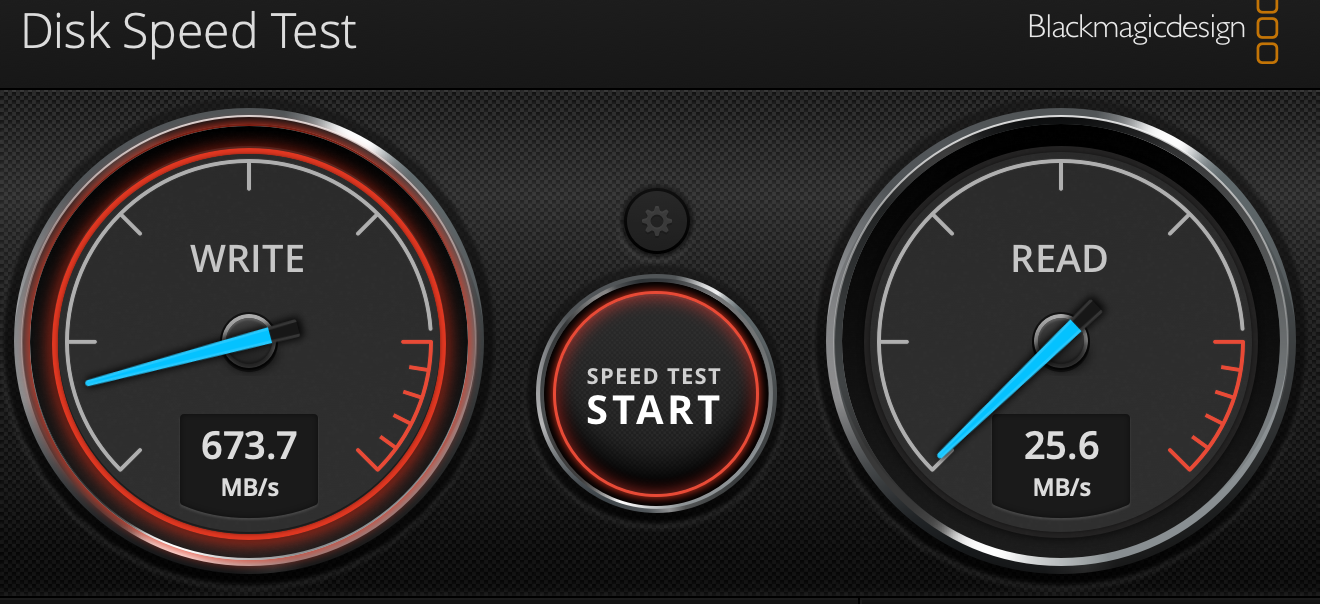

I saw @lonelyzinc 's response that this was fixed for them in 12.0-U1 so tried that after having downgraded back to 11.3-U5. Still very slow read speeds over SMB (and other services are the same, also slow) over my 10Gbe interface.
The write speed (client side write operation) is a bit slower than before but not by much, but read speed is awful.
The 1Gbps interface works as expected.
@anodos I tried the local transfer over loopback, it gets around 200MB/s on smaller files and an NT_STATUS_IO_TIMEOUT error on larger ones. Clearly that's above the 25MB/s I'm seeing on my clients though. But with the local loopback that isn't going over the 10Gbe network interface right? Only that interface has this issue.
Note that AFP is equally slow over the 10Gbe, so it's not just SMB.
