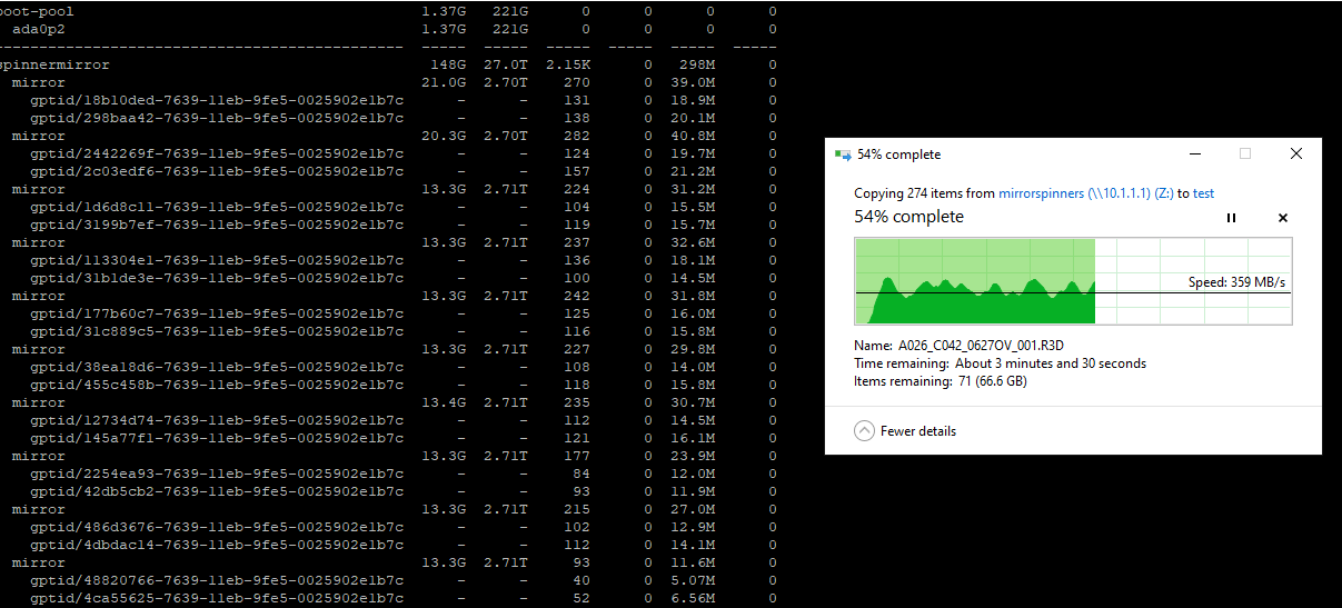

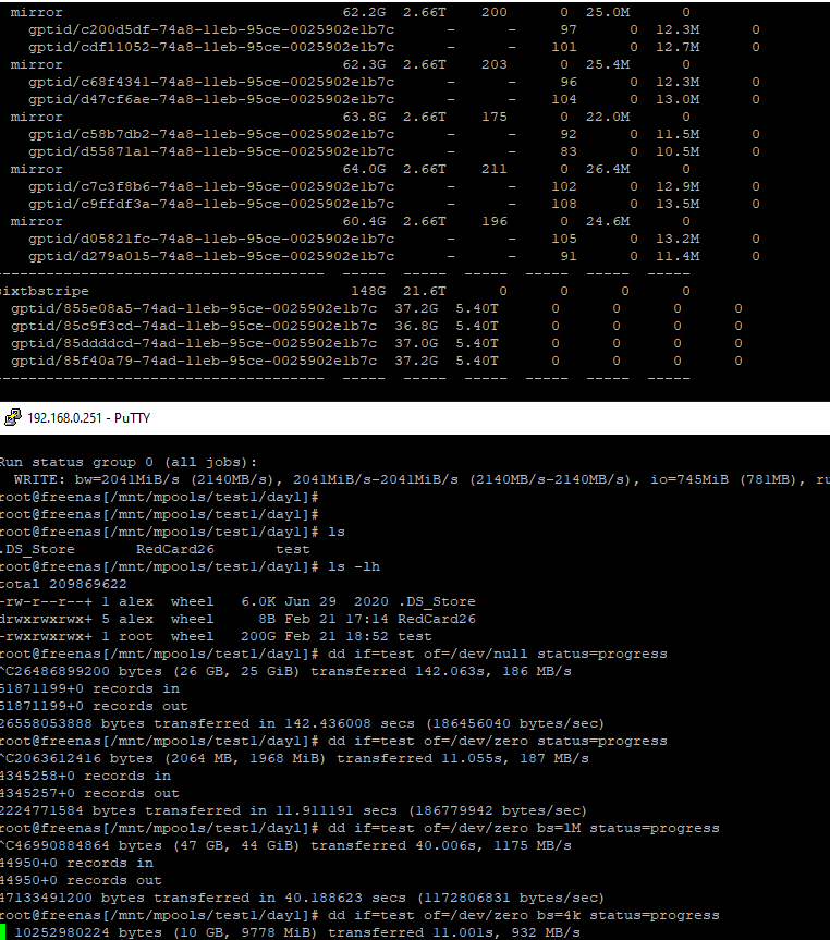

I am getting incredibly slow read speeds from magnetic drives with Truenas. Shouldn't I see better than 314-400MB/s read performance from 6vdev mirrors with a total of 12 3TB drives? I have tested different drives, The only thing that seems to not exhibit this problem are SSDs when testing with SSDs I get good read and write performance. 10gbps line rate in both directions with a single 4 drive raidz1 vdev.
I have tested different HBAs and different cables (I am using LSI 9200-16e in the pictures, but have also tested this with LSI 9206-16e) both had the same results
I have reinstalled truenas from scratch (vanilla) problem persists.
I have tested all of the drives individually with hdd sentential -- none of the drives had any issues and read and write speeds were ~140MB/s average per drive (tested all at the same time in aggregate I saw 2GB/s at peak.)

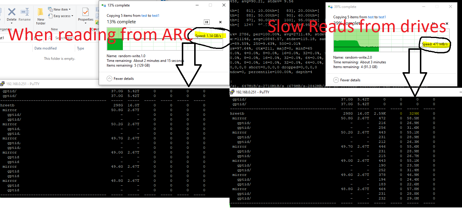

I have tested this using fio and smb. If I'm reading from ARC things are line rate 10gbps otherwise they read speeds are 1/3rd write speeds or worse.
I've created smaller pools and get about the same results read speed wise.

Read speeds:

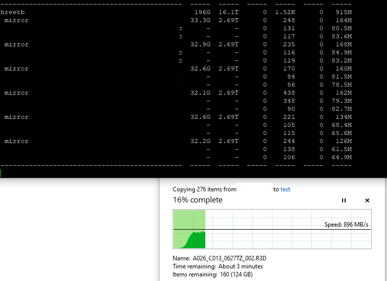

Write Speeds are fine:

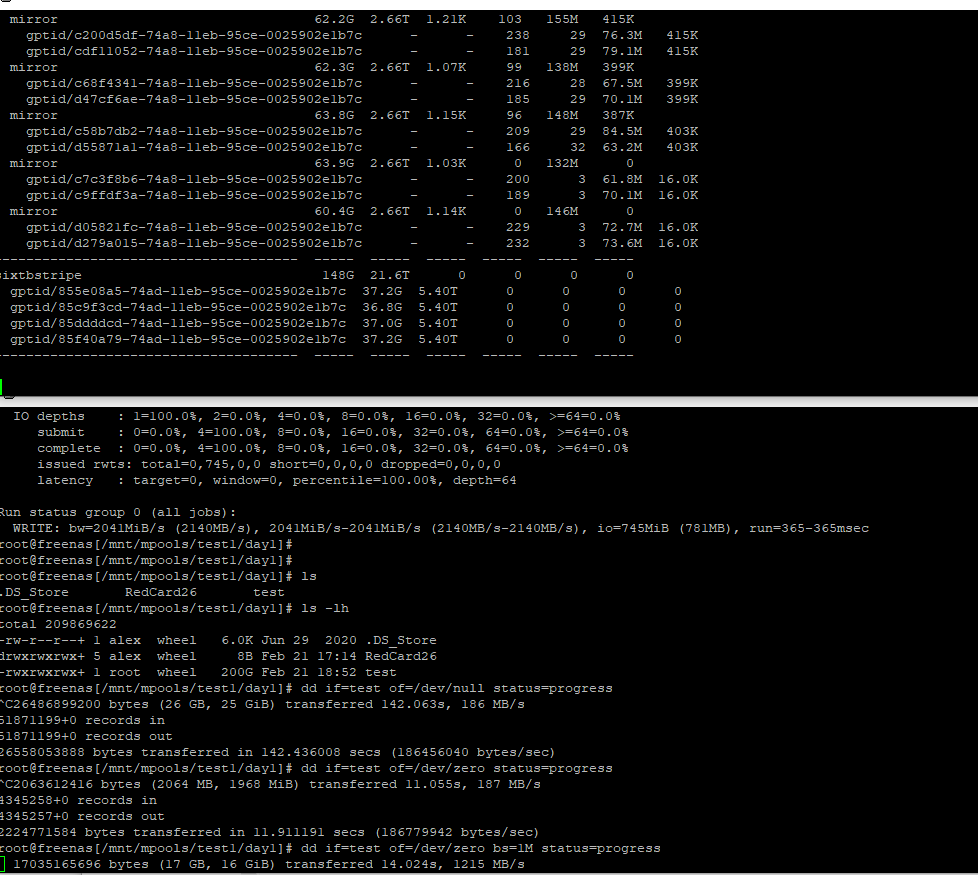

Additionally -- the copy to dev/zero seems to be as fast as i'd expect from 12 of these drives.. scrubbing is incredibly fast as well...

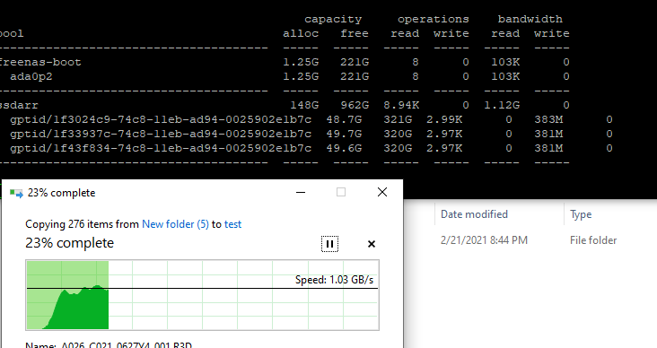

It only takes 3 SSDs to get me 1.1GB/s read and write in a stripe... It doesn't matter if i stripe or mirror these drives -- 8, 10 or 12 of the ES.3 drives only nets me 500MB/s read
9,702
With striped mirrors, you're optimized for IOPs, so with a single client, you wouldn't necessarily expect all conditions to produce the maximum possible throughput (depends which... and how many... VDEVs and underlying disks are involved in serving the requested blocks... demonstrated well by your screenshots in the first post).
If you have multiple clients seeking data from a better spread of files (which will ideally even out the IOPs across more/all of the VDEVs), you may see closer results to the SSDs in terms of overall throughput.
Don't forget, if you're comparing IOPs here, 3 SSDs (let's estimate conservatively here at 10K per device, so 30'000 IOPS with only 3 disks of spread), vs 12 HDDs (again conservatively 100 per device, so 1'200 IOPs). I suggest your bottleneck is IOPs.

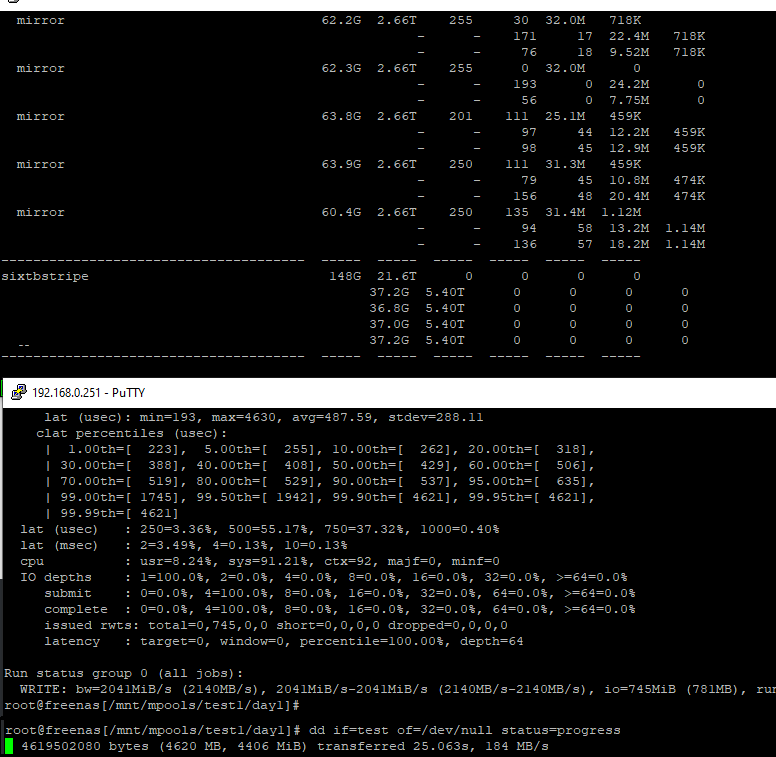

Repeated runs with the same source file /mnt/mpools1/test1/day1/test can inflate the results of the dd test because there's potentially pieces of the file in the ~128GB ARC.
Is it possible to reboot or drop caches and then immediately test with the dd command?
As @sretalla suggests I think you might be facing an IOPS/mechanical bottleneck. ES.3's are fast for spinning disks but still limited by their need to seek across the surface.

@sretalla Thanks for the reply! I think i had too high of expectations -- coupled with a few tests I did while running windows server and striping the disks with disk management using the same dataset and getting 10gbps in both directions... I dont know how to explain that result ...
alex711
Feb 21, 2021
13
Something about this just doesn't sit right with me... We are literally talking about 20 drives here -- Can someone help me understand how 10 mirrored vdevs can only produce 400MB/s-500MB/s read speeds? Why wouldn't the read speed improve at all with an additional 8 drives?
alex711
Feb 21, 2021
13
I retract my previous statement.. The single threaded nature of windows explorer for file copies is terrible and I knew that before doing these tests so shame on me. Thanks for everyone's help/input.
