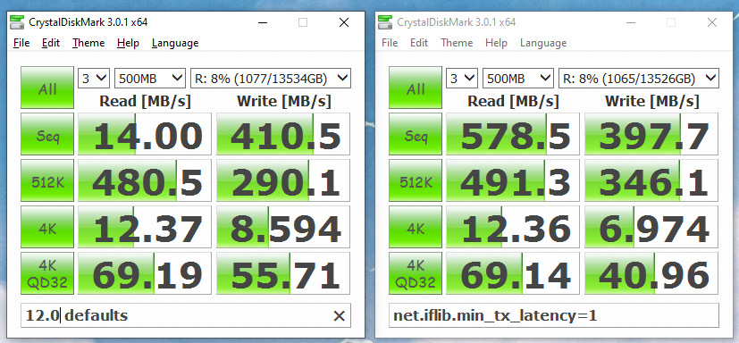

hydrosaure
Dec 15, 2020
3
Yes, that sysctl restores sequential read speeds, great find.
TallCoolOne
Oct 31, 2017
8
Hey all,
So the sysctl net.iflib.min_tx_latency=1 solution fixed the slowness for me also, now I'm seeing random and frequent disconnects. I'll bring it up in the thread related to that.
thanks!
