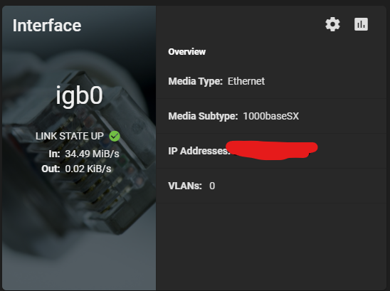

Is this represented by the traffic spike at around 1402h-1404h in the interface traffic in your second attached image?
Yes, you are correct.
What operation did you start at 1347h? It spiked up rapidly to 600Mbps and then dropped down rapidly to first about 350Mbps and then 200Mbps. Was this "before pool recreation" using RAIDZ and the latter was the same migration with a stripe pool?

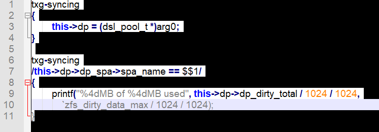

Let's leverage an old script from Adam Leventhal. Open an SSH session, use vi or nano to create a file called dirty.d and paste this text in there. You could also do it on a client system and then copy it to your pool, but you'll then need to get to that same pool directory.
txg-syncing
        this->dp = (dsl_pool_t *)arg0;
txg-syncing
/this->dp->dp_spa->spa_name == $$1/
        printf("%4dMB of %4dMB used", this->dp->dp_dirty_total / 1024 / 1024,
            `zfs_dirty_data_max / 1024 / 1024);

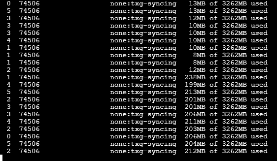

Then from a shell do dtrace -s dirty.d YourPool and wait. You'll see a bunch of lines that look like the following:
dtrace: script 'dirty.d' matched 2 probes
CPU     ID                    FUNCTION:NAME
  4  56342                 none:txg-syncing   62MB of 4096MB used
  4  56342                 none:txg-syncing   64MB of 4096MB used
  5  56342                 none:txg-syncing   64MB of 4096MB used
Start up a big copy and watch the numbers in the "X MB of Y MB used" area. If you look like you're using more than 60% of your outstanding data, you're getting write-throttled. What I expect based on your "transfer rate drops" is that X will rapidly approach Y and hang out roughly a few dozen MB's below it.

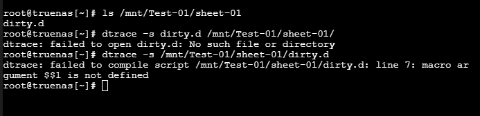

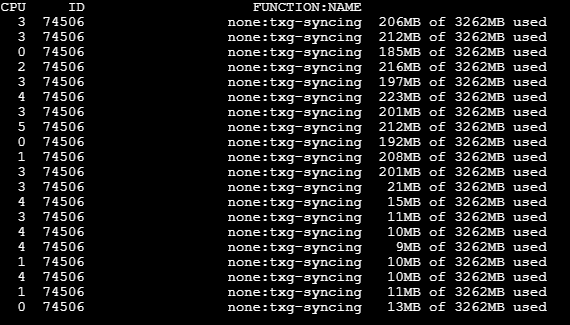

Not having much luck with this code. Just showing you what I have done and its output. Not very familiar with the FreeBSD commands.
dirty.d file
Order of operations and output.
I'm assuming there needs to be some sort of value for $$1 but not sure what is needed. Pool?
Yes, you need to supply the pool name as the variable, so assuming you've named your pool Test-01 your command would be
dtrace -s /mnt/Test-01/sheet-01/dirty.d Test-01

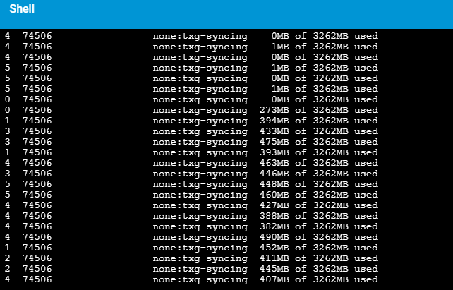

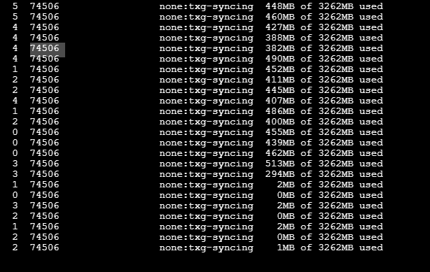

Figured it was something like that, lol. Thanks.
Here's the results. I highlighted in SS two of where I left off on the log of SS one.
513MB was the highest peek which is roughly 15% / 16% if we're rounding up.
You're nowhere near the point of the write throttle (defaults kick in at 60%) so there goes that theory. Got me a bit puzzled honestly. Is there sufficient cooling on your HBA?

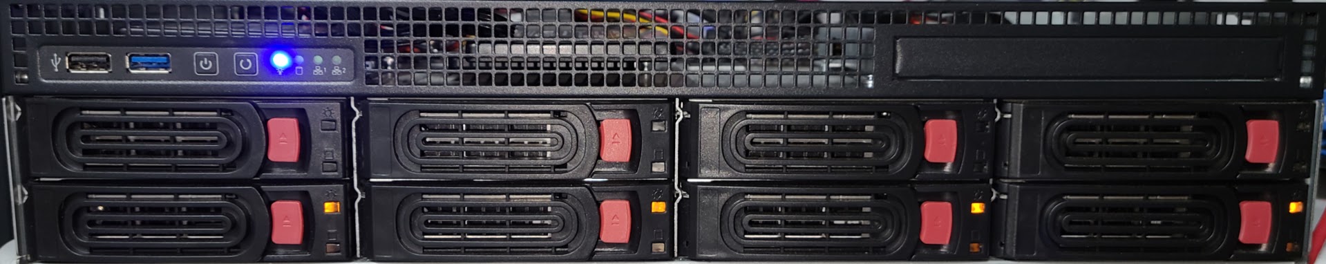

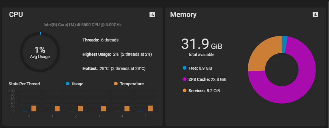

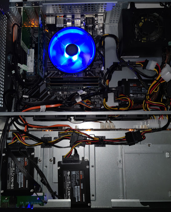

Currently sits in a basement where it is about 60F inside installed in a rack mount case that has 3, 80mm fans to remove heat off the HDDs and that heat passes over the HBA, CPU and other hardware. Those said fans have not even increased speed due to temps. I can touch the heat of the HBA and its lukewarm.
CPU is staying between 32C and 33C. Not seen it go over 5% utilization.

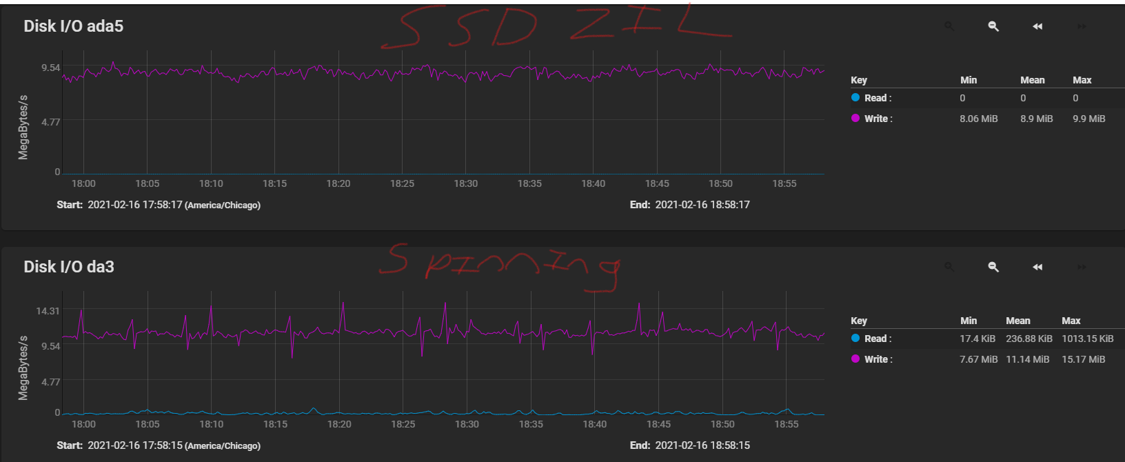

Been pushing data over to the TrueNAS and keeping an eye on the 1.8TB of ZIL and noticed the drives are writing data at the same speed as the the spinning disks. which has been around 13-16MB/s
Here are some pics of all the status at once.

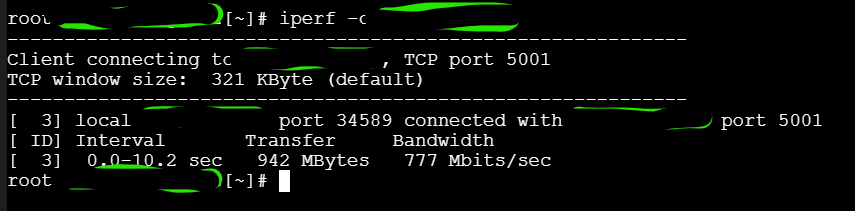

If your dd speeds are maxing out your network then it's possible the client is what is transferring the data slow. It could also be workflow, if you are transferring lots of smaller files that is going to be harder to write to the system.
TheUsD
May 17, 2013
116
iperf test between both the source and destination. Server: ReadyNAS (destination) Client: TrueNAS (Source)
I've got some data transfers in progress so I was not expecting full speeds. I've tried VMs, Large CAB files, Video files, small files, fat files, skinny files and files with polka dots. Though speeds are slow, they're also consistent :confused:

Your network speeds through iperf are fine, which seems to rule out things like bad network drivers, cables or SFPs being janky or wrong wavelength.
Your raw disk and pool speeds are fine, which seems to rule out your disks being bad and pool layout, and we even took sync writes out of the picture by disabling it at the dataset level.
But when everything is being asked to play nice together it just falls down. This is a headscratcher for sure.

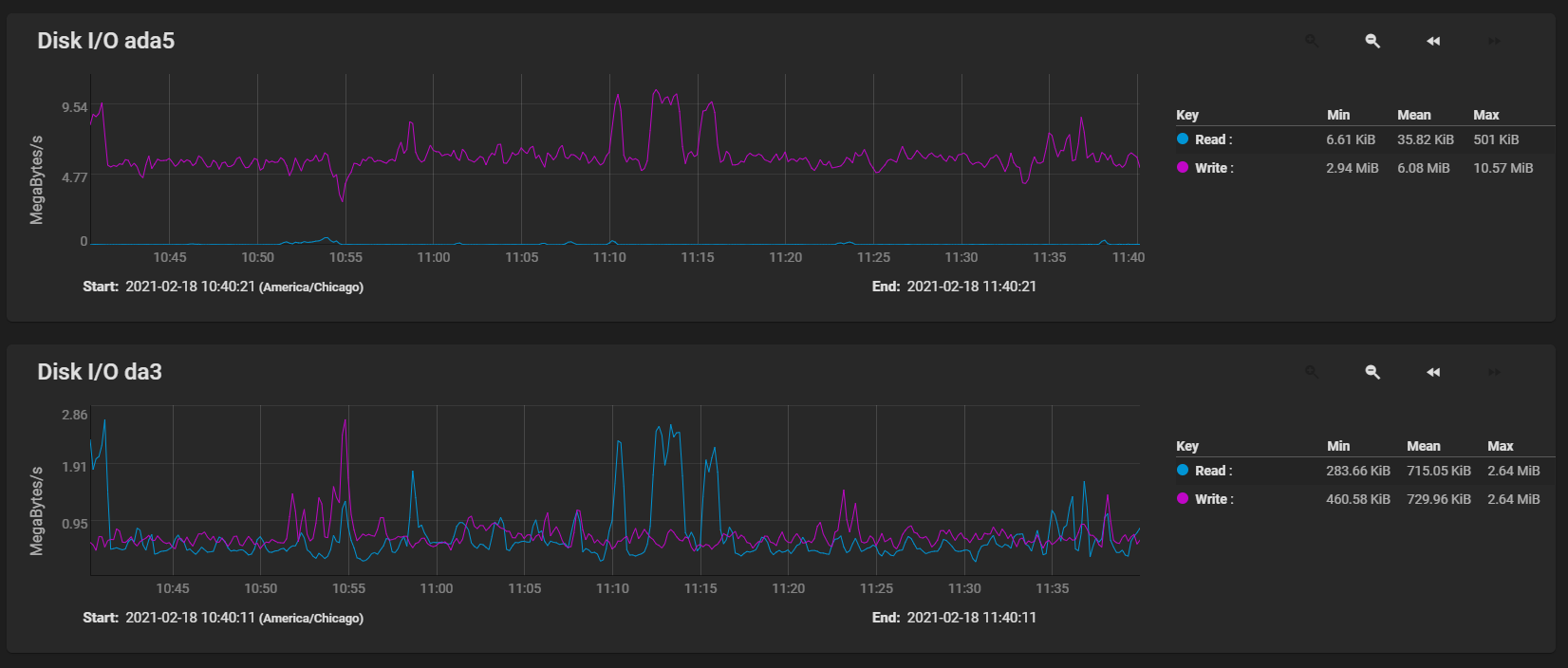

I took the 4 SSD ZILs out of the vdev for the 8TB spinning disks and made them their own separate pool to be used as the boot drives for the VM's OS.
Migrating an OSSIM VM that is about 500GB and this is the speeds. Still not wrapping my brain around where the bottleneck is...
ada5 is an SSD, da3 is a spinning.

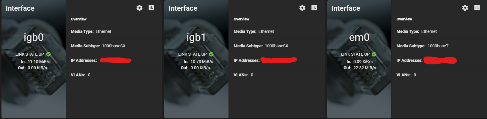

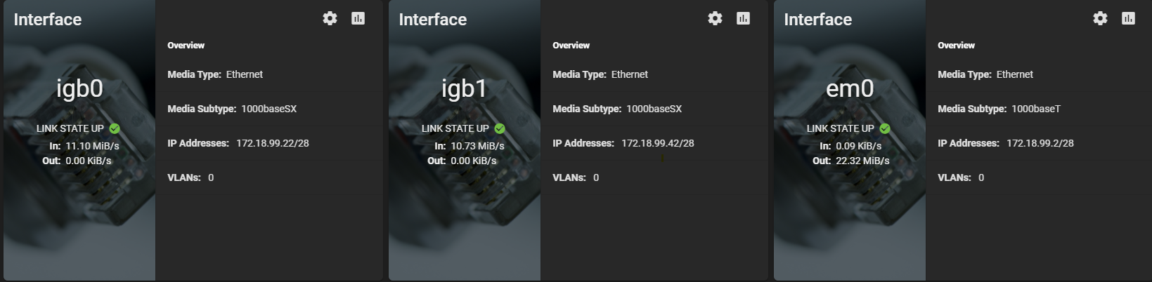

I have three NICs,
Address for GUI access
192.168.22.2/28 em0
Addresses for the NFS storage:
192.168.22.22/28 igb0
192.168.22.42/28 igb1
ESXi Servers: 192.168.20.0/24 network
192.168.20.10 (contains VMs)
192.168.20.11 (contains VMs
192.168.20.12 (vsphere only hosted on this)
Went into vSphere, mounted 2 new datastores.
Datastore 1: Type: NFS 4.1 Folder: datasheet from Pool-01 Servers: using both .22 and .42 as the servers
Datastore 2: Type: NFS 4.1 Folder: datasheet from Pool-02 Servers: using both .22 and .42 as the servers
Started a VM migration of a VM disk only.
I noticed that traffic was leaving and entering on all three NICs (shown here)
In an attempt to fix this, I set static routes in TrueNAS for each NIC to see if I could force specific traffic over the specified NICs
Destination:______Gateway:
192.168.20.0/24 192.168.22.22
192.168.20.0/24 192.168.22.42
192.168.25.0/24 192.168.22.2 (192.168.25.0/24 is my subnet for workstations)
Ran a VM migration and traffic still moving across all three NICS. I then deleted said routes from TrueNAS and set the same static routes on the router. Traffic still routing across all three NICs. Traffic still routed accross all three NICs. I then wondered if I was just doing some terrible networking and decided to run one NFS share on igb0 and the other NFS share on igb1
Traffic still routing on all three NICS.
Removed NFS share from igb1 and remounted it on igb0, ran VM migration, traffic now only on igb0 but speeds still 11-13MiB/s in both directions.
Did the same but now both NFS sharesare on igb1, ran VM migration, speeds still 11-13MiB/s in both directions.
One last time but now NFS shares are on em0. Speeds increased to 55-65MiB/s in both directions.
All this troubleshooting and pretty sure its just a bad dual port, SFP card. How frustrating.
