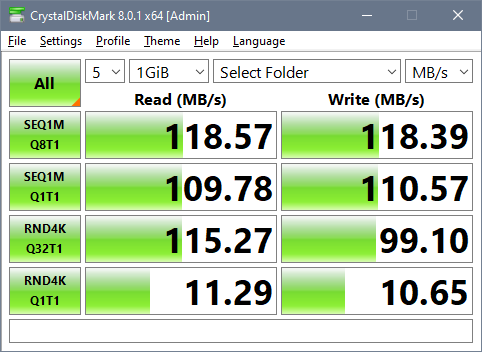

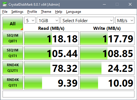

Here are the results from testing from my Windows PC (also using a gigabit NIC).
The RND4K Q32T1 (3rd row) write results are much lower than I'd expect them to be.
I also tested on an Ubuntu VM that was running on the same Proxmox host as the TrueNAS VM.
I used flexible I/O tester (fio) using the scripts found here.
I'm just pasting the rand read and rand write results below as sequential saturates the gigabit NICs just fine.
| Rand Read (MByte/s) | Rand Write (MByte/s) | |
| TrueNAS - NFS | 88.1 | 0.78 |
| TrueNAS - SMB | 62.8 | 32.2 |
Synology DiskStation
As a point of comparison, I conducted the same tests on my existing Synology NAS and the results were much higher:
And here are the fio results on the Synology.
| DiskStation - NFS | 107 | 90.6 |
| DiskStation - SMB | 114 | 83.8 |

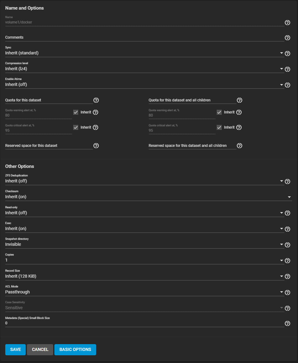

Questions/Troubleshooting
Is this kind of performance expected from TrueNAS?I'm hoping for closer to gigabit speeds on TrueNAS for random writes, because I want to use it as LanCache storage.
What kind of troubleshooting steps can I take to find the issue/bottleneck?
Any settings/configuration that may be causing this?
