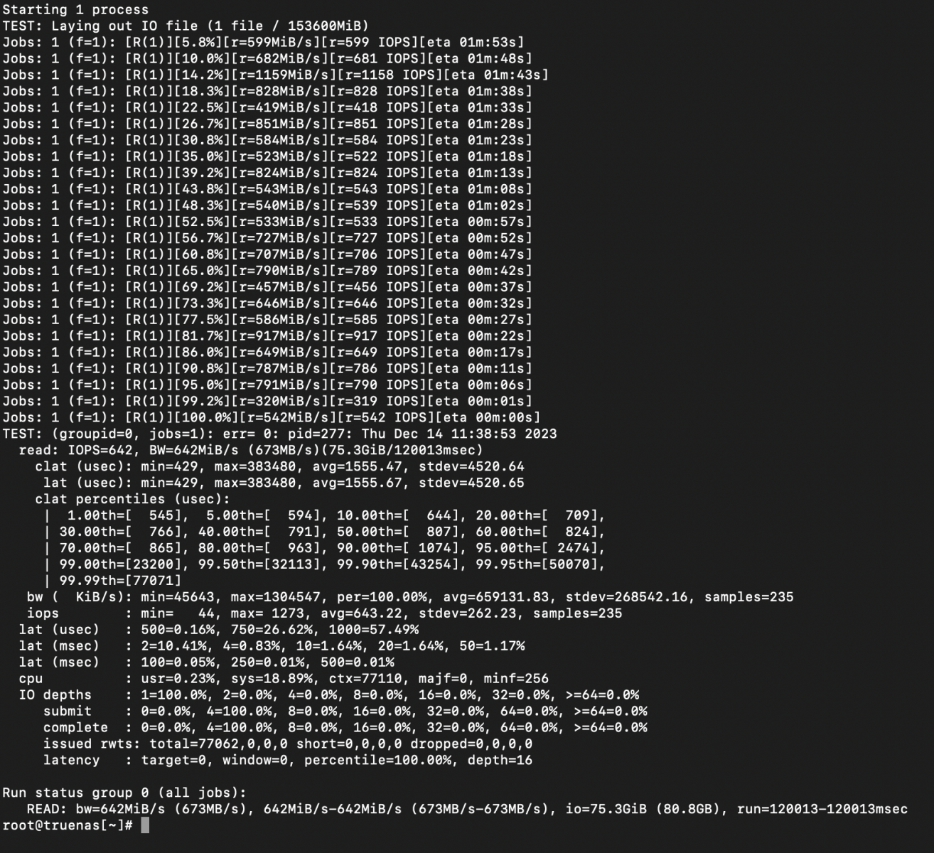

fio --name TEST --eta-newline=5s --filename=/mnt/bender/speedtest/tmp.dat --rw=read --size=150g --io_size=1500g --blocksize=1M --iodepth=16 --direct=1 --numjobs=1 --runtime=120 --group_reporting
Play with numjobs to see the impact of multi-user access (and caching).
Thanks, I've given that command a go:
I'm not great at interpreting this information but looks like 642mb/s is the speed outcome. If that's all on one VDEV then I think that is about expected?

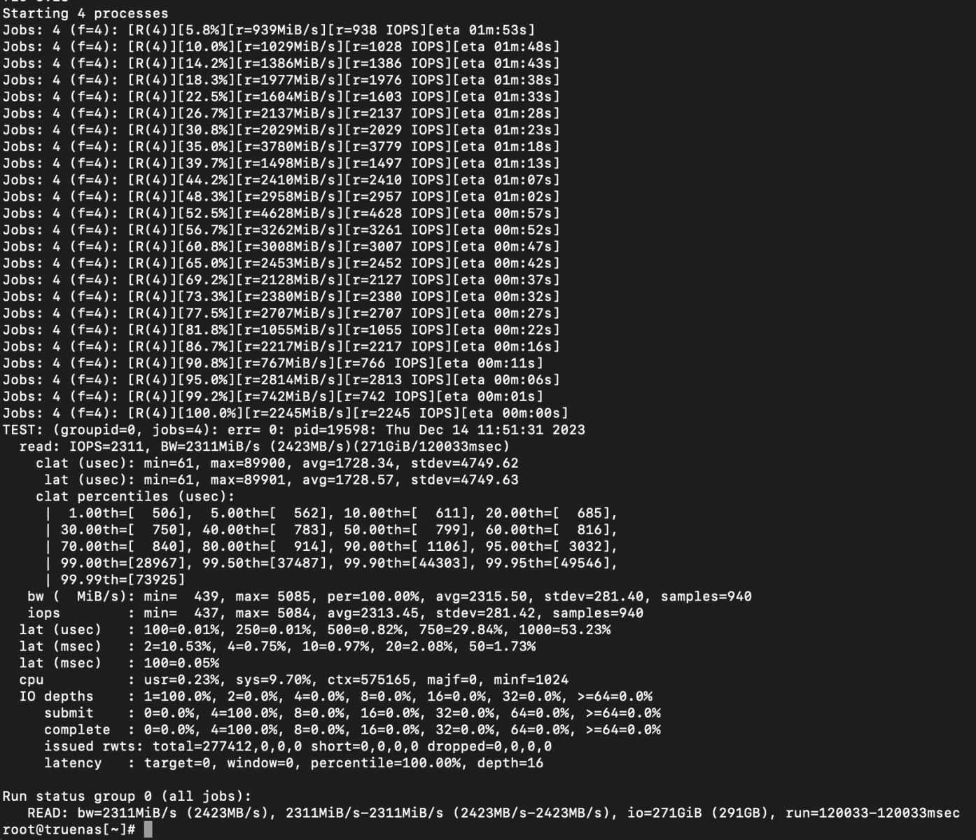

I ran it again with 4 jobs, I guess this is reflecting what 4 concurrent, non-overlapping reads would do?
Any help in interpreting these results is greatly appreciated!

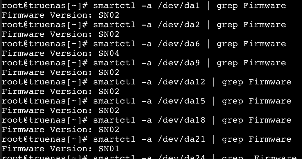

9,703
Unsure how to check firmware
smartctl -a /dev/da1 | grep Firmware

With a single job, you're seeing the best case for a single user of the system. As you saw, 600+ MB/sec is OK. You're probably getting a little under 200 from each VDEV.
Almost exactly the same story for IOPS, which as we know is limited to what one drive can do per VDEV, so pretty much spot on.
With more jobs, you get some idea of what might happen in terms of system performance with that many users, so you could expect concurrent use to push your network to that speed.

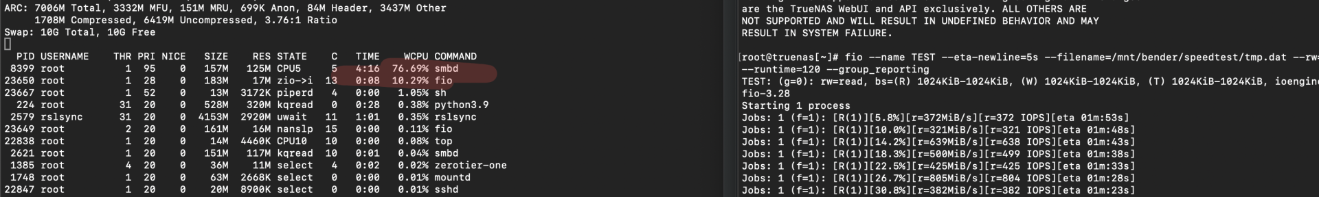

Have a second terminal open and check your top results on the VM. I expect you'll see very low overall usage even during a test; but 16 cores for a VM is a significant amount and you may be putting unnecessary pressure on the KVM thread scheduler underneath to keep things in sync, even with 32 cores on the host. Counter-intuitively, you may actually benefit from reducing core count if the host scheduler is able to concentrate the workload on a smaller number of physical cores and allow them to boost higher.
Did a few random drives, firmware is mostly SN02, but a few will be SN04 and SN01. No idea what that might imply for performance but I think based on the rest of your comment, by performance is doing just fine.

I did as you suggest @HoneyBadger and certainly the SMBD process seems to be using a lot of resources. Thought to be fair, I see smbd using about this much frequently even when not running test.

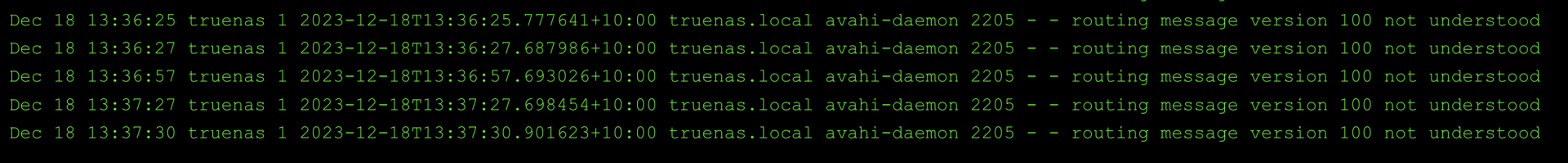

Not sure if it's related in any way, but I have just noticed these messages in the console. No idea how to interpret them, I'm happy to ignore them for now if they're unlikely to be impacting much
