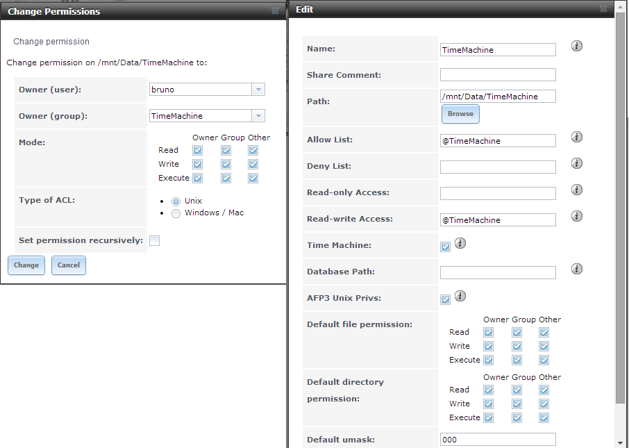

Hello Again.
Today the discussion is about the AFP sharing for TimeMachine usage.
I have created a separate sharing only for timemachine pourpose.
The setup is like this:
Freenas version: 9.2.1.5
user: bruno (member of TimeMachine)
group: @TimeMachine
Here is my problem:
When I create or stop and start the AFP service, my Hackintosh find the TimeMachine share and works ok.
But for the recurrent timemachine backups, usually the computer cannot login. If you try do force a backup like twice, it then finds and go on with the backup.
This also happen with my genuine MacBook.
In the log file, I cannot see the error on afp, because it seems that the computer when tries to connect, it usually do not reach the freenas (otherwise it should appear the loggins msg rigth?).
have anybody experienced something about that?
