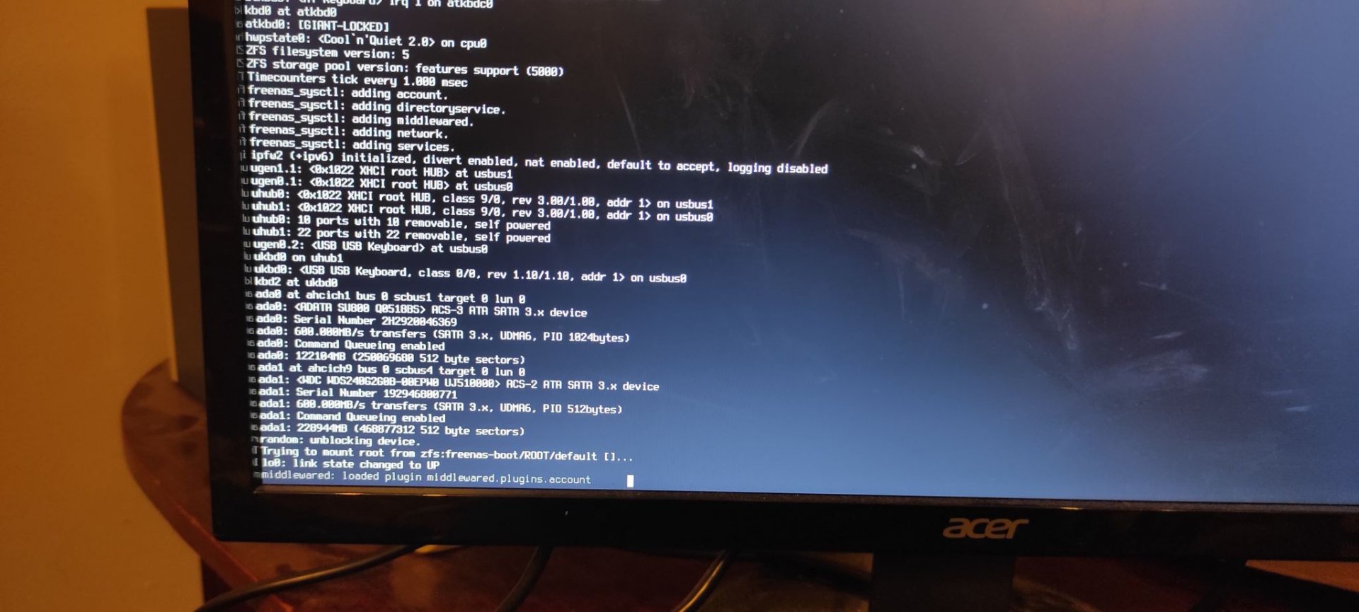

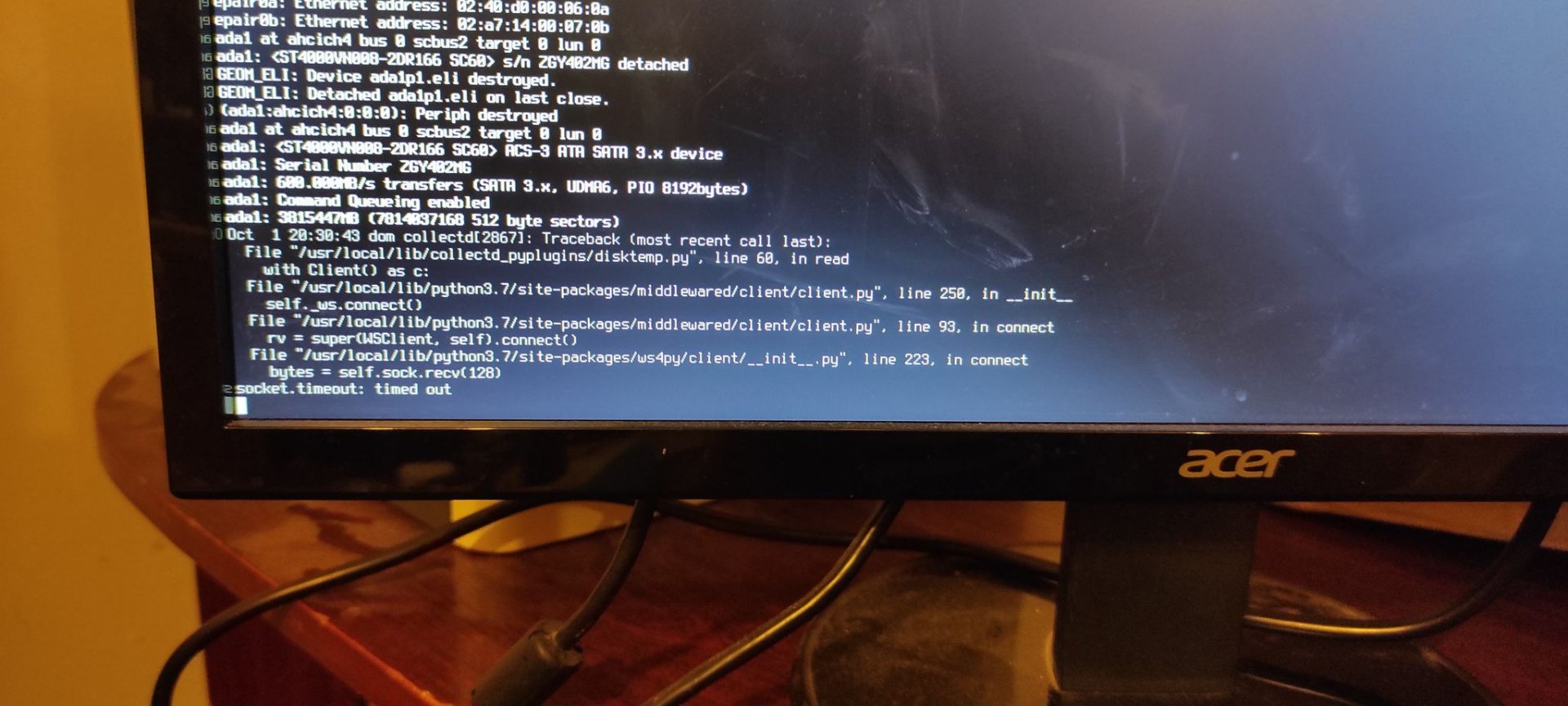

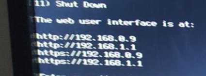

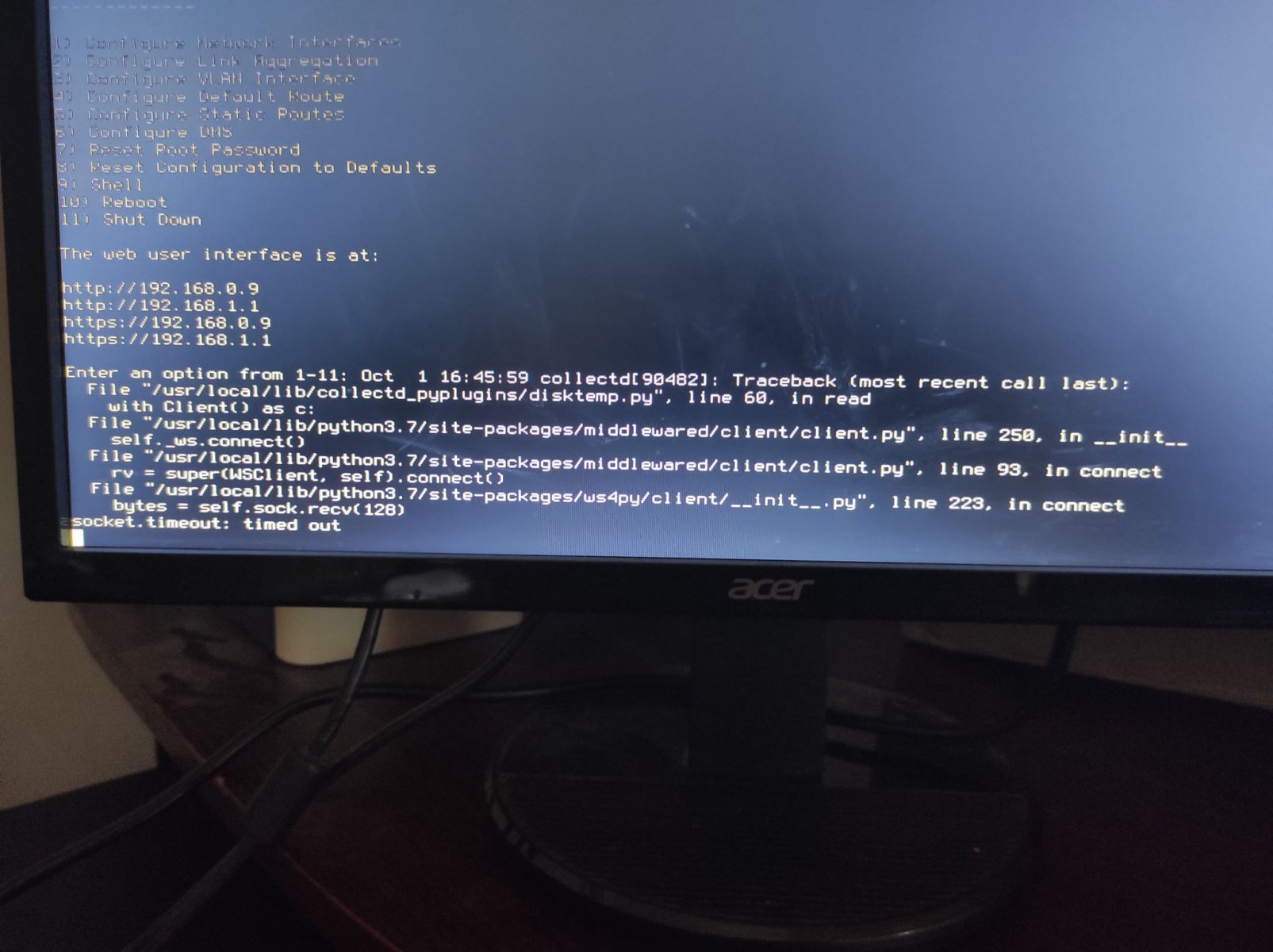

I have a problem with freenas. It won't start. Crashes some bugs. I formatted the system and now it won't move. This is not the first time he does this. Pictures in the attachment. Please help. All my debts are currently lying. Nothing can be used. Help!

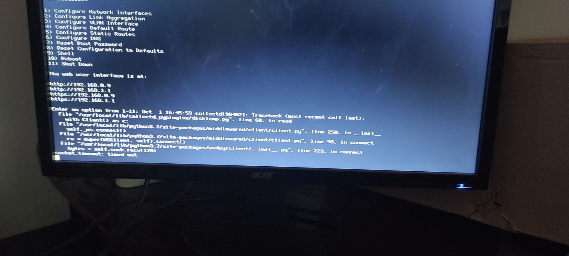

What is on the console screen when you reboot?
adam23450
Feb 19, 2020
142

So not the screen that shows the IP addresses of the GUI (and the 1-11 list of options)?
adam23450
Feb 19, 2020
142

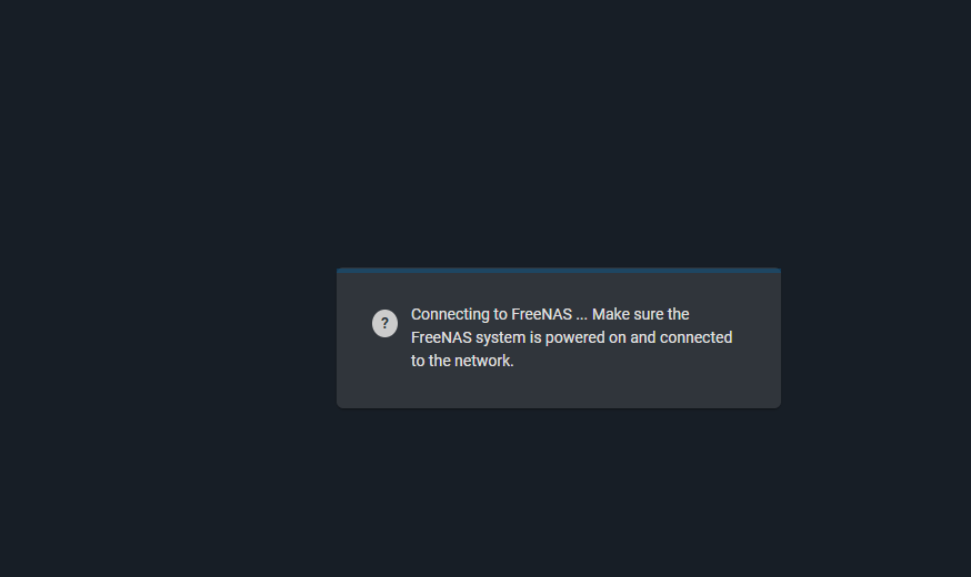

When I enter the address 192.168.0.9 it shows that freenas does not answer

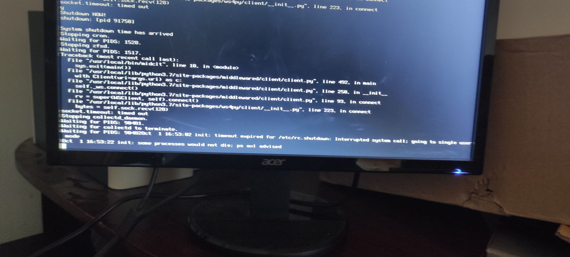

When we post here on the forum I am restoring my freenas services. I reinstalled the system and there is an error again (photo). This time I imported my disks. It was good so far. Then I created the virtual machine it was fine. I started the Prison with nextcloud it was fine and after chiwli everything fell out.
Redcoat
Feb 18, 2014
2,922
So you started a Nextcloud jail and it was fine, then you did something else and the system was not fine. What was the "something else"? Says "chiwli" here and that doesn't mean anything to me.

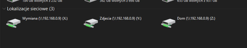

When the system was fine before you set up the Nextcloud jail, could you access your mapped drives from your Windows client machine?
Yes

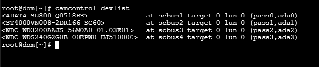

What does camcontrol devlist give you?
adam23450
Feb 19, 2020
142
this :)
