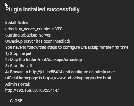

I have installed urbackup on TrueNAS 13.0-U2
I get an installation successful message, then some instructions
I then follow these instructions. But I cannot get to the admin page via IP:PORT
I even try to go to shell and start HTTP server manually:
I do see this on bottom of the TrueNAS GUI when I restart, does this have anything to do with why I can't connect to the urbackup GUI?

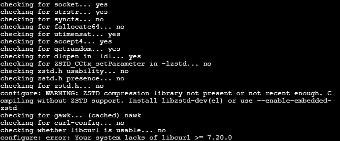

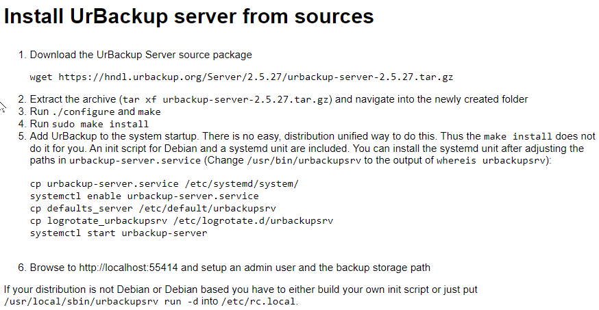

Hi, thanks for the reply. I have created the jail.
(I am not too good at command line installations)
Inside the jail shell:
I've gotten as far as ./configure:
3. Run ./configure and make (as I am fuzzy on what to do with MAKE and the rest)
Alecmascot
Mar 18, 2014
1,177
ok.
Best to use Putty for the command line stuff.
Start from scratch:
Create the urbackup jail:
    iocage create -n urbackup ip4_addr="vnet0|10.10.0.39/24" defaultrouter="10.10.0.1" vnet="on" boot="on" -r 13.1-RELEASE -b
Go to the jail console:
    iocage console (name of jail)
Install needed packages: (respond "y" if prompted)
    pkg install -y nano curl wget
download Urbackup Source into the jail:
    wget https://hndl.urbackup.org/Server/2.5.27/urbackup-server-2.5.27.tar.gz
Extract the archive:
    tar xf urbackup-server-2.5.27.tar.gz
Navigate into the newly created folder:
    cd *.27
Then :
    ./configure --enable-embedded-cryptopp
Then :
    make -j4
Then:
    make install
To test do:
    urbackupsrv run -u root
Browse to:
    "jail IP":55414
Back in the jail stop urbackupsrv:
    ctrl-c
To make urbackup run at jail boot :
    nano /etc/rc.local
and add to the new file :
    #!/bin/sh
    /usr/local/bin/urbackupsrv run -d -g 104857600 -u root
To end and save :
    crtl-x
    y
    enter
To make it executable :
    chmod +x /etc/rc.local
"exit" to leave the jail
"iocage restart (jail name)"  to restart the jail then check you can browse to port 55414 as before
Then back to the TrueNAS gui to setup the mountpoint for the backup data (with the jail stopped) and back into Urbackup to make the settings you need.

Install needed packages: (respond "y" if prompted) pkg install -y nano curl wget
Then I receive this error in Putty
Where am I going wrong
Thanks in advance

HI Alecmascot
I got it working i did say i wasn't good at command line stupid me.
When you ask network setup I didn't realize that i had to change the ip address. I thought i would do it at the end. OH Der :rolleyes::rolleyes::rolleyes:
Your a legend :smile:
Thanks for your help
