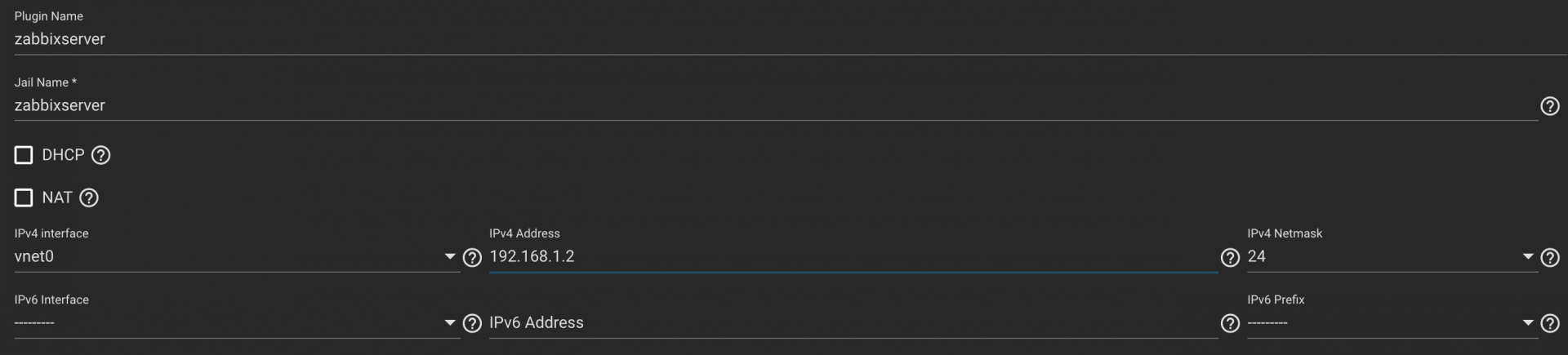

During installation, you specify an IP address.
After installation, the plugin should be available by IP address.
Example: https://192.168.1.2:30001

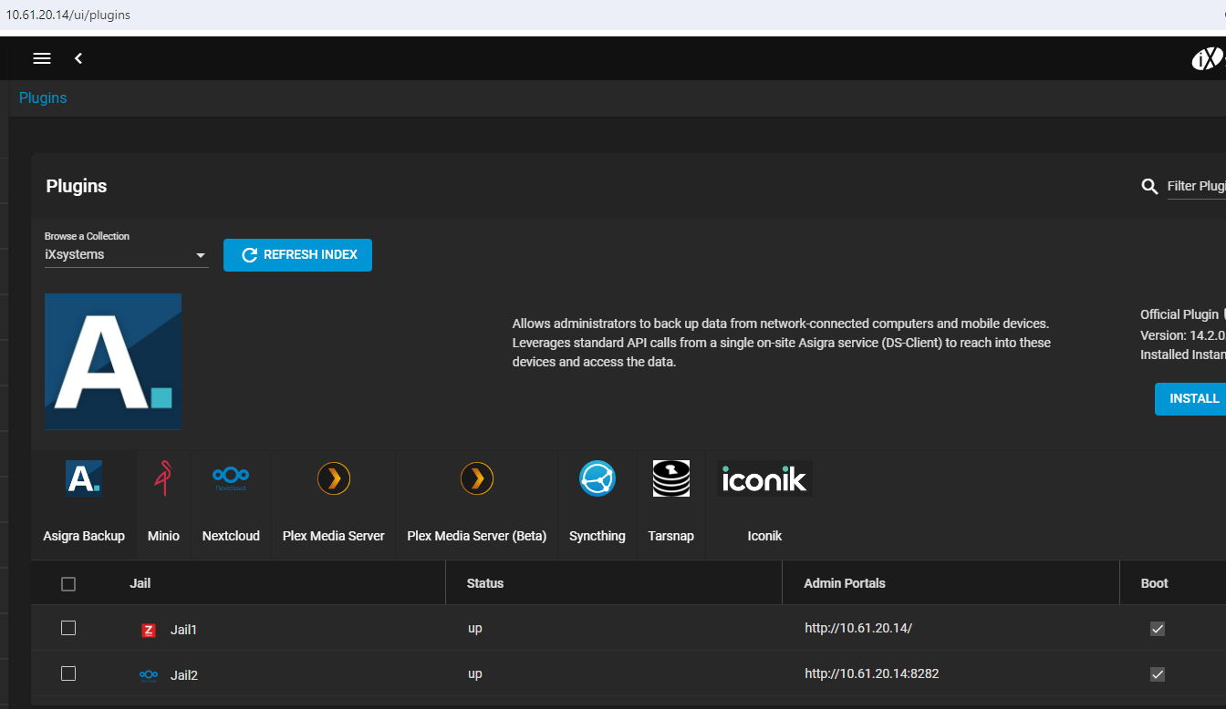

I am facing the sames issue: installed the Zabbix Server Community Plugin and now I cannot access the web UI.
The reason is that Zabbix installation did not create a separate port to listen to and now it is trying to use the same IP & normal http(s) port which is already being used by Truenas Core itself.
I installed the Nextcloud plugin to test and that installation created another port and I can access nextcloud with the IP and port.
I tried to look around if I could create a rule from Truenas network settings but did not find a place where the nextcloud port would have been configured. Should I do something in the Zabbix jail console?
