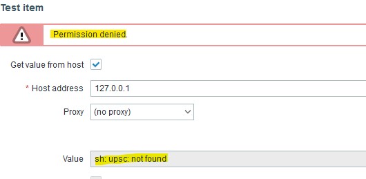

But if I try to create an item in my zabbix server that issues the same command, as follows
The result i get is “Permission Denied” and “sh: upsc: not found”
I have already enabled remote command in Zabbix agent by adding the line
AllowKey=system.run[*]
to the file “/usr/local/etc/zabbix6/zabbix_agentd.conf”.
It seems as if root has access to the “upsc” command but the user “zabbix” (running the zabbix server and agent) does not.
Can anybody help me with this?

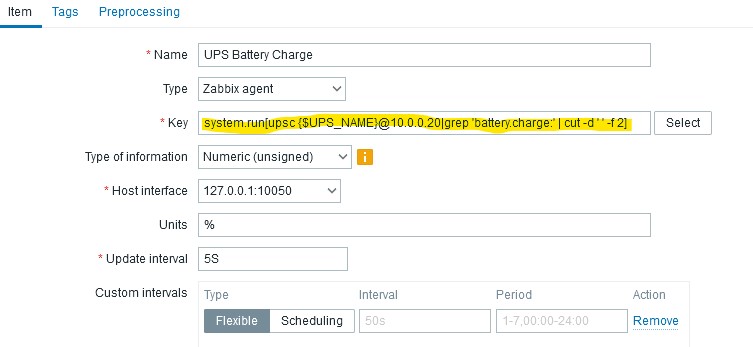

I figured it out.
Zabbix was complaining that it couldn't find the command "upsc". so i indicated the full path of it.
Therefore, the solution for the "UPS Battery Charge" is to change the "key" from
system.run[upsc {$UPS_NAME}@10.0.0.20|grep 'battery.charge:' | cut -d ' ' -f 2]
to
system.run[/usr/local/bin/upsc {$UPS_NAME}@10.0.0.20|grep 'battery.charge:' | cut -d ' ' -f 2]

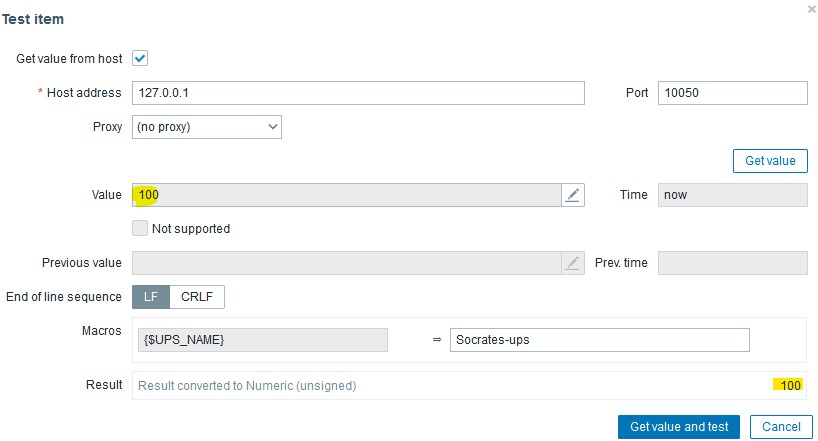

now, when i run that key i get the following
this is correct because the battery is 100% charged.
I hope my waste of time can help somebody else down the line.
