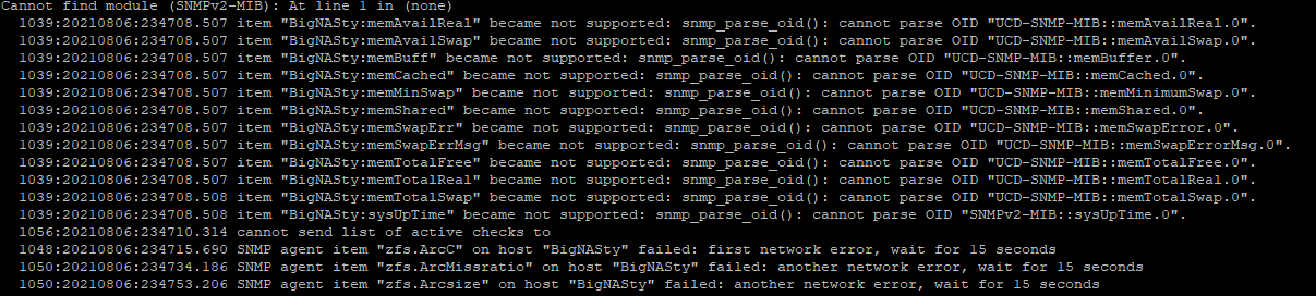

Hi. I have a problem with the discovery of network interfaces and processors. With the network interfaces it says "snmp_parse_oid(): cannot parse OID "IF-MIB::ifDescr"" and with processors it says "snmp_parse_oid(): cannot parse OID "HOST-RESOURCES-MIB::hrPeocessorLoad"". What did I miss?
Thanks in advance.
Thanks in advance.
I'm also having the same issue and can't figure out what is wrong.

fmontebaur
Apr 21, 2022
Managed to get it working in Zabbix 6.0
but all the Memory Item give me Errors like:
snmp_parse_oid(): cannot parse OID "UCD-SNMP-MIB::memAvailReal.0".
Did I have to install or copy some MIBs?
Or is it more like an error in the Template for Zabbix?
