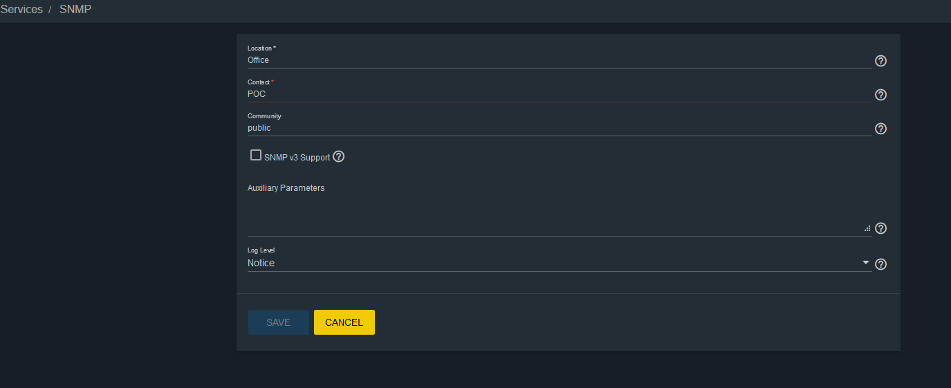

what i need to configure in the snmp to make it work?

Just comunity and receiving host ip.
Im using netxms, it works fine. Also you can forward also syslog.

can you help me with the params to configure
l@e
Nov 4, 2013
143
sorry just the community name to match the one you have on zabbix, and one of log levels.
if you want snmp v3 that is more secure you can check that but you have to have it enabled in zabbix also.
if you are same net you can use the default V1/2C.
also you hvae to add the node on zabbix server.
log levels you can try which one is better for your use type.

to match zabbix? i did not configure anything in zabbix snmp, i already integrated 30+ servers and 4 switches, and in all of them i just turn snmp on, did not require any configuration.
turns out that just turning the service on is enough.

Yes, it is zabbix in this case that is called polling node, and sends queries to specified nodes you add there. Or if you have all of them in the same subnet you may have configured the full network space to autodiscover. Anyway autodiscover is more intensive on resources and if you have many hosts is not recommended, but for small nets is ok.
The only thing you have to match is the comunity name for v1/2c snmp and for v3 aslo login.
