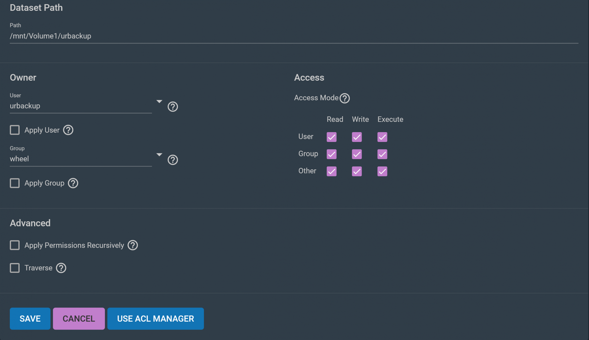

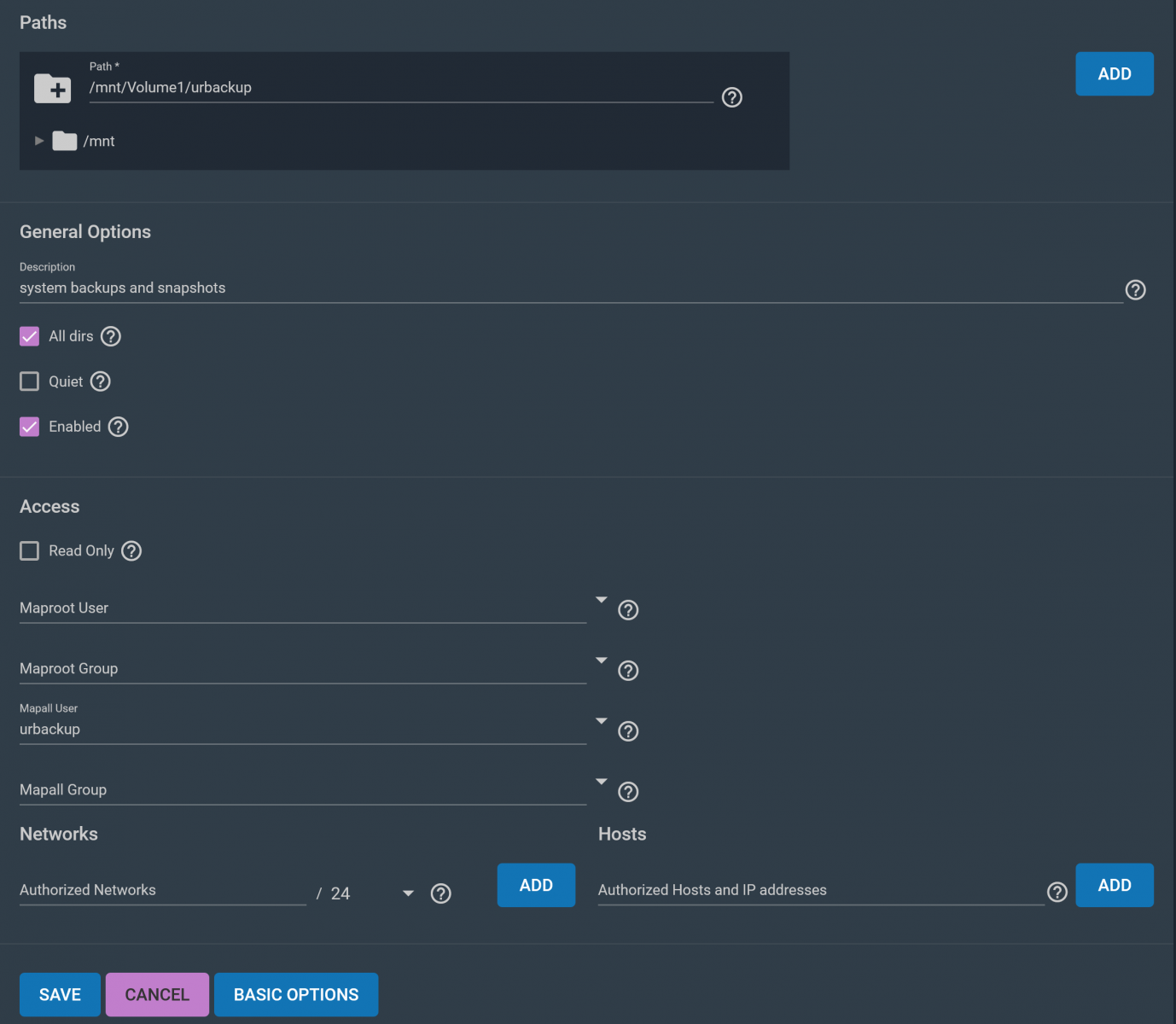

I also tried using an NFS share instead. I created the dataset /mnt/Volume1/urbackup and I setup the NFS Share:
This is the TrueNAS permissions of the /mnt/Volume1/urbackup dataset:
