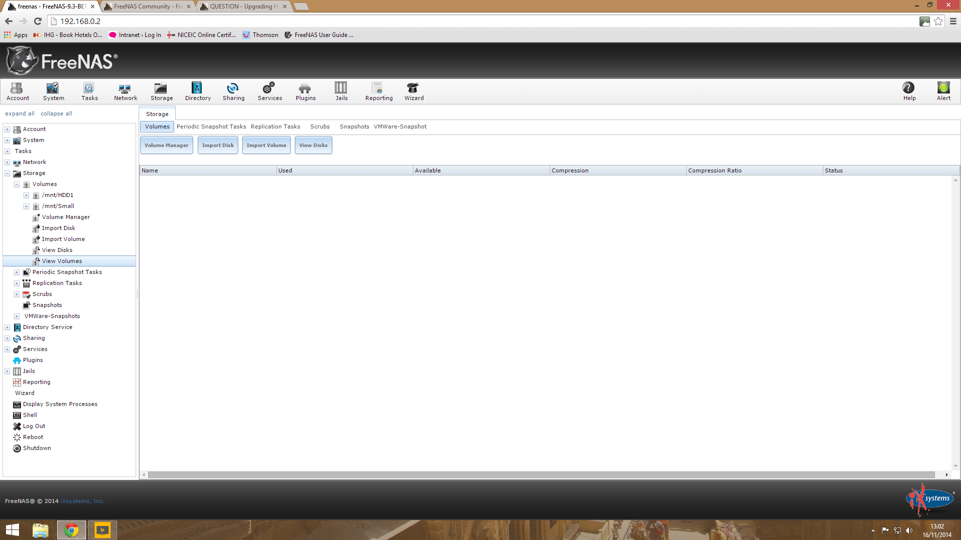

When I look at the GUI and view volumes I dont see any listed. See screenshot below -

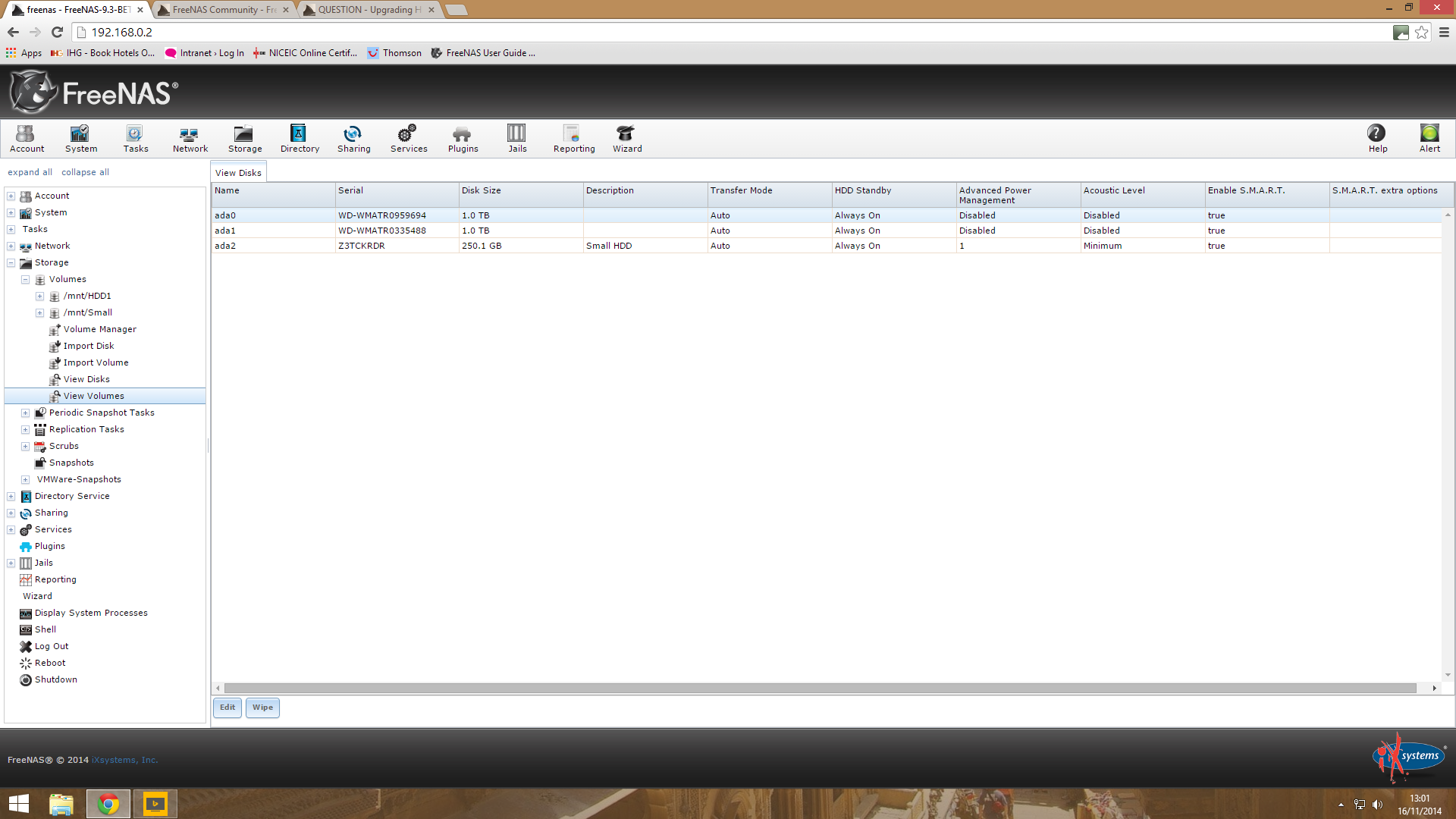

Also when looking at the View Disk section as you mention I can only see the below when clicking on a drive. I have 2 x 1TB drives that are mirroed.

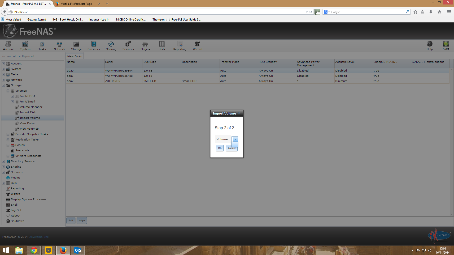

Wow, that is odd. Out of curiosity, try to Import Volume.

I have just tried to import via Shell and got this -
[root@freenas ~]# zpool import HDD1
cannot import 'HDD1': a pool with that name is already created/imported, and no additional pools with that name were found
Using the GUI I can't see the Volume (HDD1) that I want to import -

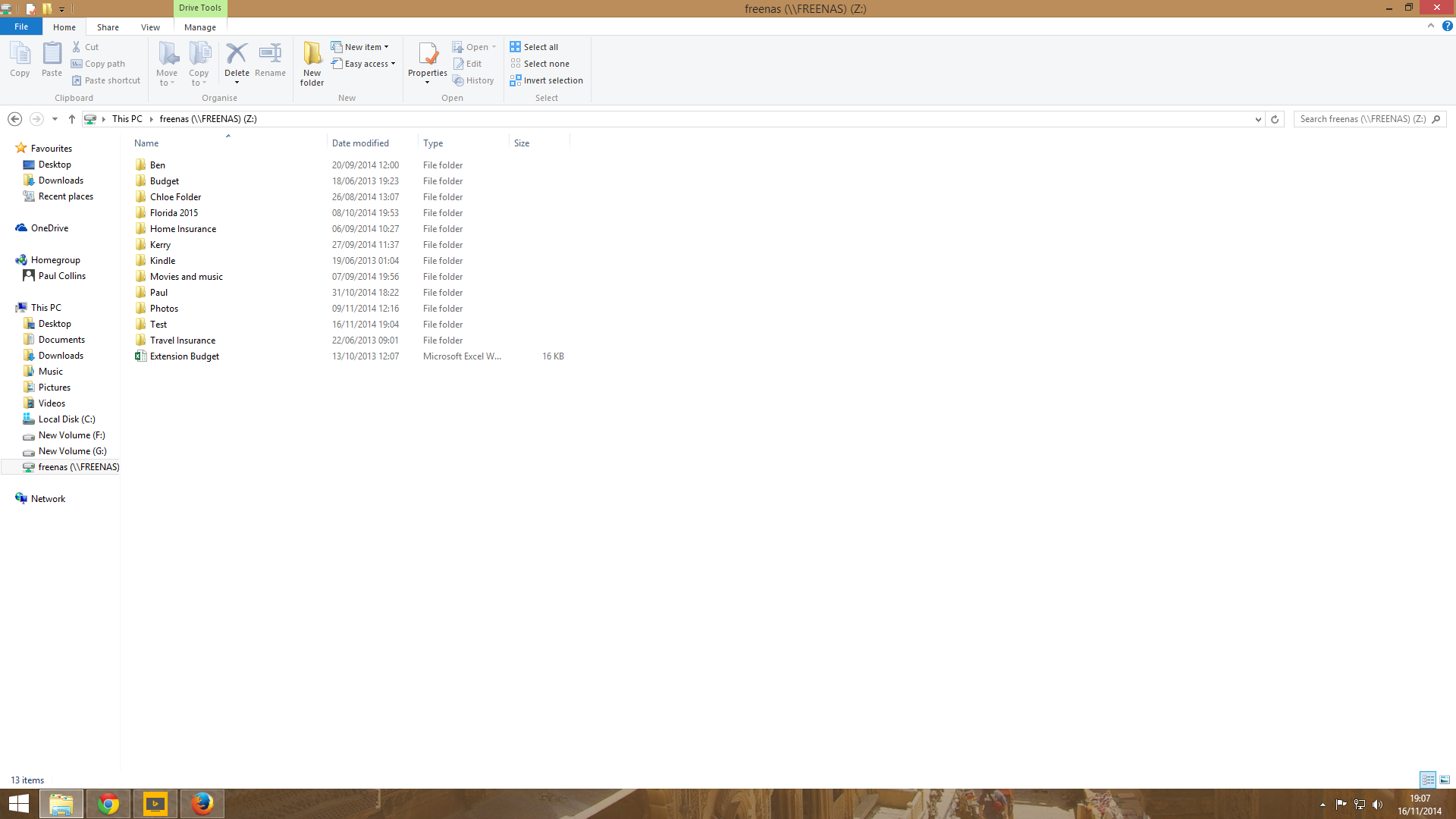

I can access the files on HDD1 from my PC without any problems at all - so it seems everything is working, but I can't see the Volume in the GUI :-(

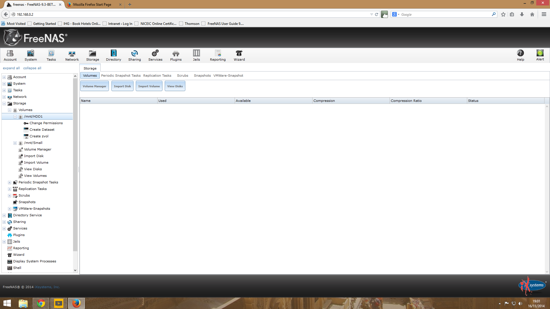

See that +/mnt/HDD1 in the GUI under storage. What does it show when you expand it? Will it allow you to add a dataset? If we add one, I'm wondering if the display will sync up, or what error gets thrown. And what shows when you click storage up in the top menu. Just the blank list? Have you cleared the cache on the browser, tried chrome, or anything else on the display side?

It shows the following -
I moved from Chrome to Firefox today as I was reading that Firefox is better for Freenas/Shell. I have also plugged a USB keyboard into my HP Proliant as well as a screen and I can run use the same as what the Shell is telling me from the Shell box in the GUI.

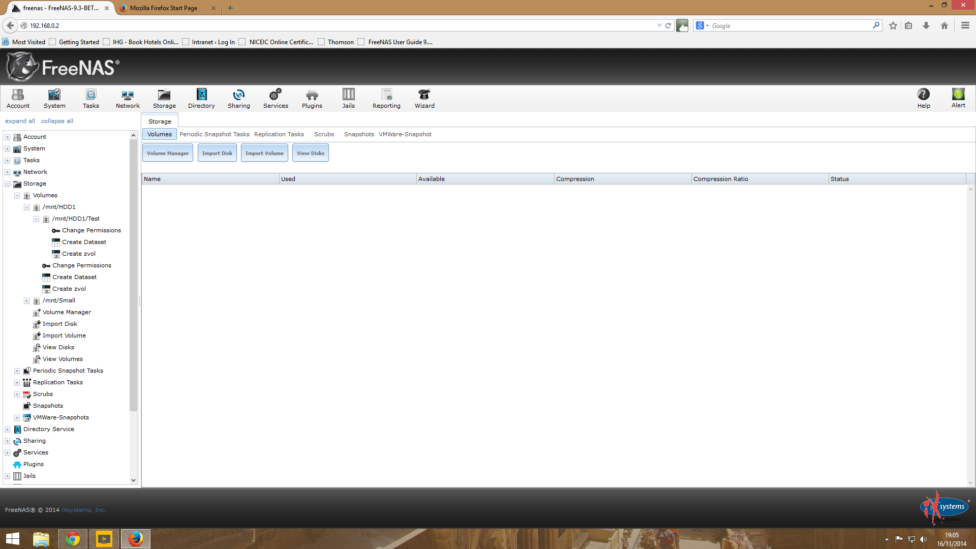

I have added a dataset called TEST -
I can see the new dataset from my PC -
