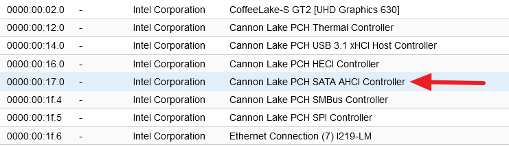

Lucas Rey
Jul 25, 2011
180
Is this the right controller to pass to TrueNAS?
