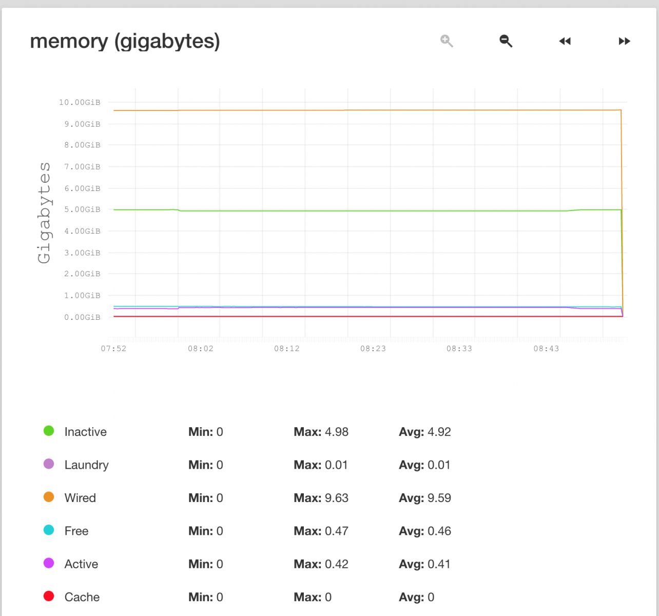

Could you please guide my into the right direction to find out where my slow connectivity is coming from?
My main Freenas NIC has a gigabit capable interface
The switch is a gigabit switch, and the 1000MB indicator light blinks on the cable to my laptop as well as on the cable going to Freenas.
Iperf Freenas to Laptop
iperf laptop to freenas
System stats:
CPU usage is about 6%,
RAM is also okay i think
OS Version:
FreeNAS-11.2-U5
(Build Date: Jun 24, 2019 18:41)
Processor:
Intel(R) Core(TM) i5-4670 CPU @ 3.40GHz (4 cores)
Memory:
16 GiB
Write tests on the machine itself (to test the pool) seem okay
However, when using FTP or any other fileshare protocol I get terrible speeds (Below 1MBps)
Any ideas?

System stats:
OS Version:
FreeNAS-11.2-U5
Processor:
Memory:
16 GiB
