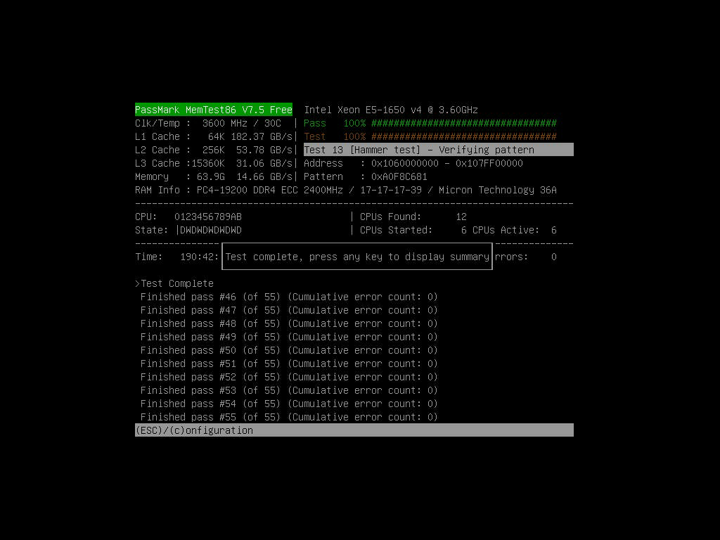

Update to my project.
Returned to original drive back to store and the second WD Recertified drive replacement passed the SMART and badblocks tests with no errors.
The last memory test which was as long as the first one went thru with out a hitch. Also CPU stress test showed that my cooling is more than adequate even for heavier jobs if needed (planning on installing BOINC to crunch some numbers during idle time)
Now the next step is planning data migration from the old server and I have a question about that.
What would be the most efficient way to migrate and verify with checksums my data over a home 1 GB LAN? I have been thinking FTP, basic ssh session transfer, rsync...
