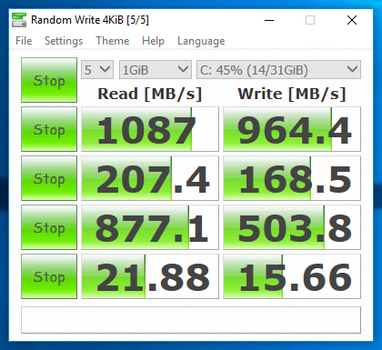

I purchased the XS716T. Its nice :)
Been able to verify that I can use iperf to slam half a dozen gigabit clients at full speed.. simultaneously... from a single 10gbe uplink to the switch.
Also been able to verify that my little pilot XeonD system can push 20gbps or so, using vmxnet internal networking, and that I can get 9.9gbps back and forth between two freenas instances over 10gbe. Bidirectionally. Ie full duplex out one 10gbe port to the switch and back in the other port.
The vmxnet only does 10gbps bidirectionally.
That's just the iperf testing at this stage.
I've also done some testing already in the vmware environment, and using iSCSI and internal VMWare networking I'm getting about a GB/s read/write from the VMs to the 6way RaidZ2 pool... utilising the P3700 as SLOG, forcing sync. It peaks at 1.2GB/s write, and up to about 1750MB/s read.
I now need to renovate a bunch of runs so I can run 10gbe at full speed over that.
We throw video content around... which is why I focus on sequential performance mostly.
