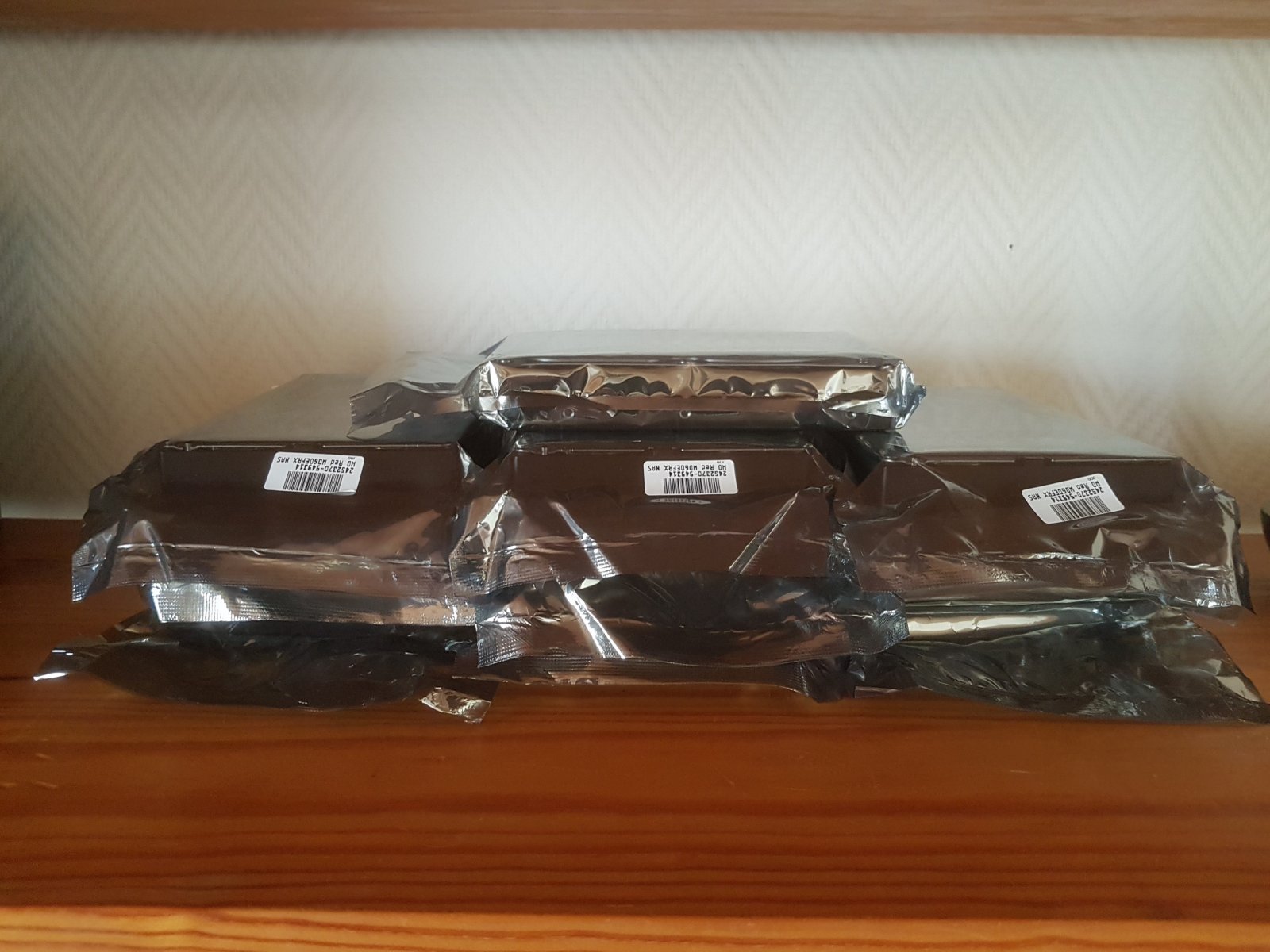

Ok, got all of the components last week actually quite smoothly in the span of few days and here are the before pictures
Hardware
10 HDDs
So here we go, diving into the deep end... :)

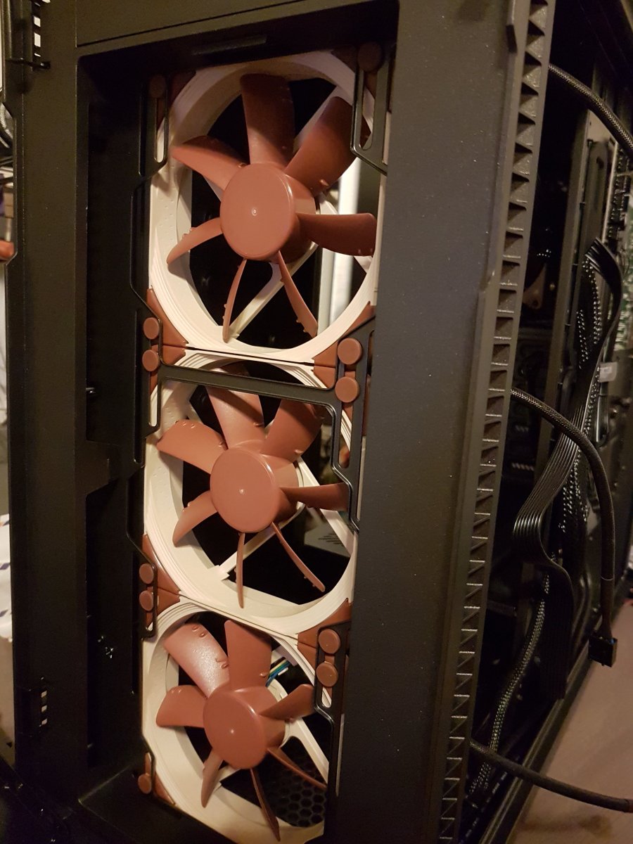

Ok, first small update:
May I present: The Wall of Cool. Those Noctua fans fit very snugly with the rubber corners and anti vibration attachment thingies...

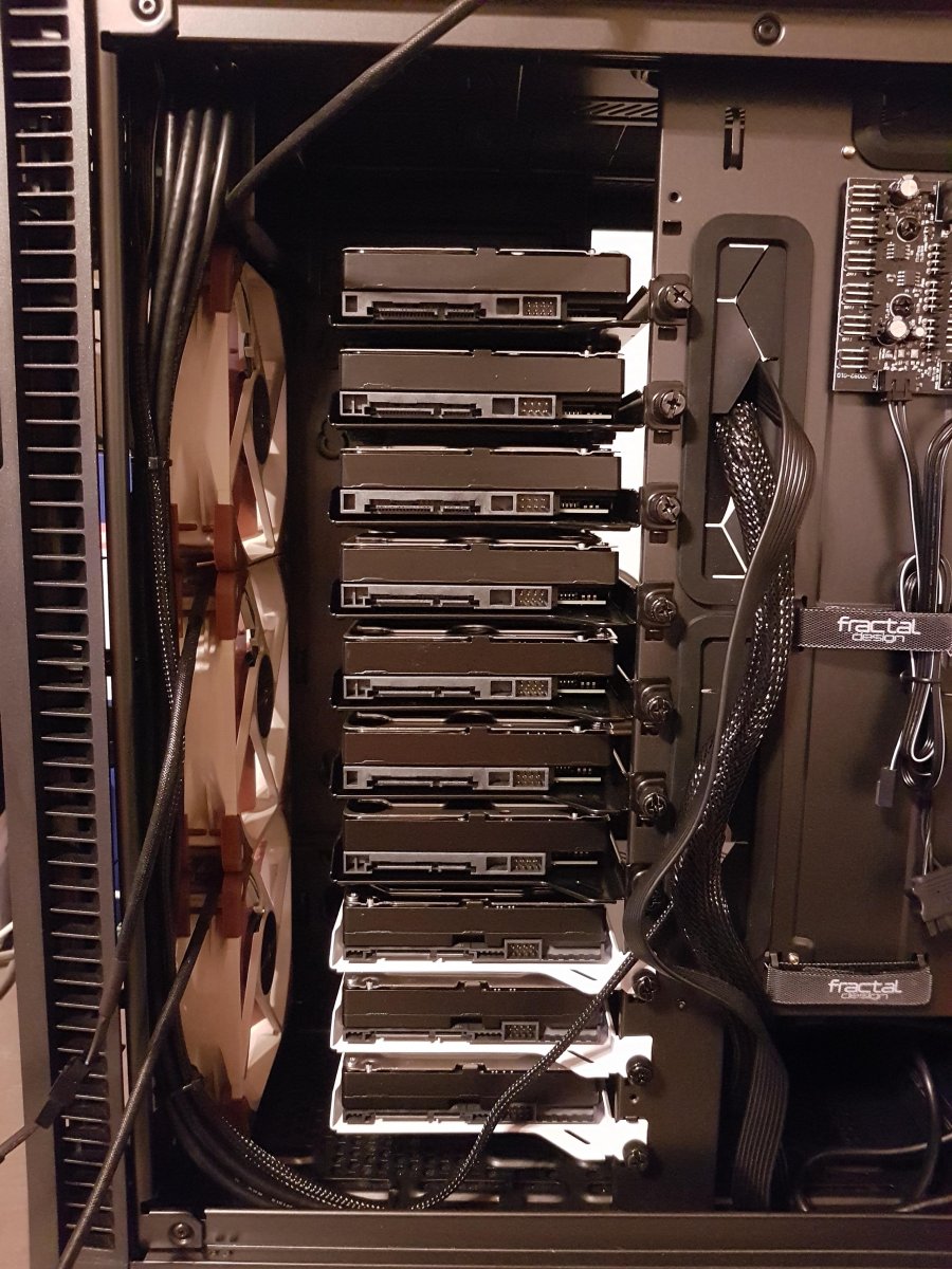

Behind the wall is of course the Column of Data. Blacks are 4 TB and whites are 6 TB. Two of these, top and bottom, will be my cold spares but now they are all in for burn-in testing. Then the drives will be covered very well by the cooling fans (even with those they are already)

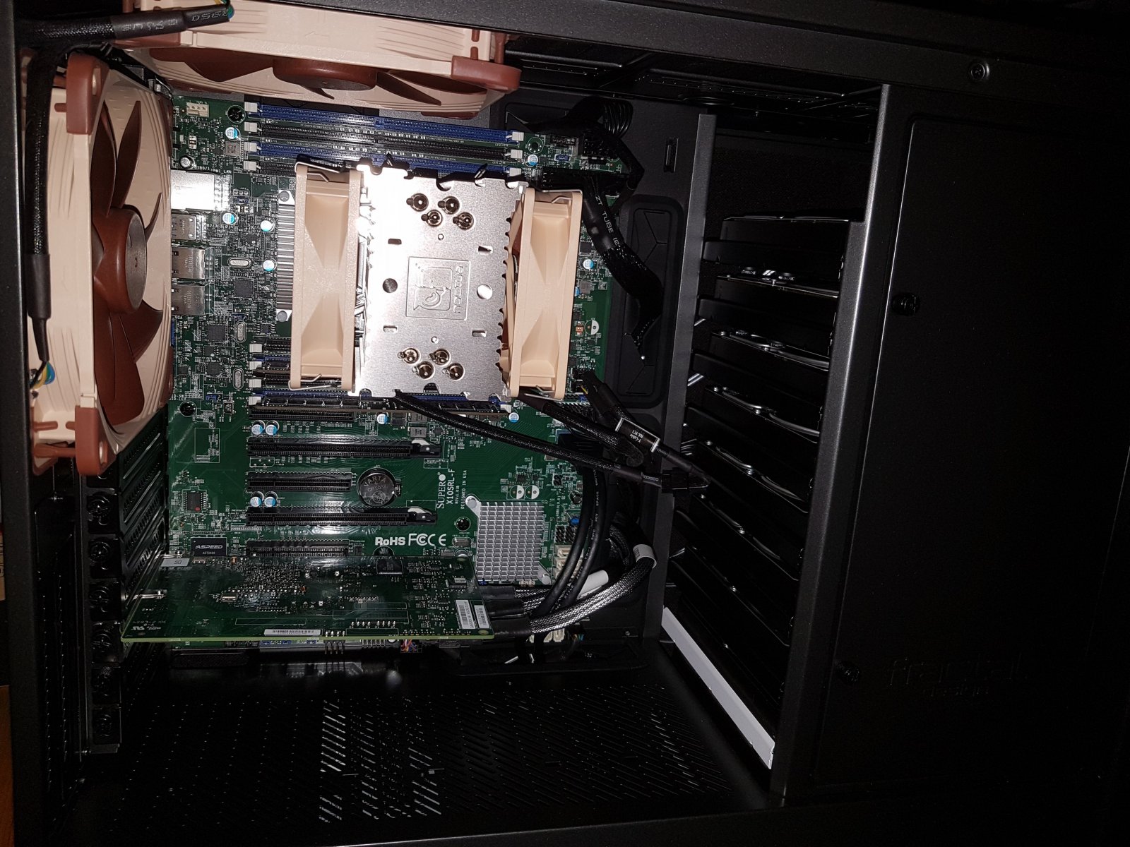

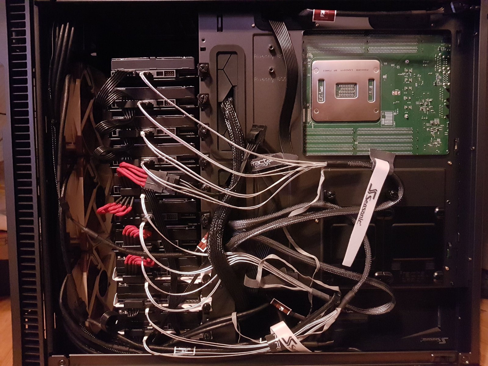

Second update
Cabling is done but the SAS cables that I had are too long as they were intended for another larger case. But still quite neat... I ordered shorter ones to suite this case. I also labelled the drives for easier recognition later...
Inside on the other side, CPU cooler, 140 mm Noctua fans, SATADOMs and LSI HBA card ready to go...

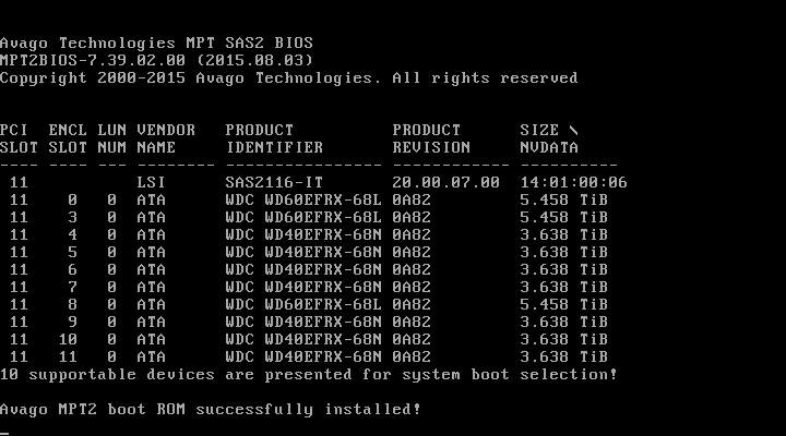

Glad to say, the assembly passed the smoke test with flying colors and everything was detected by BIOS and HBA card. Also IPMI is running now so management is easier compared to monitor and dedicated keyboard...
What I noticed though is that the HBA card reports the sizes of the HDDs as 0 TB. But the card is old (2013 or something) and the next thing on the list is to update the firmware and BIOS.
Was it P20 that is currently the one to use with FreeNAS?
To be continued...
What card did you end up using in the build?
How the drives are reported would be influenced by what firmware is installed and if the card had some saved configuration if it was previously used.
And that is why I am updating the firmware and BIOS next. I bought this card in 2013 and it hasn't been used at all after that as plans and priorities changed. The FW version is at the moment 5.00.13.00-IT so quite ancient...
The card is LSI SAS9201-16i HBA.

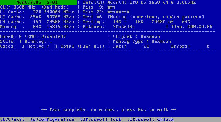

Third update
Memory test with Memtest86+ is done without errors
Also after updating HBA all of the HDDs are detected correctly
Next is CPU stress test and about that I have a question.
I have not yet installed FreeNAS and as the purpose of the test is to monitor the temps of different components I would like to record the history or high/low values of the test to see the effect of cooling strategies
So can I do that with FreeNAS UI because IPMI does show only current temps?
