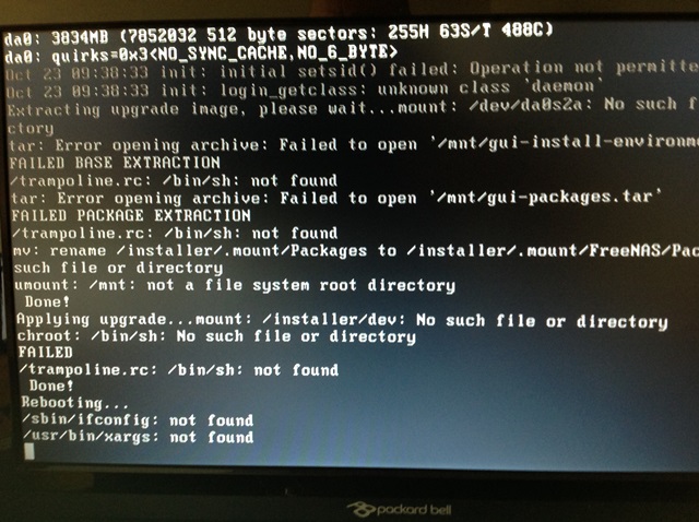

Hi many thanks for getting back, as I say I'm very new to freenas so please bare with me,
I'm updating through the GUI on 9.3 alpha, I down load the .txz file to one of my other machines then go to the GUI and click the firmware update button, select the device memory for short term storage and then select the .txz file from downloads.
paste in the sha key. It unpacks the firmware, after approximately 15 minutes it reboots, during this it reaches a point where the last line is a message" usbus1: Controller shutdown complete " and loops back to the beginning of the boot process and continues to do this.
When I then try to boot back to the original 9.3 os I can't get the os to accept F2, it keeps coming back with "no F2" . I can see F1, F2 and F5 on the usb drive
Also for some reason I've never been successful with the iso update process either.
please let me know if I've left out any information you need,

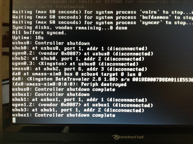

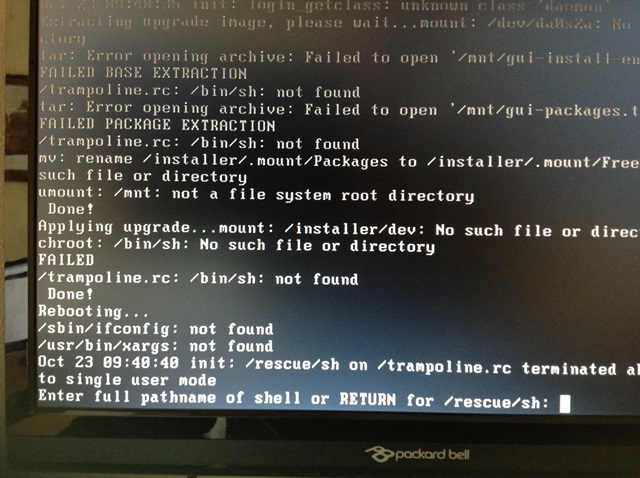

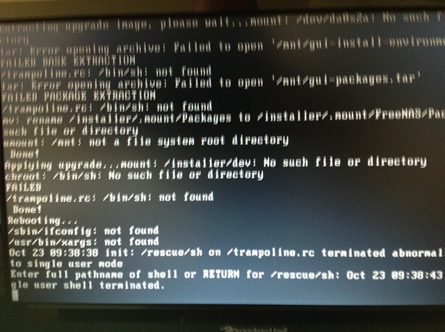

The images below are in sequence starting from 9.3 alpha through to loop.
